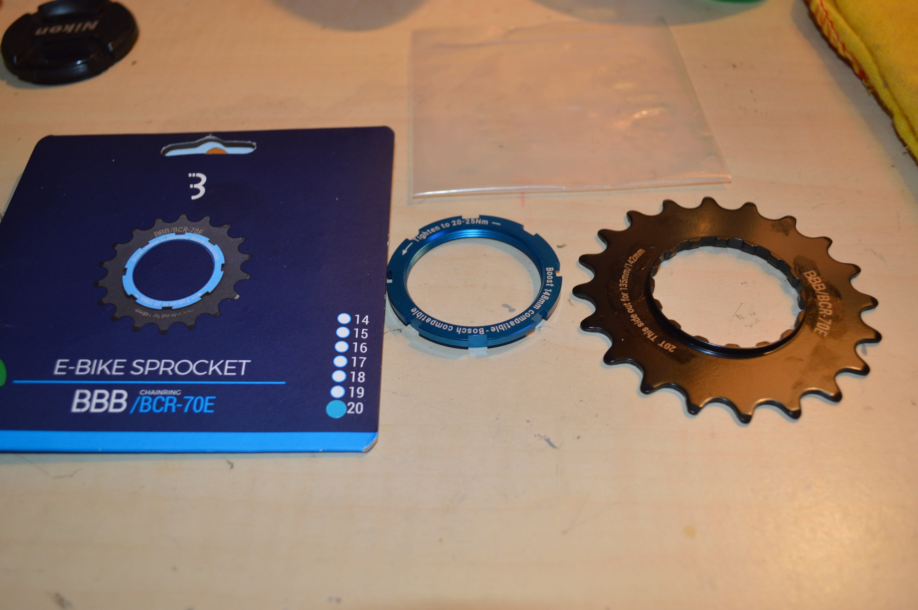

Don't worry about your climbing speed being too high because it won't make you climb any faster. The 20T front will give you in effect a 50T front chainring, so think about any really steep hills you need to tackle on your lowest gear of 50x34 which even with the motor might be a tad high for very steep inclines.

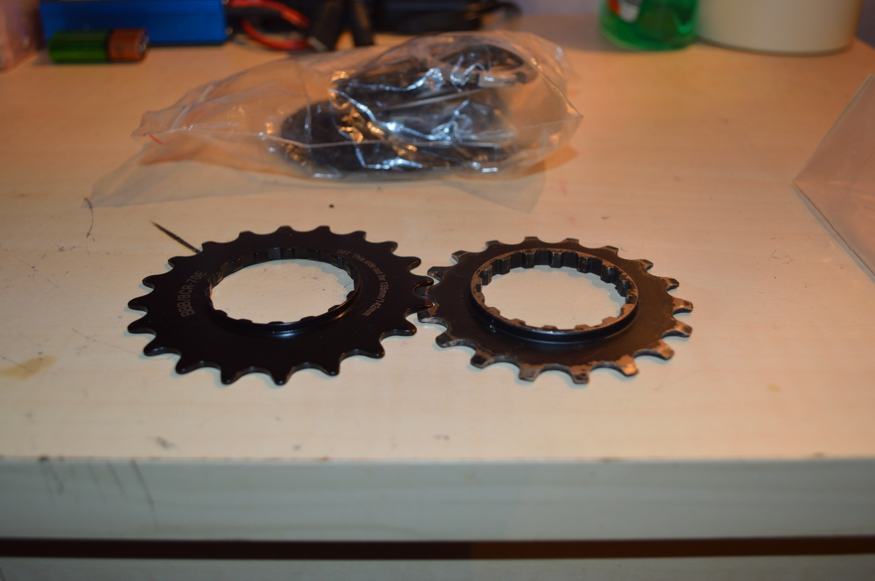

I have an 18T front cog on a CX motor with an 11-36 cassette on a 29er wheel. That will spin comfortably to 50kph with reasonable cadence. I also climb a 10% hill without needing the lowest 2 gears. The bike is just about usable with no power on the flat or on a gentle incline, not up steep hills but the CX is pants with no assist anyway.
The CX has a 1 to 2.5 gearing ratio (I think) so going from 15 to 18T is an actual equivalent 7.5 tooth difference.
Thanks Deno. Yes, its a 2.5 multiplier so 18T will equate to a 45 chainring, which will be more comparable to my non-assisted bike, if I use the middle to small sprockets. The larger sprockets will be useful reserve for more severe inclines as I get older! I'm not sure of the length of my current chain which is mfrs original equipment: do you reckon I would need a longer chain for 3 extra teeth?
I didn't lengthen the chain but I think that the chain was too long originally. It works out as per the following calculator actually:
http://www.machinehead-software.co.uk/bike/chain_length/chainlengthcalc.html
Its much better with the 18T. I would possibly consider going for a 19T as I am predominantly on the small cogs on my commute, thereby wearing out the cassette, but I am worried about climbing ability. Also I have started towing a child trailer so I may leave it as is now.
Yes, I think I will stick at 18T, as I don't want to run into problems with possible fouling of the cover/chainguard. Still want to retain them, as its additional protection around the crank area. Call it bearing paranoia. Thanks for the link.
