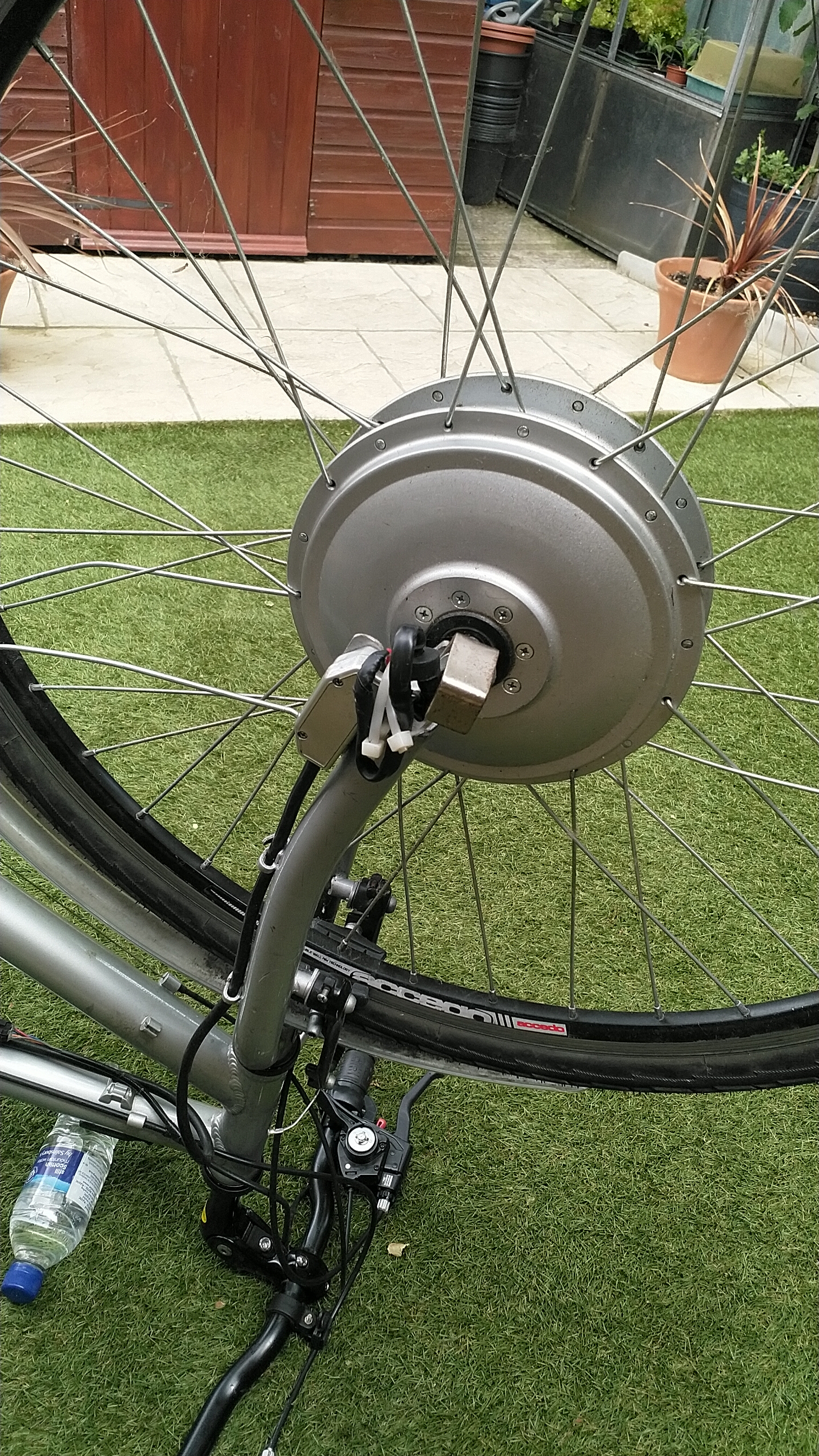

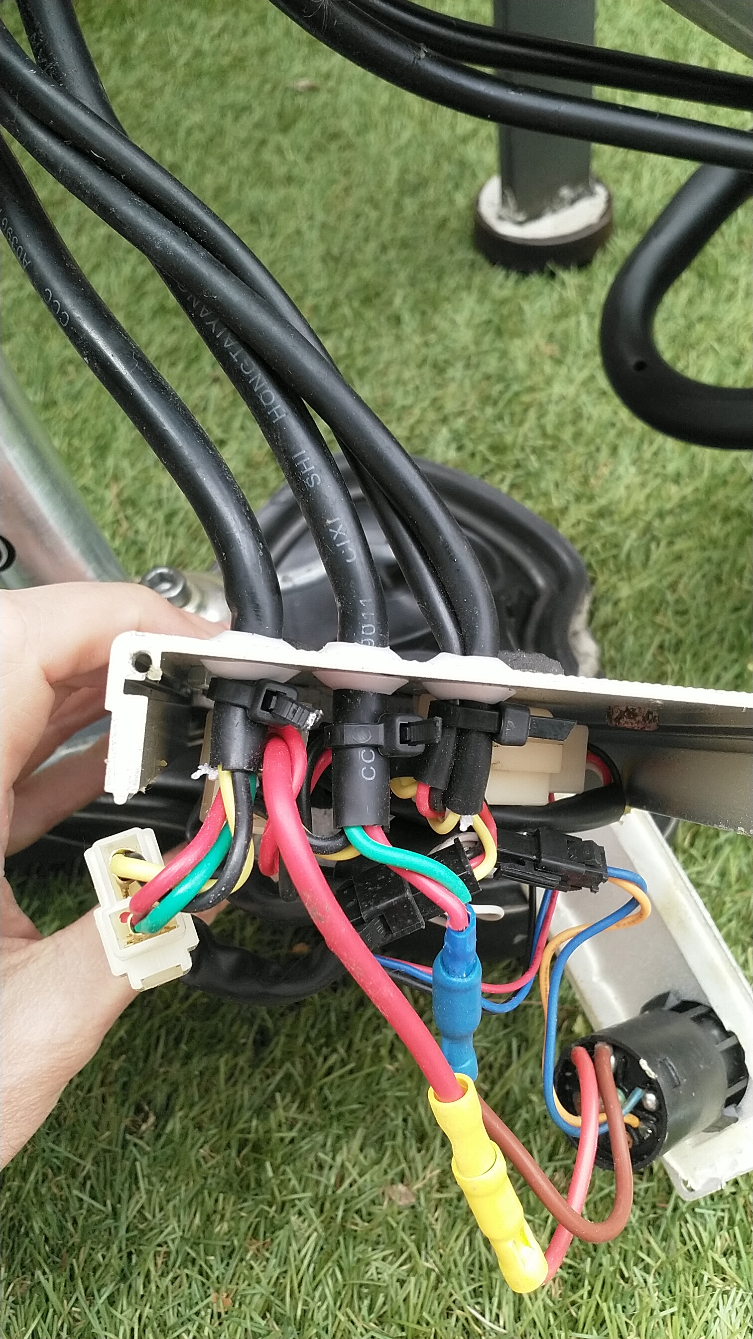

So here are some pics
Thanks to all the advice so far.

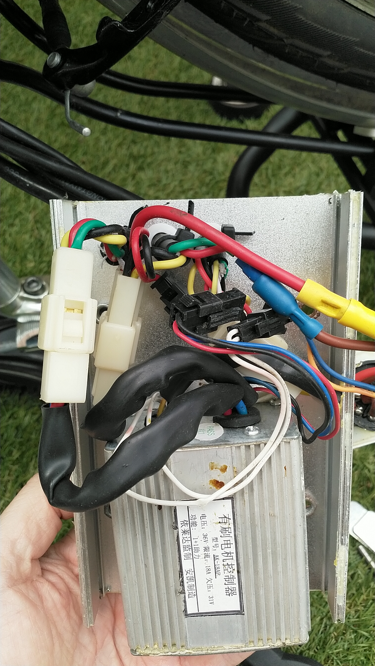

I am sure that controller says something really useful in Chinese but I am a bit rusty with my mandarin currently.
Just to add it looks to have a peddle sensor and a throttle. So I am guessing they make up wires 3 and 4
So it's starting to feel very brushed.
Well the bike and wiring all looks to be in very good condition, much better than the bike I had to work on. Unfortunately, you do have a brushed motor, but not the end of the world. Your main problem is having a battery to test the bike with, do you have a charger with the bike? have you tried charging the battery?

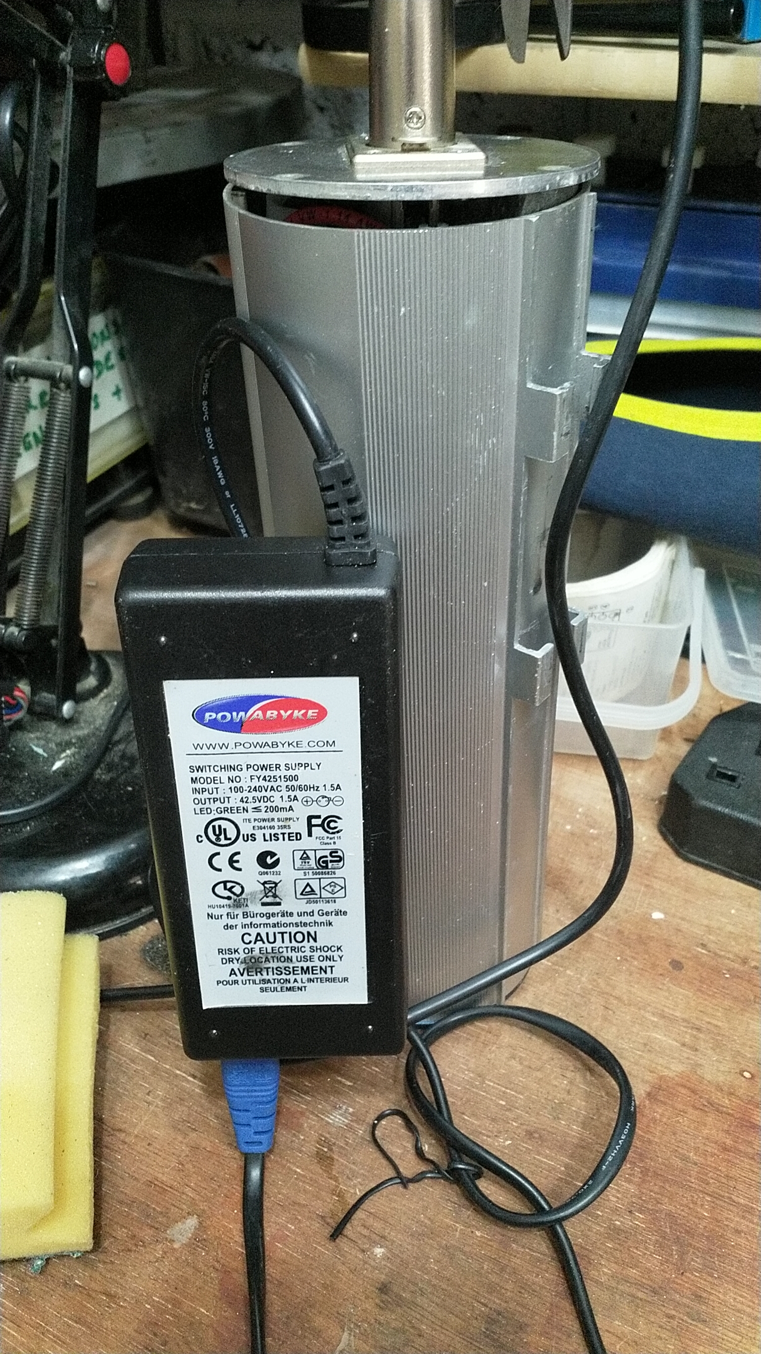

Yes I have a charger but the it just shows green and nothing much happens.
After a few hours of charge I tested the battery and it showed about 15 volts but then just seemed to go down in the space of about 1 minute
That's a shame, sounds like the cells have died, prob. from lack of use/charging looking at the condition of the bike. Give us an idea of your expected use/mileage of the bike and we can advise on the size/capacity of the battery you need, assuming you can't beg/borrow one for testing.

I agree with "[mention=12956]wheeliepete[/mention]".
If a Li-ion battery is not regularly checked and charged, and the battery goes below the level that a regular charger is "allowed" to charge, this/sh*t happens.
If caught in the early stages, a good bike shop will have a so called "Zer0 volt Charger", that can MAYBE recover the battery, but going below the minimum charge level, ages the battery a lot (I am informed!). So it might be dead!
You might be lucky if you can find the special charger at a bike shop near you.
I myself only know of one company, this side of the Atlantic that sells such chargers, but ONLY for 36 volt Nominal batteries.....And yours sounds more like a 24 volt battery.....possibly!
Only you know!!!
By the way, the charger is prevented from charging at all, the LED stays green to inform you of that on most Li-ion chargers....

You can use any 36v battery with that bike as long as it can give 18 amps continuously. The controller will only work if you connect at least 31V to it. Even then, Powabykes often have weird controls, so you need to do a search for the handbook, which tells you how to get power out of it. You should be able to test it by connecting the charger directly to the battery wires as long as the motor is in the air and free to spin.
I got the motor spinning directly by wiring in a car battery to it, but thats about it.
I tried to use my 36V 15Ah battery off my Oxygen ebike but could get anything to work.
The throttle looks a bit ropey and the pedal sensors have come detached.
I am therefore left with a mesh of wiring of various colours that seems to have minimal logic to it
I thought about another controller but these are often undocumented junk from China from what I can see, but maybe at least I can wire things in from scratch.
What are your thoughts, if I do buy a new controller then how do I know which one to buy, volts, watts and I guess brushed!
I feel I am having a similar experience to wheeliepete.
I am definitely learning, even if it is not to ever buy an ebike blind off ebay.
Anyway thanks all for helping me today
I know some of the Powabyke throttles only work if you pedal first. Without the pedal sensor, you might be stuck. There are loads of brushed motor controllers on Ebay really cheap. You need one that can give around 18 to 20 amps. Unfortunately, they often list them as 350W, 500W or anything else, which gives you no idea of the current they allow. I've seen 14A ones listed as 500W. You have to look at the label to see the current. A normal brushed motor controller will work with a throttle like a motorbike.
