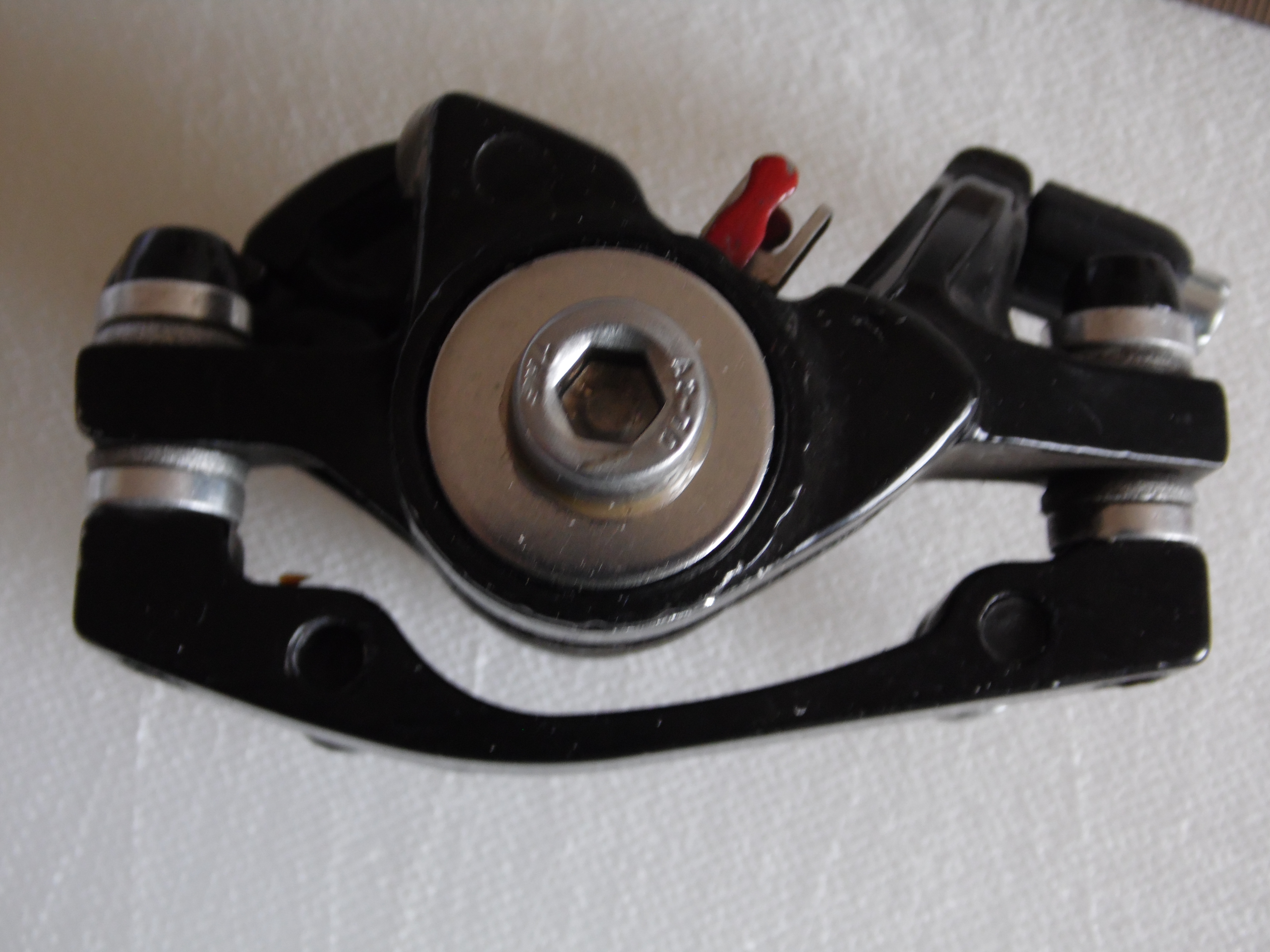

PS. I forgot to mention that I ride a fairly cheap bike and the disk brakes and calipers are definitely not of the highest quality or price. When the bike was delivered, either my bike or my mate's, one disk was reversed to the other!! The other bike had both disks (IMHO) reversed! Neither myself or my mate, and we both ride in the hills with the dogs, and it the town, have had no problems of squealing brakes. But I have had to repair the adjuster on the on the front brake, as it was plastic, as the Sun had got to it. As you can see here:-
I put some stainless steel parts together and replaced that plastic, and it now looks like this:-
Its hard to believe its the same brake and if anyone who has had the same problems, I have written an easy repair procedure that I can send anyone if required.
It really is simple, all you need are a few simple hand tools, and a stainless steel 8mm Allen screw, or a similar sized Torx screw, and a big SS washer and some 2 component glue!
[ATTACH=full]31748[/ATTACH]
[ATTACH=full]31749[/ATTACH]

It sounds as though one of the pads is touching the disc when the brakes are off, if the problem comes back it might be worthwhile using a feeler gauge to find out which pad is touching and then play around with the settings to centre the pads. I'm assuming they are mechanically operated.
Yes, it's certainly a good idea to keep the discs degreased.

According to my book of words on cycle maintenance Avid mechanical calipers have one moving piston and and adjustments on both pads. The gap between the disc and the fixed pad needs to be around twice that between the disc and the moving pad.
