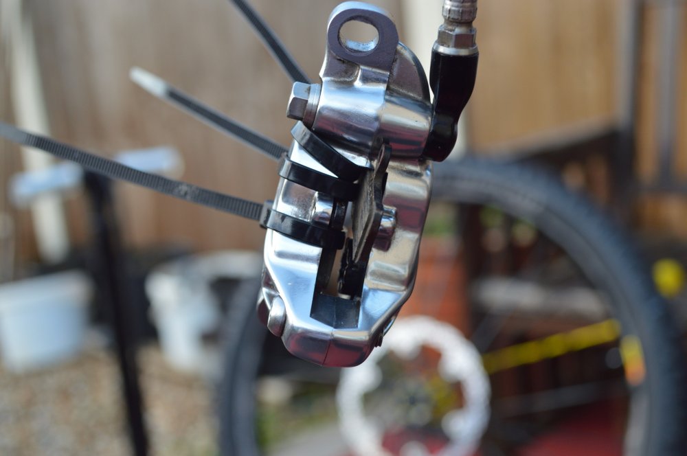

My problem was that I would set the brakes up just fine, but in no time they would start squeaking, not when braking but just going along.
I changed the front rotor which cured it, but feeling reluctant to going to all the bother of changing the rear one, I squirted it with citrus degreaser, gently applied the brake and rolled the bike forward to distribute the cleaner onto the pads, then used a strong hose pipe to thoroughly wash the disc and pads etc.
Seems to have worked, so I can only surmise that the problem was a build up of brake dust.

i bet not one of you have cleaned and lubed the caliper pistons no point just pushing it back with new pads as it will just get stuck again rub on the rotor and make a noise.
every 6 months you should clean and lube the pistons so there moving about the same so to center the pads on the rotor otherwise if one is moving way more than the other it will make 1 pad way closer to the rotor than the other and be a pita to center the pads on the rotor.
it might not make a noise but it will wear down the pads way faster.
use the brake fluid your bike uses to lube the pistons with a q tip or use the hope stuff just dont pop out the pistons or you will need to bleed the brakes and rebuild the calipers ;)
