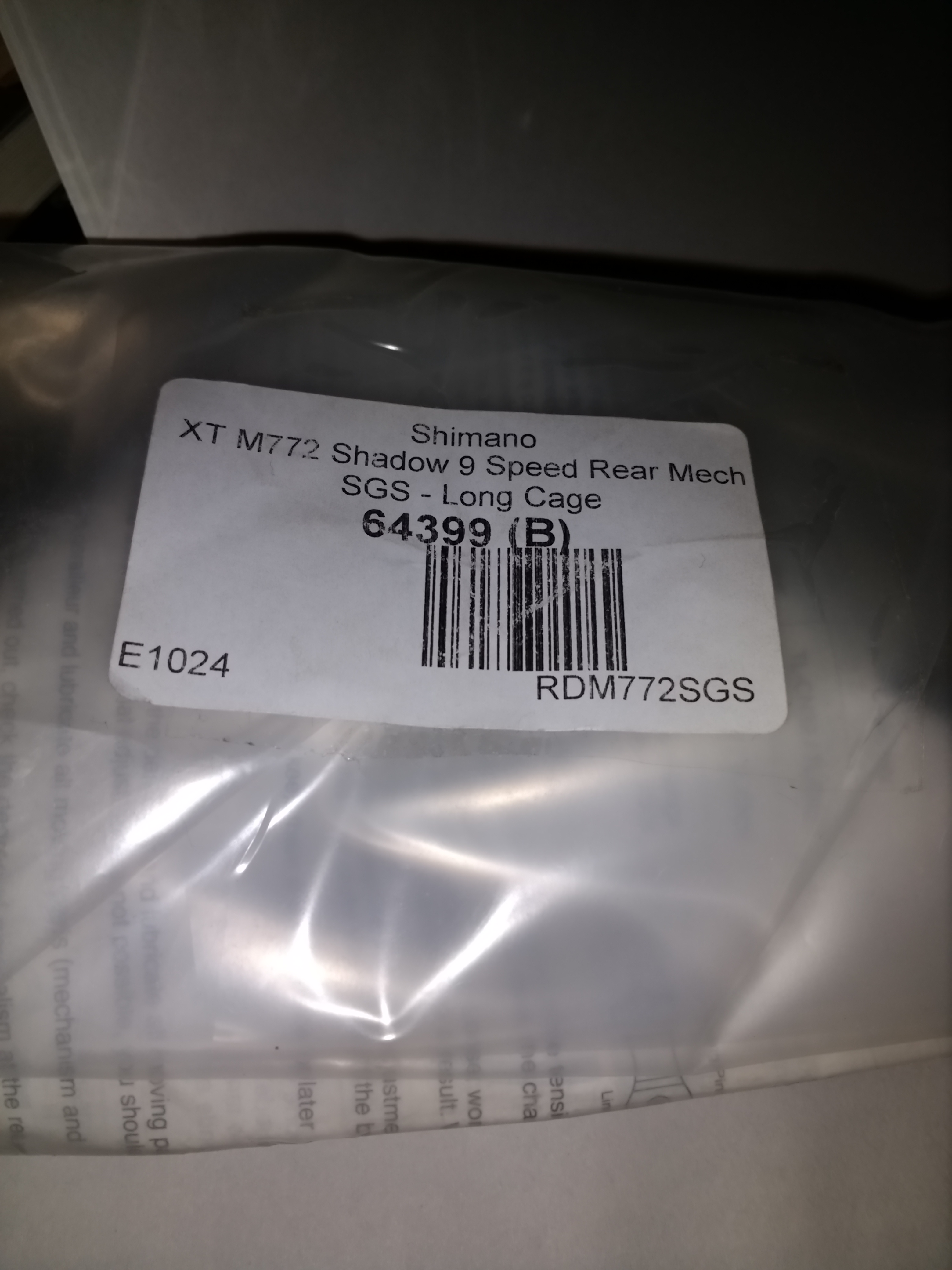

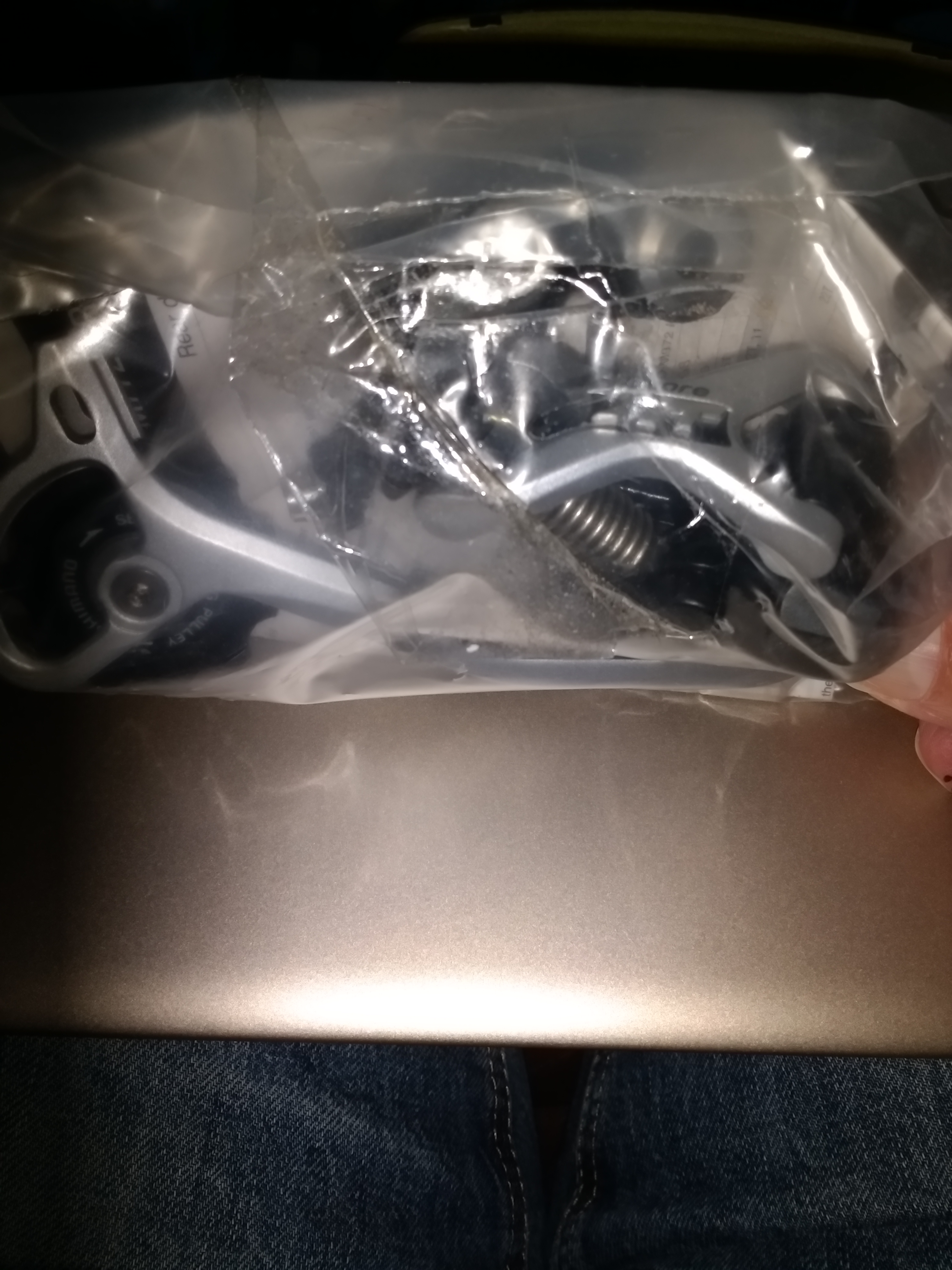

November 9, 20196 yr Hi,i have this unused Shimano XT long cage rear derailleur spare. part no: RDM772SGS. Photos not that good as I am using my phone, make me a decent offer and it's yours. Thanks
