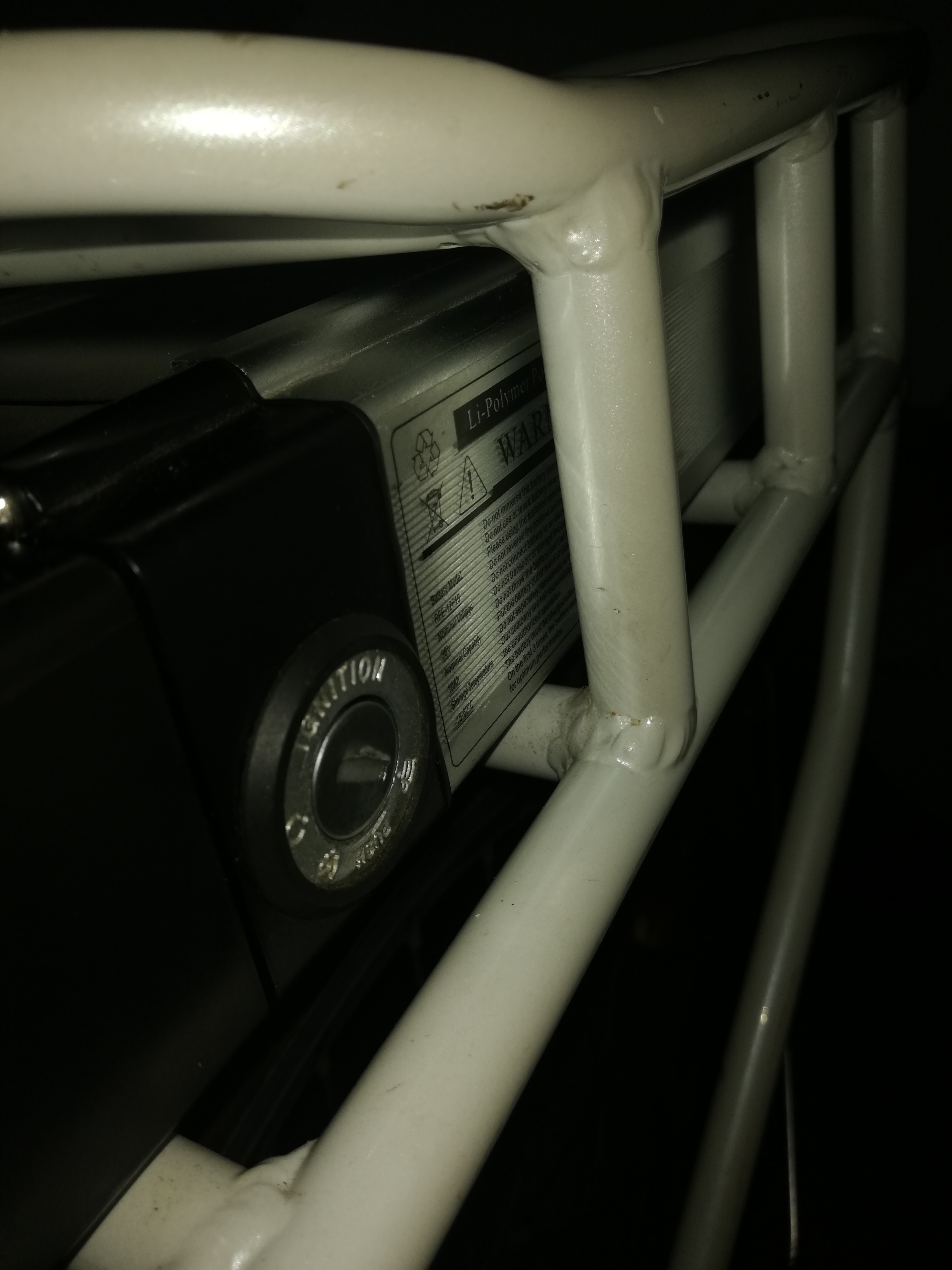

Earlier you mentioned the battery key, does your key turn on and off the power or does it just lock the battery in place?
If the key is also an electrical switch it would be worth testing the battery voltage on both sides of that switch under load to make sure the current isn’t being restricted.

The key turns on and off the battery...

actually i have problem with the switch but i dont think it would be the problem
What do you mean you have a problem with the switch?
The place where we introduce the key, sometimes when i turned the key so as to start or to take out battery, sometimes it gets out from its place.. And i have to replace it again
