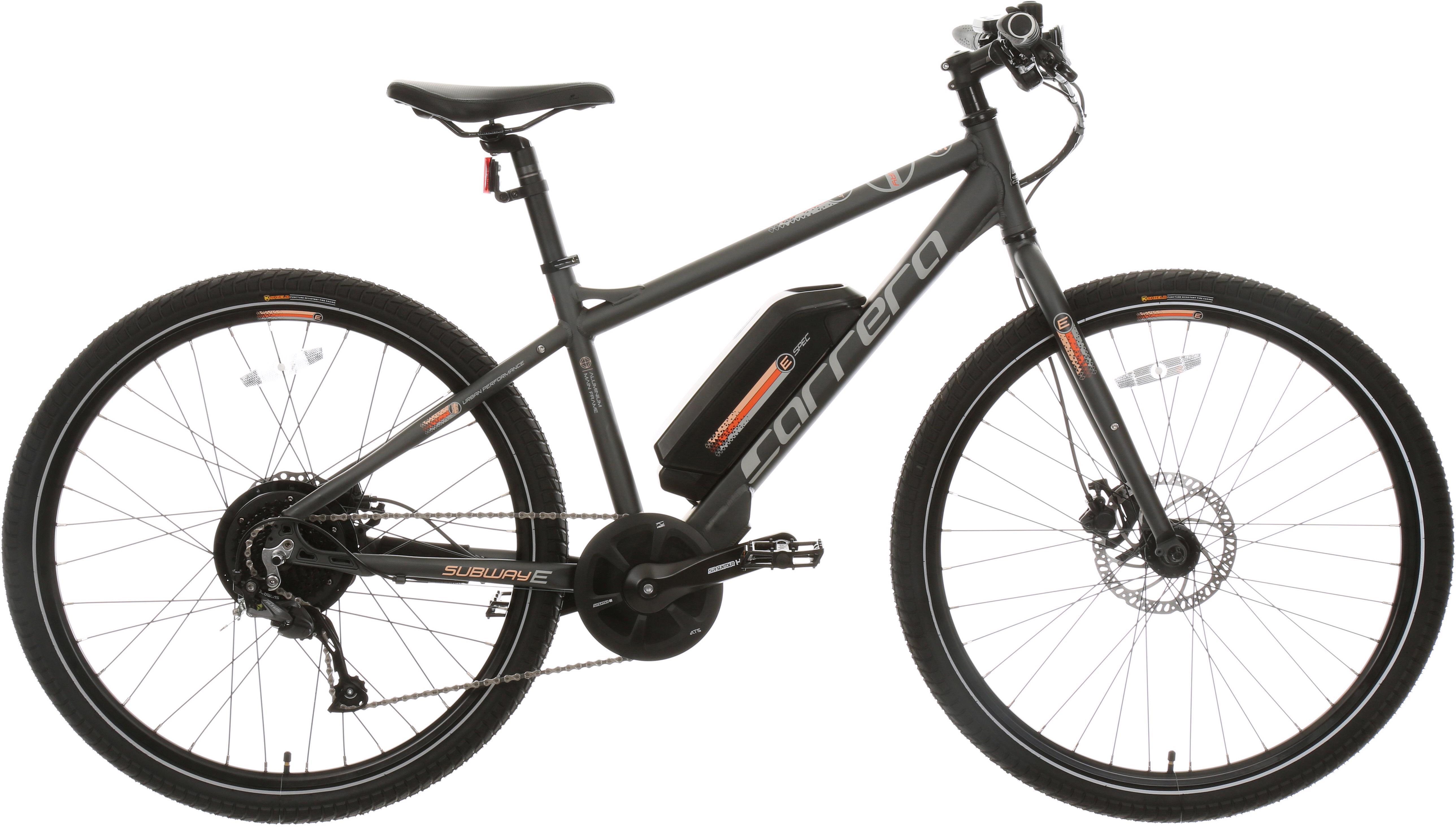

My recommendation would be something like this;
https://www.halfords.com/bikes/electric-bikes/carrera-subway-womens-electric-hybrid-bike---14in-16in-frames-224406.html
It's simple and reliable and more importantly comfortable and strong. I wouldn't go to your £2000 limit personally because I don't think you have to and if the plan is to cycle to lose weight then I would reward yourself with a better bike down the line when you've lost some weight. As its halfords you can pop in to your local store and try it out.
that Carrera Subway that Bonzo Banana recommended has a lower top tube than a crossbar but is too high to step through for a lot of people.
760995?w=740&h=555&qlt=75&fmt=webp&v=1
This Woosh Santana is much easier to get on/off:
Some other important considerations are:
- the sensor type: cadence or torque.
If you choose a bike with a torque sensor, you need to supply 25% to 50% of the energy required. It's fine for flat roads but on hills, it is very challenging, especially if your weigh is an issue. You also need to maintain a high cadence. If you have breathing impairment, don't go there.
If you choose a cadence sensor, you can pedal as little or as much as you like, a clear advantage if you are tired at the end of the day.
The Carrera that Bonzo Banana recommends has a torque sensor.
- the motor torque:
You need torque to climb hills and accelerate from standstill. The heavier you are, the more torque you need. That is why Woosh use different motors to suit different riders weights. The Faro uses a 1.7kg Aikema 85SX motor, the Petite 3kg Bafang SWX motor, the Santana3 4kgs Bafang SWX02 motor and the Big Bear 4.5kgs Bafang BPM motor. The BPM on the Big Bear produces about 40% more torque than the Aikema on the Faro.
The Suntour motor on the Carrera has about same size and weight and is comparable to the Bafang SWX on the Petite. The motors on the Santana3 and Big Bear are stronger when climbing hills.
- Brakes
If you are heavy, you need hydraulic brakes which stop better than cable operated brakes.

I agree with a lot of your points but the Subway does have good tektro hydraulic brakes and more importantly is fully rated for a 120kg rider with a strong mountain bike frame that will have no problem taking 120kg rider weight as will the strong mountain bike wheels. Step thru's often require a lot more metal in the frame to provide similar strength or they are simply not rated for the same weight rider. Decathlon had that huge recall on their step through e-bikes because the frames kept failing and those bikes were only rated to 100kg total load so only allowed a rider of about 75-80kg as well. Admittedly Decathlon frames are often junk and they use the cheaper frames often sold on the Chinese market it seems for lighter oriental riders hence their low weight limits but still I feel a heavier rider there is a risk for a heavier rider with a step-thru frame and is that risk worth taking, the Subway does has a slightly lowered top tube but still very high structural strength.
Also the Subway has a high quality strong freehub based drivetrain so can take wide ratio cassettes and already comes with a fairly decent 60Nm geared motor hub surely such a combination should allow anyone to get up those hills. The Subway also provides a lifetime warranty on frame and forks and the fact it is rated for a 120kg rider means realistically you should expect a minimum of 7-10 years use. I know frame warranties are about manufacturing defects and fatigue caused by heavy use is realistically only covered up to about 10 years as per the certification testing you'd need to have a weld failure for them to honour the warranty in 20 years but its still a great warranty to have.
In my experience Carrera is Halfords less performance orientated brand often strong frames with less flexing designed to last a long time with durability and strength put before comfort and performance. You only have to look at that frame to see they have paid the factory to put extra reinforcing between top tube and the top of the seat tube, bottom of downtube to headtube, reinforced the bottom bracket and they have used ultra-strong steel forks. It's a no compromise design for strength. That's not to say here comfort is reduced as it has mountain bike wheels so takes thick tyres that can easily be optimised for the weight of the rider to provide a suspension effect and great comfort. The saddle to me looks like the first upgrade to improve comfort though.

Bonzo, I have been selling the Big Bears to heavy riders for 7 years, I never have a broken frame. There are maybe 200+ members of the forum who bought the Big Bears for that reason, because the bike suits their needs. Next time you are in Southend, you should pop in to our shop to check for yourself. I have a large Halfords shop in the next street (London Road) and see regularly all their own range of e-bikes when I pop in for some bicycle parts. Honestly, they don't compare with German bikes nor with mines.
The Chinese make bikes for anyone, so using the adjective as a yardstick is meaningless.
You need to specify the rotational speed to make sense of a torque figure. A motor will have very high torque when it is near stalling. Suntour does not say how it is measured nor how much the required user input is.
A lot of time, people buy an e-bike to help them with hills.
Your Subway does not do well with those who have a bad BMI. They need a cadence sensor.

Your comments are coming across as extremely biased and clearly defending your commercial interests. It's easy to claim a bike will take a lot of weight if you offer a short warranty as failing frames will likely be outside the warranty period. I prefer to take the approach if a bike company is offering high weight limits and a long warranty that forms the basis of a good approach to buying a bike suitable for a heavier rider. Bikes have to be certified for sale and if you state weight limits then that has to be backed up by the certification which shows comprehensive tests on the frame and forks and normally the instruction manual is part of that certification I believe. While the certification I have dealt with hasn't been directly bike related I have in my time read much of the BSI bike certification when I worked for a company that had an open license on the BSI site so I could read different certification not related to the industry I was in.
The bike you suggested has a low end freewheel based drivetrain typically found on many sub £100 bikes, the idea that that somehow your bike based on low end components is somehow better than Halfords with mid-level components is not something I agree with. I base my purchases on a proper examination of the spec vs price and it so happens Halfords having as much as 40% of the UK bike market by volume and 25% by revenue plus buying directly from factories and retailing them directly means they are extremely cheap for their specification especially when you buy when they are on offer and you use discount codes and cashback sites. It's amazing what you can get from Halfords. I have no commercial interest in Halfords just can see what exceptional value they provide compared to most bike retailers. I've been warned bout Halfords by many bike shops who often try to sell me some piece of junk bike for twice the price of the Halfords bike I was considering, often with much lower end components, i.e. mountain bikes that look like mountain bikes but feature freewheels instead of freehubs and lower spec suspension like XCT instead of XCM etc despite their high price.
Anyway we will definitely have to agree to disagree to say the least.

I can agree with you on this.
You did not bother to look into the argument, standover height, torque sensor versus cadence sensor.
Of course I am biased to my products because I know them well but that has no bearing on me saying that the Subway you recommended is not suitable for the OP.
