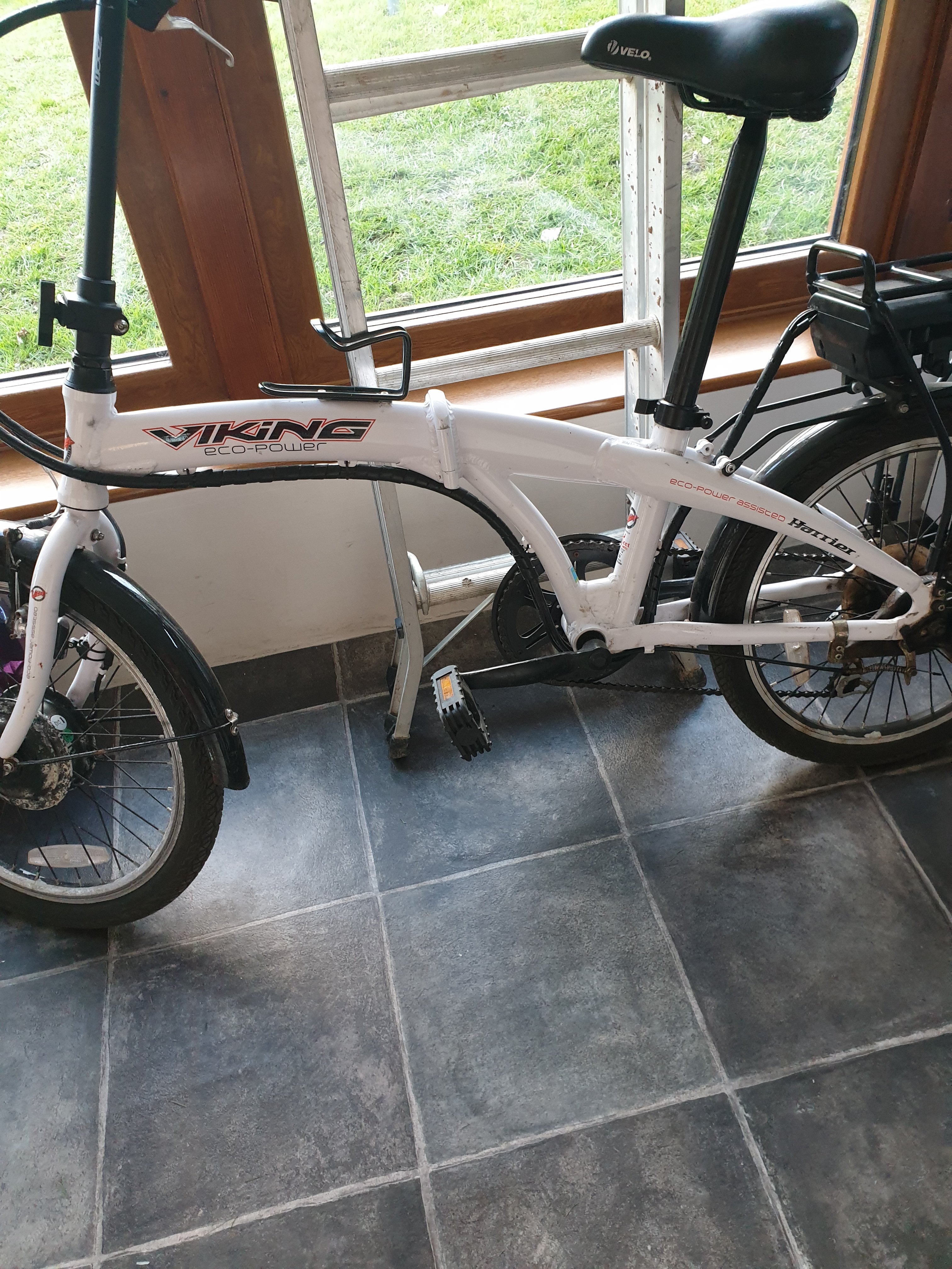

Hi everyone.
So my next door neighbour gave me a bike for my wife. She gave it to me knowing there was a issue with it. The pedal assist works fine on the flat but doesnt work on a incline! Battery is fully charge. Haven't looked at it properly yet, just thought I'd put it out there to see if anyone had some suggestions! Thanks for your time

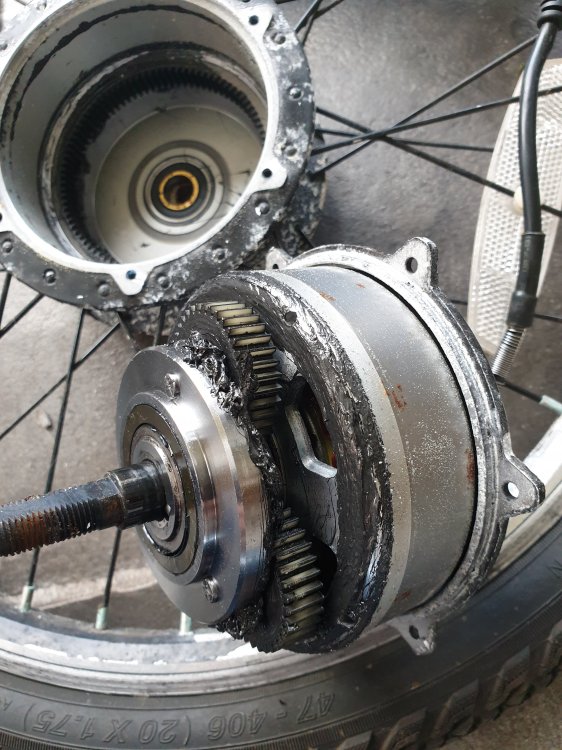

That front hub looks a bit sorry looking at the state of it, may be it could do with a little service. They are often quite easy to open up.

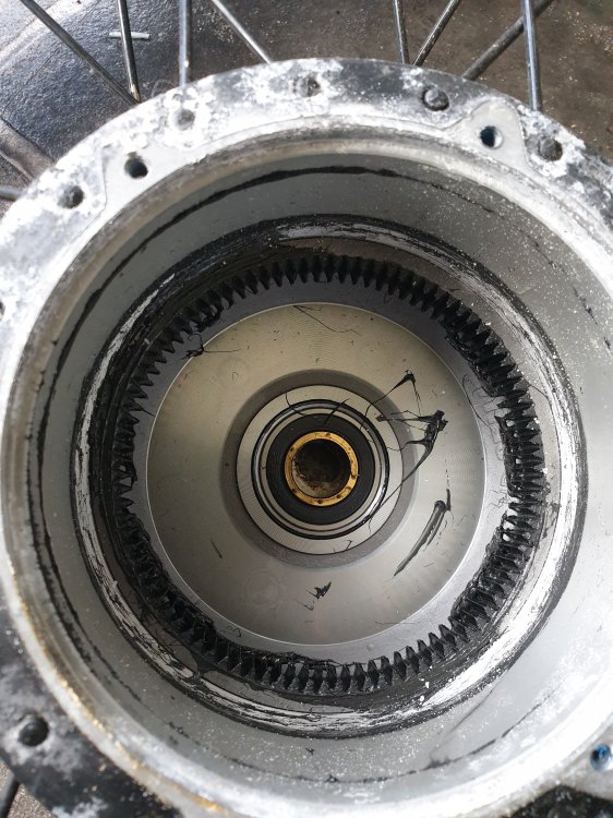

I've just taken the front hub off. All seems good to me. Gears are all good, no broken or missing teeth. No play in the bearings. What's the general way to service these? Just a regm grease? Again, ive attached pic of front hub. Thanks

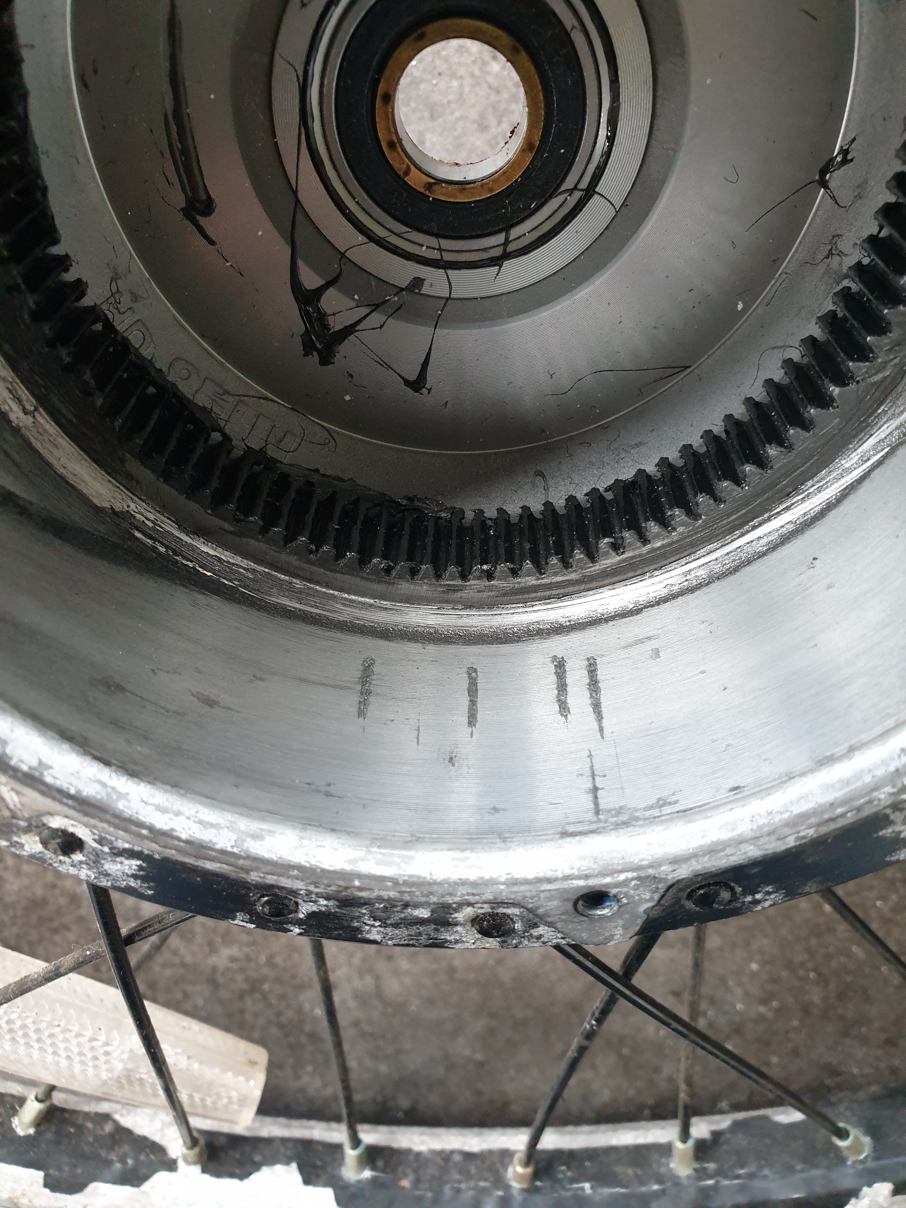

I have just noticed 4 score Mark's inside the hub. Not very deep. Would these affect anything?
Motor looks fine, have you measured the voltage of your batteries when fully charged? I think they are the most likely cause of your problem.

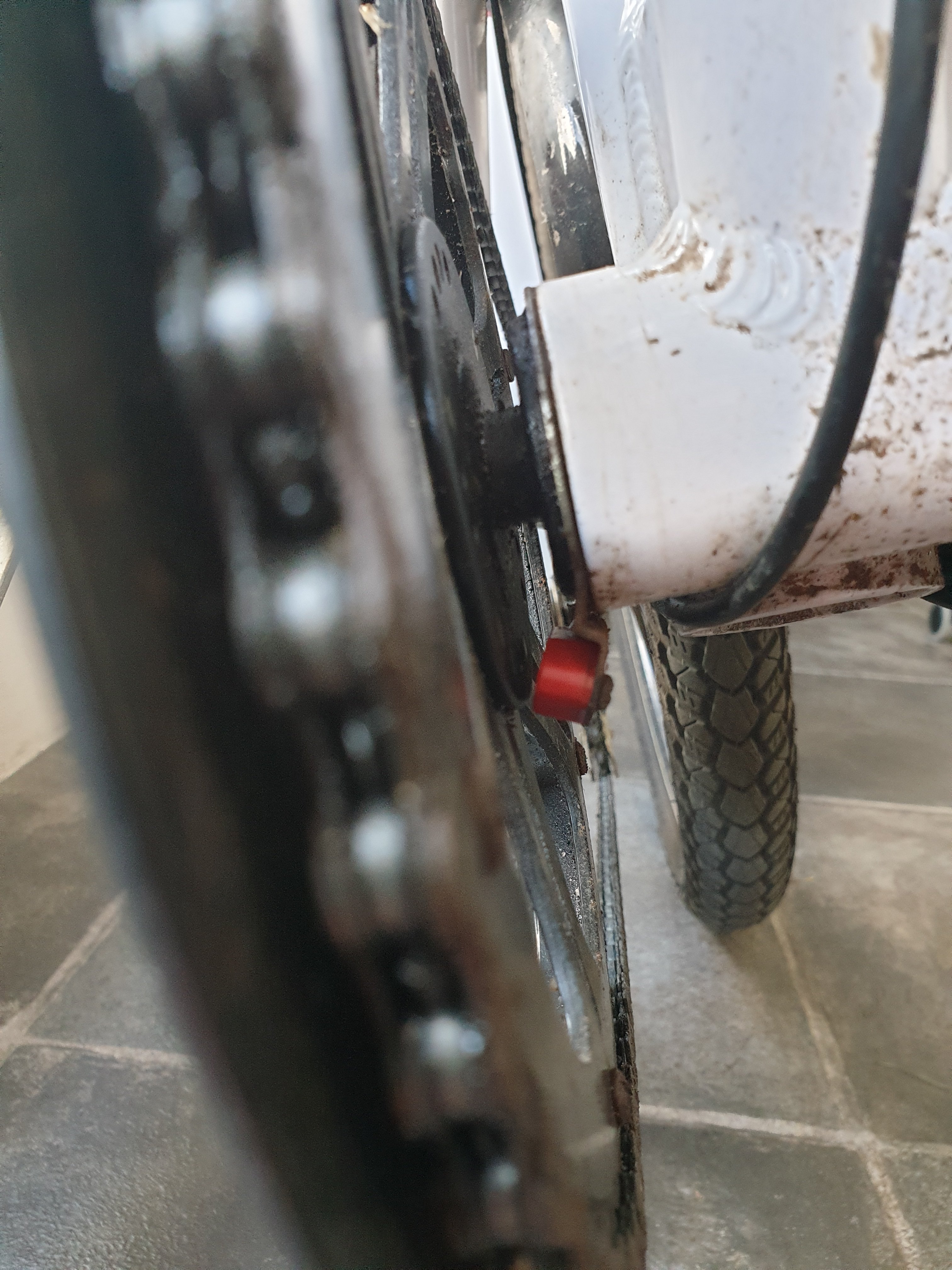

What about the position of the sensor against the magnets? Does it matter that it's at a angle against the magnets? It's only 2 mm away on the top edge but maybe 7 or 8 on the bottom

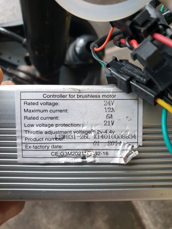

I don't think this is an issue as the bike is working fine on flat road. You will struggle to find many 24v batteries as most bikes now are 36v. You also have the problem that the controller on your bike is housed in the battery mount, so this will need to be placed elsewhere if you fit a different style of battery. It's unfortunate that because ebikes "age" quite quickly that bikes soon become difficult to keep in service even when, like yours, they have seen very little use. Having said that, you could upgrade the controller and battery to 36v for around £300 and have a bike that should last a few years.
That sounds like a plan. Are you able to point me in the right direction for a new controller and upgraded 36v battery please? Is it possible to add a throttle?
It appears to me that the disc has been replaced with a smaller diameter one and the sensor has been bent so that it gets a signal, the signal pickup might not be 100%. You need to buy the proper larger disc, I posted three options to buy.
If the disc isn't tight on the axle and is also tight to the sensor then the disc likely doesn't rotate correctly, any disc that isn't tight can be easily sorted out by wrapping some electrical tap or amalgamating tape on the axle first then twist the disc on to it.
The hub generally looks pretty good inside, you can slap more grease in if you wish, I use dark moly grease. There looks to be salt crystals on the motor I would clean that up.
