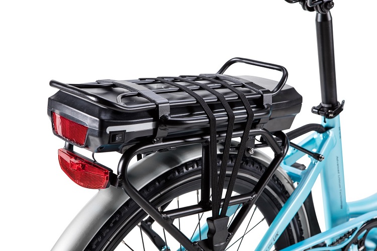

June 8, 20205 yr So it appears my bike, is too small to fit a battery within the frame and it appears other than buying a new bigger bike or a ready-made ebike, that I need to mount the battery on a rear rack or the seat post, I am just looking for the pros and cons of mounting a battery in such a place
June 8, 20205 yr People say that having the battery and the motor on and above the rear wheel can make the bike feel rear heavy. I've never felt this on mine though. I have a rear hub motor and pannier mounted battery.
June 8, 20205 yr Author People say that having the battery and the motor on and above the rear wheel can make the bike feel rear heavy. I've never felt this on mine though. I have a rear hub motor and pannier mounted battery. thanks i am actually going to get a front wheel hub, what battery do you have on the rear, did it come with pannier or did you buy it seperate?
June 8, 20205 yr thanks i am actually going to get a front wheel hub, what battery do you have on the rear, did it come with pannier or did you buy it seperate? I didn't build the bike myself, its a Whisper 705se. The front hub and rear battery should even out your weight distribution a fair bit. The picture attached is how mine is set up, there are kits that incorporate a battery and pannier. https://electric-bike-conversions.co.uk/products/kit-builder
June 8, 20205 yr I have a rear hub with 36v/12ah downtube battery fitted to the rear rack. With rider the weight is split 30kg/90kg (30kg/120kg with some shopping in the panniers). Center of gravity is a lot further back than normal so I lift the bike by the seat post, otherwise its not noticeable.
June 8, 20205 yr My Boardman hybrid mx/cx 700c day out bike is rear hub Aikema 128c has a downtube battery and a 91 cell rear rack/topbag battery , handling is only compromised if tackling gnarly slow tight twisty wooded sections. Other wise handling is good in the woods, open trials and on the Downs off piste. My 700c commute/town bike has a Bafang cst with down tube battery, handling with panniers full of shopping is a different game and can be awful if it is weighty. For a rack battery to cause handling to be really bad is has to be badly mounted or mahoosive. For rear rack the rack needs to be as far forward and as low over the wheel as possible.
