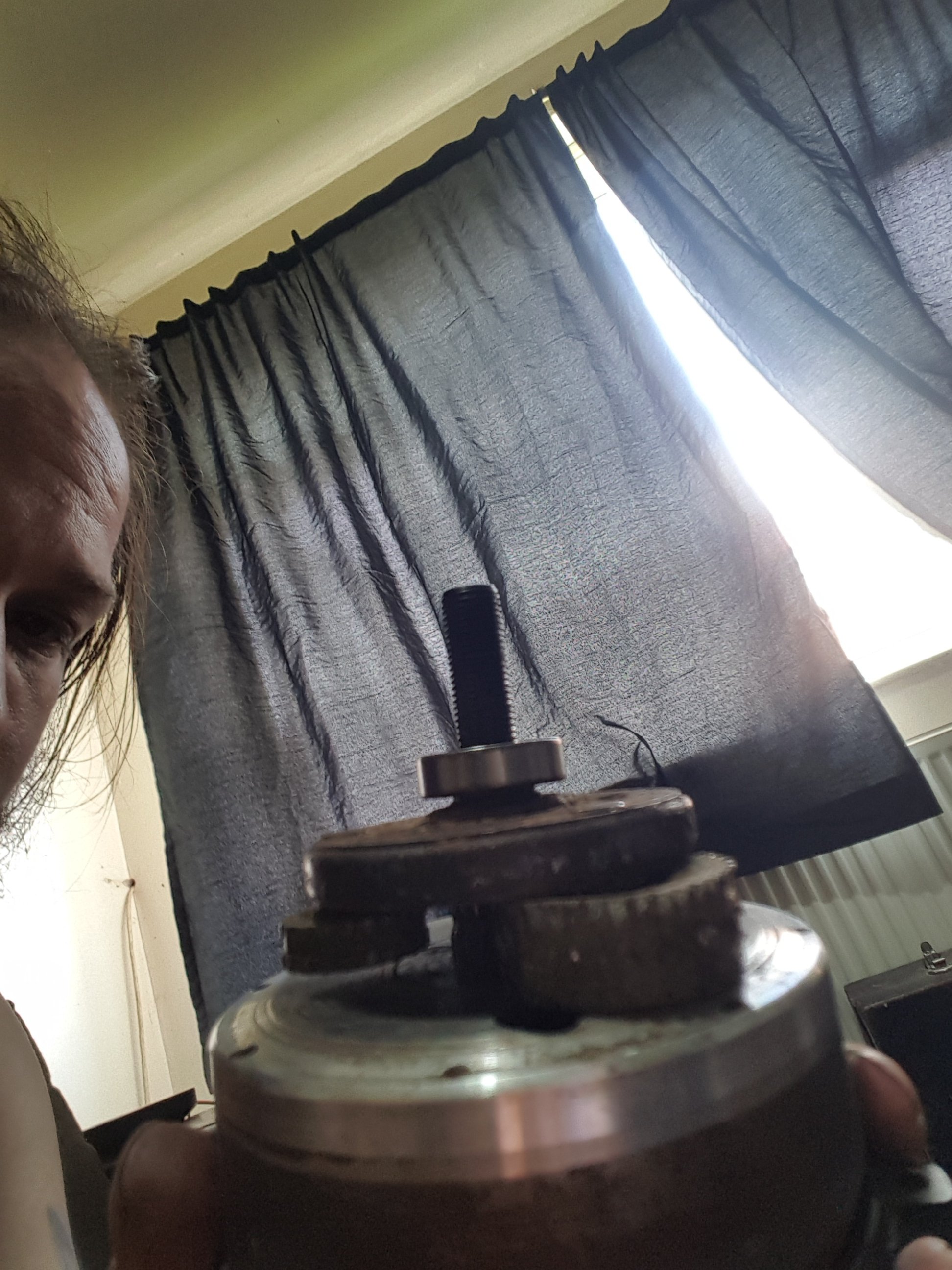

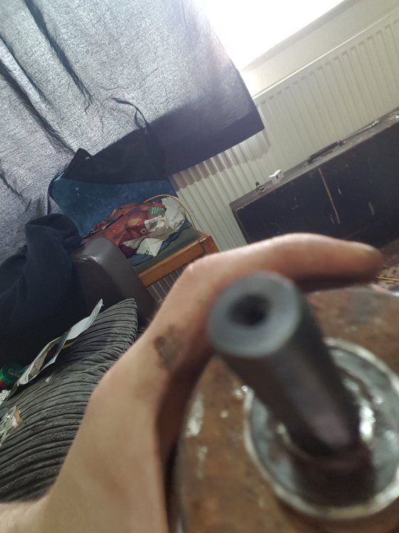

July 25, 20205 yr Hi my hub just stopped working so I opened it up and the planetary gears are shredded everything else seems fine but I can't remove the gear plate there was a thin nut sat on top of a silver metal piece on top of the plate I got the nut off but can't figure out how to remove the rest. Near as I can tell it's an mxus 36v 250w front motor from the eplus commute sold by arg9s and bikesdirect will post pics later

July 25, 20205 yr Hi, my motor is different but similar enough to be helpful. You need to remove the bearing from the shaft first (tyre leavers , screwdrivers as elevers, bear puller?) on mine the bearing came off with the sidecover. Then I could remove the large rusty plate holding the 3 nylon cogs using just hand pressure. Photos might help https://www.pedelecs.co.uk/forum/threads/kemp-starley-dutch-town-bike-out-of-hibernation.37181/#post-552149
July 25, 20205 yr Author Hi, my motor is different but similar enough to be helpful. You need to remove the bearing from the shaft first (tyre leavers , screwdrivers as elevers, bear puller?) on mine the bearing came off with the sidecover. Then I could remove the large rusty plate holding the 3 nylon cogs using just hand pressure. Photos might help https://www.pedelecs.co.uk/forum/threads/kemp-starley-dutch-town-bike-out-of-hibernation.37181/#post-552149 Pics
July 25, 20205 yr Author The Mxus looks like it has had severe water ingestion with all that rust matter. Yeah that's what I think but the damn things are supposed to be sealed and I only run it on the road and my god is the customer service shoddy
July 25, 20205 yr The motor axle may have been fitted upside down in the forks allowing water to run down the cable and into the motor. If/when you refit make sure the slot in the axle where the cable exits faces downwards.
July 25, 20205 yr The motor axle may have been fitted upside down in the forks allowing water to run down the cable and into the motor. If/when you refit make sure the slot in the axle where the cable exits faces downwards. Knock the bearing off using a metal wedge of some sort. When I had one like that, I used my angle grinder to grind a bit of scrap steel into a wedge with a gap for the axle so that it lifted both sides at the same time. Once the bearing is out of the way, there should be a circlip holding the clutch on. remove that, then use a two or three-legged puller on the clutch if it doesn't slide off easily.
July 25, 20205 yr I always try to avoid hitting mechanical things if I can. If you can get a small 3 leg puller under the bearing, that's the best way, but there may not be enough space. An alternative is the kind of puller you can get for taking windscreen wiper arms off of cars. You might find one you can get under the bearing. If not the fork wedge idea of vfr's should do it, but be careful. Probably a good idea to replace the bearing when you get it all back together. But use a bolt and some washers to ease it back into the hub housing, don't use a hammer. Edited July 25, 20205 yr by WheezyRider

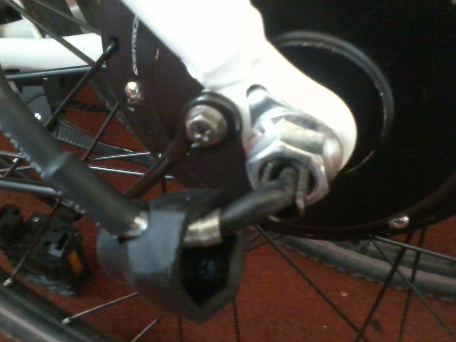

July 25, 20205 yr This is how mine came installed. Should the cable groove be at the bottom for water egress?
July 25, 20205 yr Knock the bearing off using a metal wedge of some sort. When I had one like that, I used my angle grinder to grind a bit of scrap steel into a wedge with a gap for the axle so that it lifted both sides at the same time. Once the bearing is out of the way, there should be a circlip holding the clutch on. remove that, then use a two or three-legged puller on the clutch if it doesn't slide off easily. Vfr, is there definitely a circlip holding the clutch on the shaft on MXUS motors? The Bafangs I've taken apart don't have one, but the Voilamarts do. If there isn't one, you could just put the 3 leg puller on the clutch and pull both off at the same time.

July 25, 20205 yr This is how mine came installed. Yeah, that's up side down, may explain your rusty internals. It's easily done after punture repair or even at the factory. It looks right as the cable runs up the forkleg. Edited July 25, 20205 yr by wheeliepete
July 25, 20205 yr Yeah, that's up side down, may explain your rusty internals. Those are not my rusty internals thank you but the OP's . Looks like I'm going to have to do something about that before mine go the same way. Someone at the factory not following or understanding instructions?
July 25, 20205 yr Those are not my rusty internals thank you but the OP's Ah, sorry Mars, I'm easily confused these days . Yes, best to turn it even if you never ride in the rain as water from puddles splash up, run down spokes etc. and get trapped.
