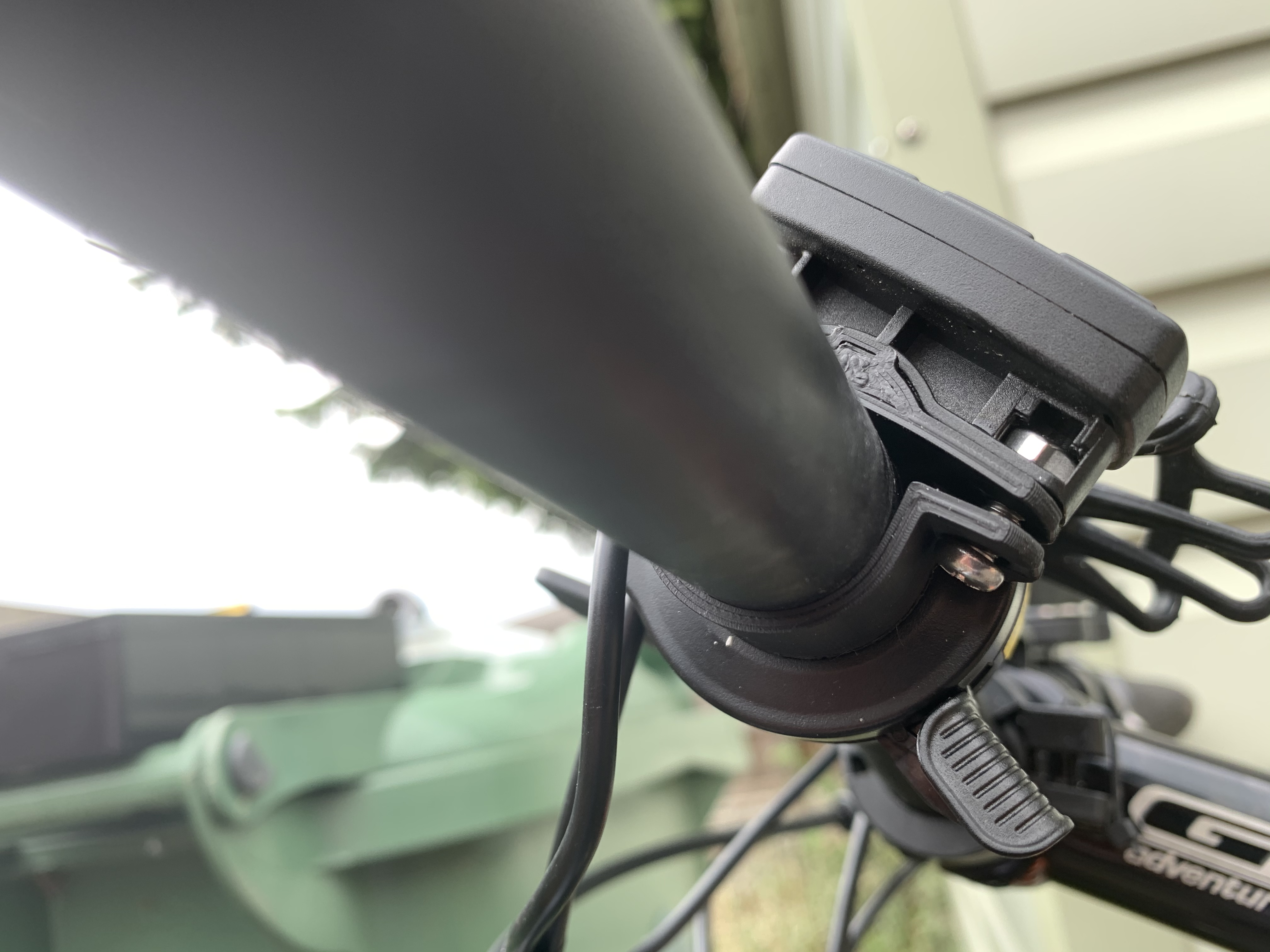

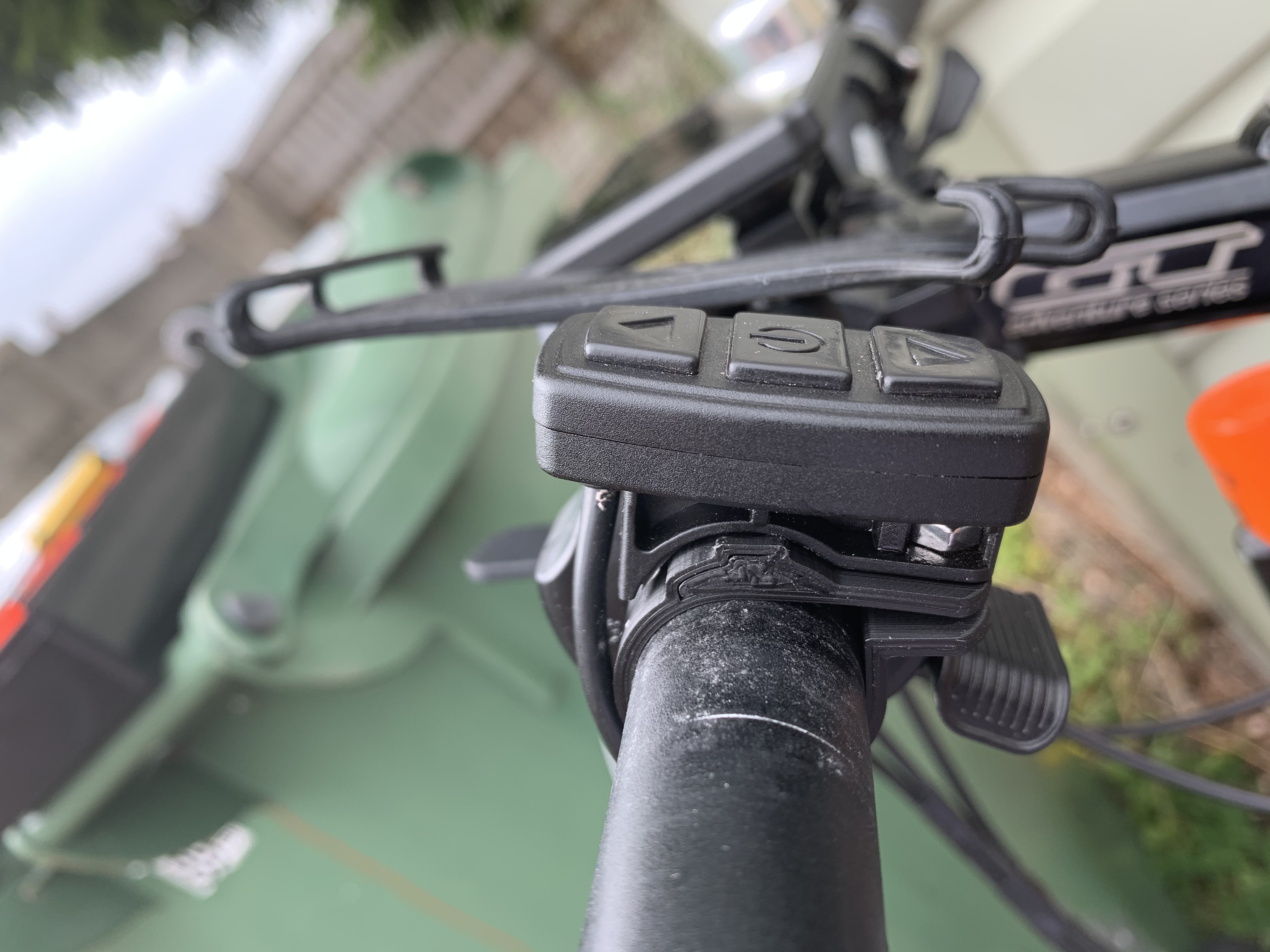

Received my bracket this morning (thanks again!) and fitted it during my lunch break. Perfect fit and very rigid. Certainly not going anywhere. Would definitely recommend if anyone has suffered the dreaded button box break!

I got in from work tonight just before 23.00hrs and my pair were sitting on the mat, will see if I can find time to fit one tomorrow on my Norco 700c commuter.
The PLA 3D replacement holder is perfect, great stuff Daniel.
Grips firmly and looks good, some might want to fit a 3 or 4mm longer M4 machine screw.

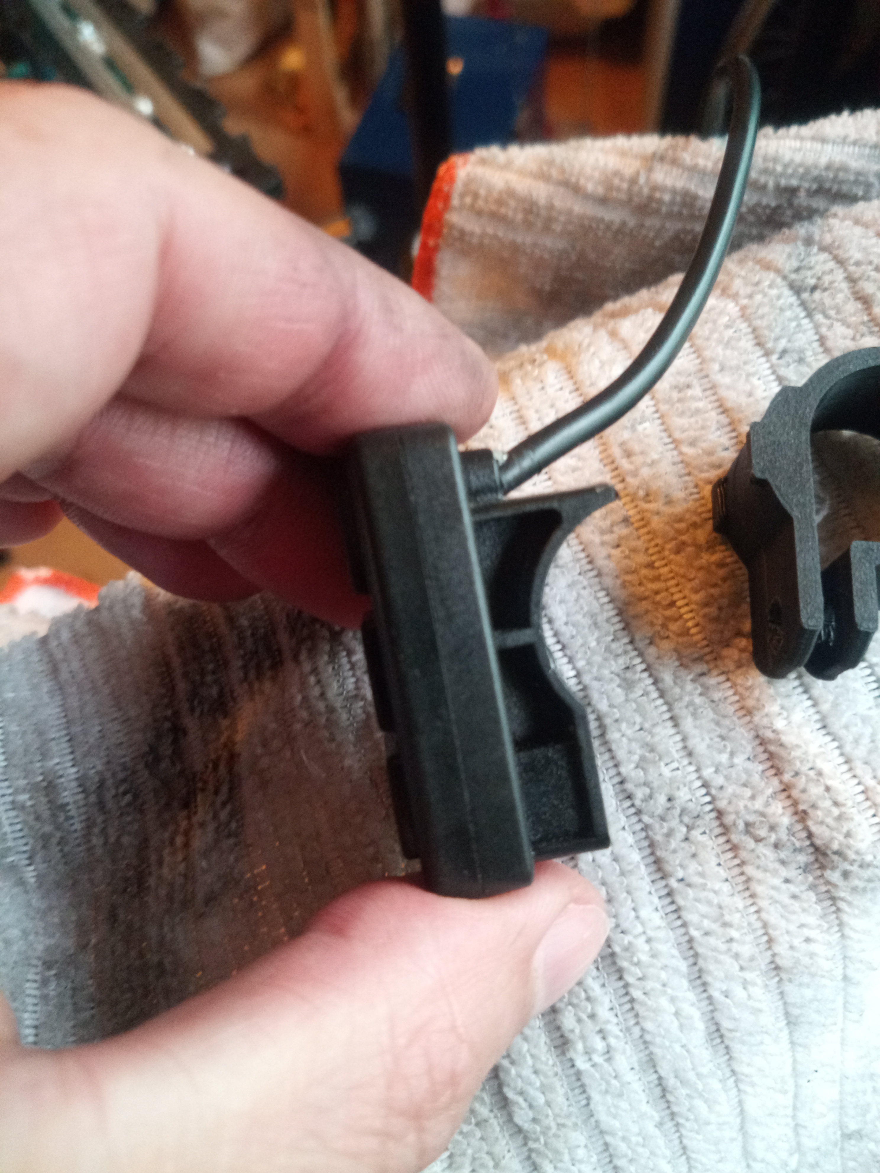

Button pad with offending old broken holder sawn off.
Button pad with new PLA 3D holder in position.
Button pad fixed on the handle bar.
Thank you for your feedback Neal. Is your button assembly attached to a standard 22.2mm handlebar and did you need a longer screw? The original 13mm screw should be long enough for a standard handlebar.
Yes 22mm Daniel, I did use the original screw just mentioned it as the thread didn't want to engage with the nut without more pressure then I expected.
Hmmm... I wonder if that's due to a slightly-less-than-perpendicular screw/nut engagement that occurs when the bracket is compressed enough for the screw to reach the captive nut. I thought I'd left sufficient play in the screw hole to account for this, but possibly not. Seeing as you were able to fit it successfully in the end, I'll probably leave the design as it is.

Yep. You'll have to remove the remaining portion of the bracket to make room for the replacement though.

Recieved today and fits perfect and feels much stronger than i expected it to and i would say stronger that the original. Once everything is back together you wouldn't notice it had been repaired. I used the same screw that came with my LCD3 and didn't have any issue with mine. Good to hear you are going to make these available to purchase and i would be happy to pay for one if any of my other conversions encounter the same issue.
