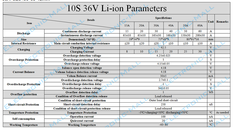

I'm currently running a long term experiment looking at how long it takes for cells to go out of balance if charging to 41V (see my thread in the Technical section of the forum):
https://www.pedelecs.co.uk/forum/threads/charging-pack-to-41v-experiment.38470/
After >60 cycles, the cells show no sign of going out of balance. It had occurred to me that perhaps the BMS was balancing even at a lower voltage, but according to the spec sheet, it should only balance at 4.18V and above:
However, can this be trusted? It isn't a smart BMS, or programmable. I suppose the only way of being sure is to monitor current flow in the balance wires during charging.
Thanks for that, and for Nealh's info.
[ATTACH=full]39610[/ATTACH]

As I said, you can feel the temperature on the bleed resistors when the bleed transistors are open. You don't need a meter.
Your charge voltage is very close to when the bleed resistors are open, like within the margin of measurement error, so it could be that they are in fact doing some balancing.
Unfortunately, it's a sealed unit, so you can't touch the resistors:
If 41V is too close to 41.8V, perhaps only charging to 40.5V will be better.
Maybe I'll do that once I've done 100 to 150 cycles at 41V
