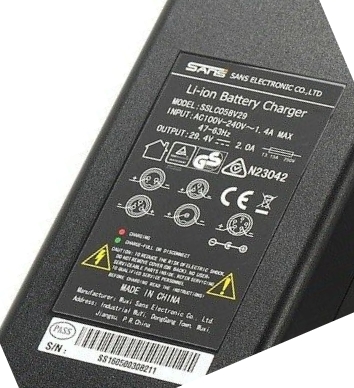

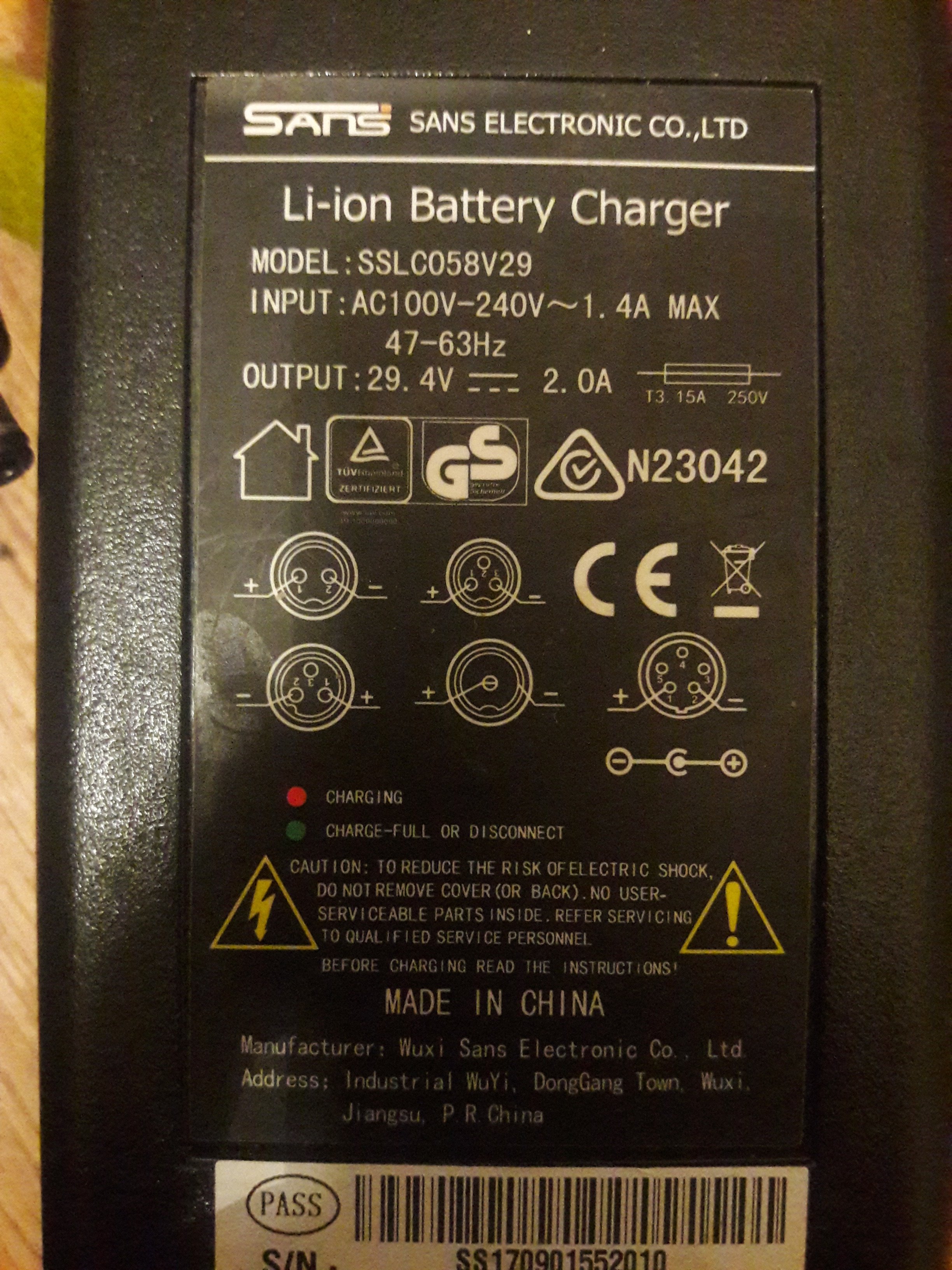

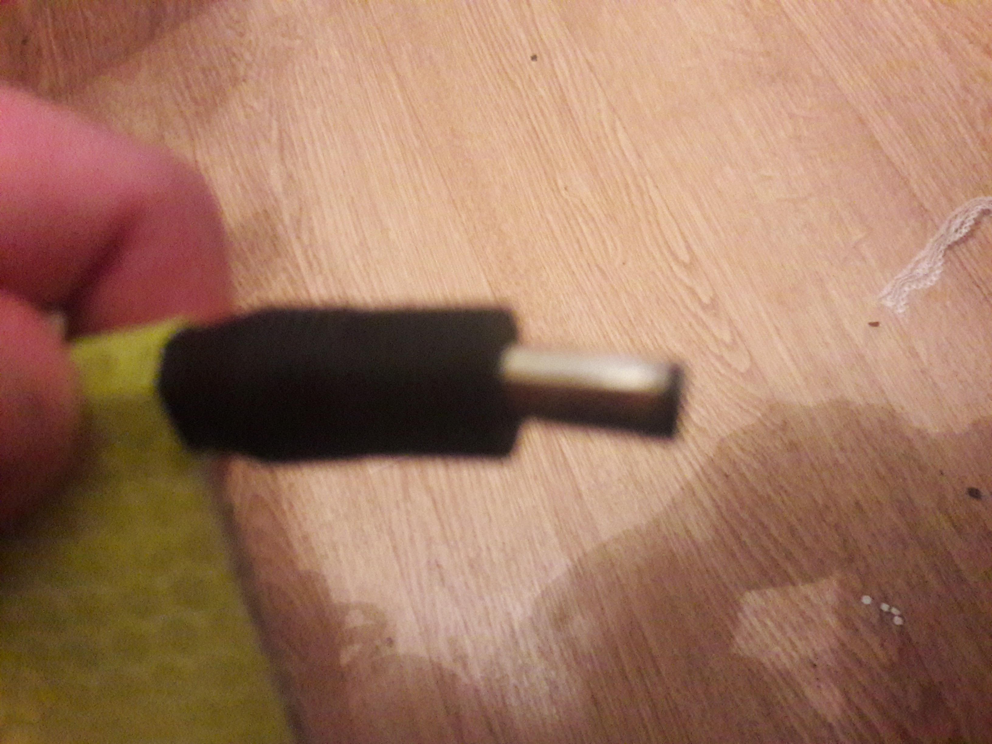

December 13, 20205 yr Author I bought the SANS Charger 29.4V2A with DC2.1 Plug(Model-SSLC058V29 )for 24V E-bike Battery off ebay (cost £24). But the connector in the charger has slightly smaller diameter so it doesn't fit. On the first photo is my connector, on the second photo is the charger I bought from ebay, which connector doesn't fit.

December 13, 20205 yr Author Thank you very much for all the advices. They are very helpful I will look for the adaptor but I still hope somebody knows a battery charger which fit. When trying to buy a new battery charger should I only look for specification: 24V 2A or should I look for something else? I attach the photo of my old battery charger. It is not an original. I bought it from a shop where I bought my bike, but the shop is now closed. Thank you
December 13, 20205 yr If you use your new charger, whether you use an adaptor or cut and solder, be very careful about polarity. Check the polarity of the charger and battery with a meter before connecting them.
December 13, 20205 yr Author It is strange because I got from ebay exactly the same model of the SANS charger (Model-SSLC058V29) as I have but the connector hole is slightly different size. How is it possible?
December 13, 20205 yr Author My old charger and my new charger. The same model. They have the same specifications but the hole in the second in connector is smaller
December 14, 20205 yr J, battery chargers are made with a many different charge connectors. Manufacturers typically can't all agree on unified connector, so Sans and many other make the same model chargers with different connectors. Your new charger will have 5.5mm x 2.1mm dc connector and I suspect your old bent looking one is 5.5mm x 2.5mm dc connector. A pic of the battery charge point will tell us. As Ford has said you will need a 5.5mm x 2.1/2.5mm adapter. 5.5mm x 2.1mm Female to 5.5mm x 2.5mm Male Plug Jack DC Power Adapter connector 7625693634603 | eBay Edited December 14, 20205 yr by Nealh
