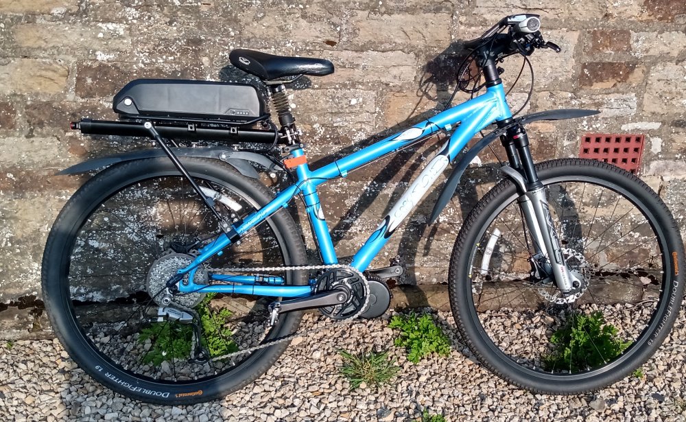

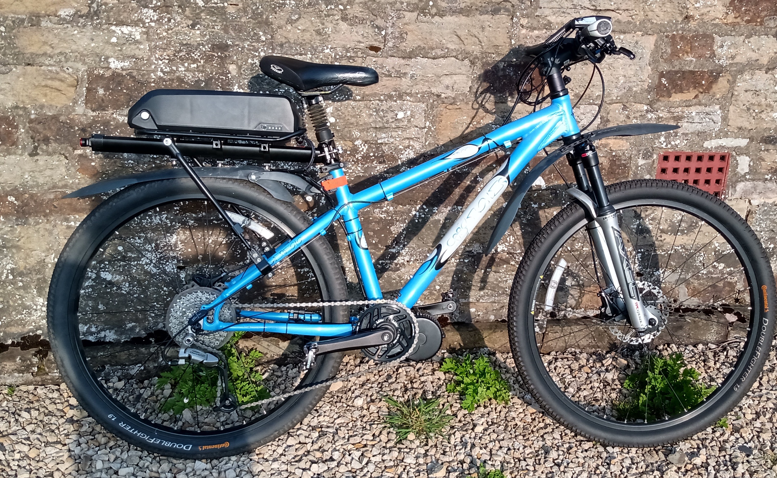

May 13, 20214 yr Author Here it is (Still waiting for the brake sensors, hence the tangle of wires at the handlebars)
