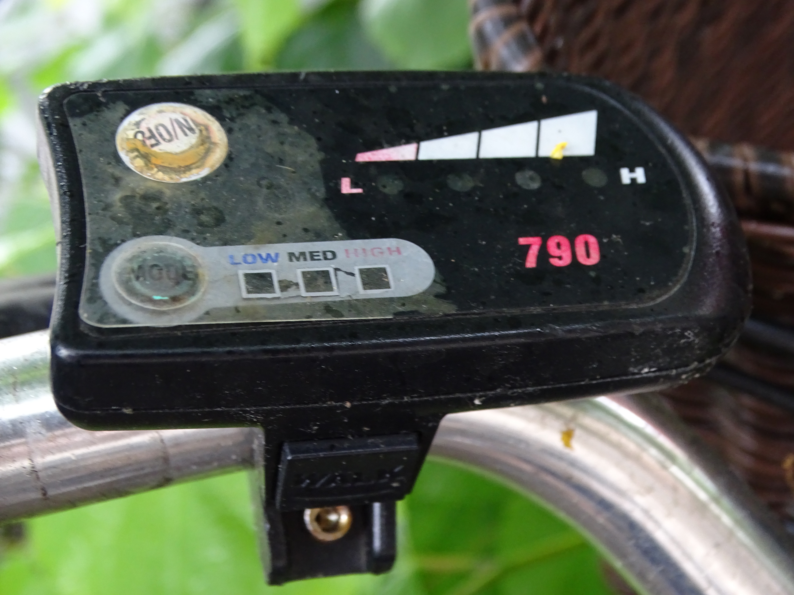

Hello friendly forum folks,

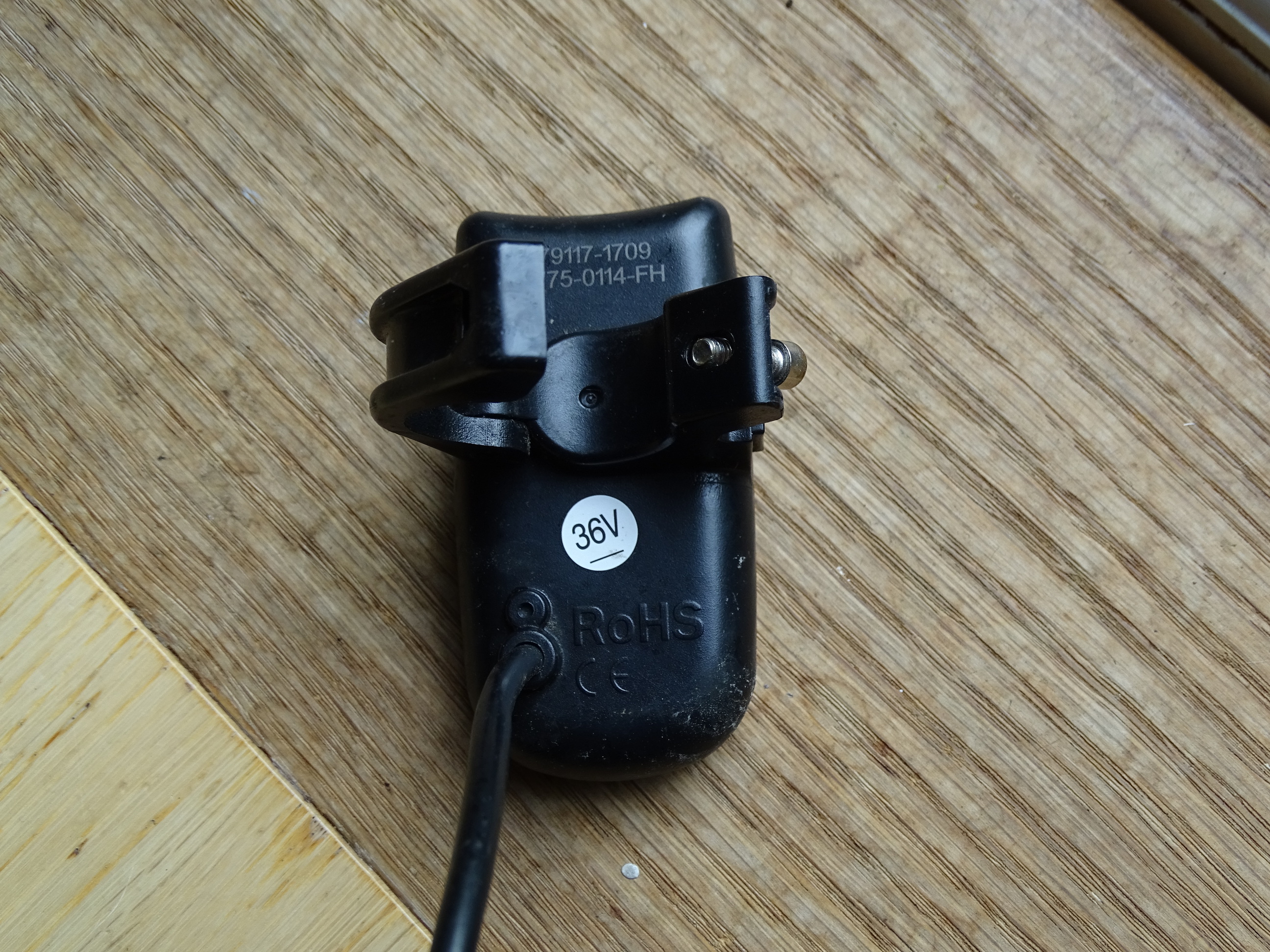

I have a Pendleton Somerby ebike. It's a low-end commuter ebike with a hub motor and generally cheap components. Some combination of wear and water have shorted out the display/buttons unit on the handlebars. I believe the rest of the electrics are good, and I don't want to replace them if I don't have to. I'm really struggling to find any place where I can purchase a compatible replacement display. The only identifying marks on it are the number "790" and some kind of serial number and voltage on the rear (see attached photos)
I've been browsing all kinds of mystery listings on aliexpress and ebay, and I even ordered an "890" display that looked very similar and had the correct connector. It took weeks to arrive, and when it finally did, the display lit up, but I couldn't turn on the motor-assist for the bike.
Can somebody please help me figure out where I can buy a replacement display/handlebar control for this bike? I think what I need is a 36V King Meter 790 LED, with a 5-pin male waterproof connector, and no headlight button, but rather a "walk" button instead. Would this one work, even though it has the headlight button?
Somebody else on this forum had a very similar question, but it sounds like @[mention=10575]Dawes700[/mention] gave up and just hotwired their bike, and I'm not sure I'm comfortable doing that. I'd be extremely grateful for any advice this forum could offer.
Thanks!

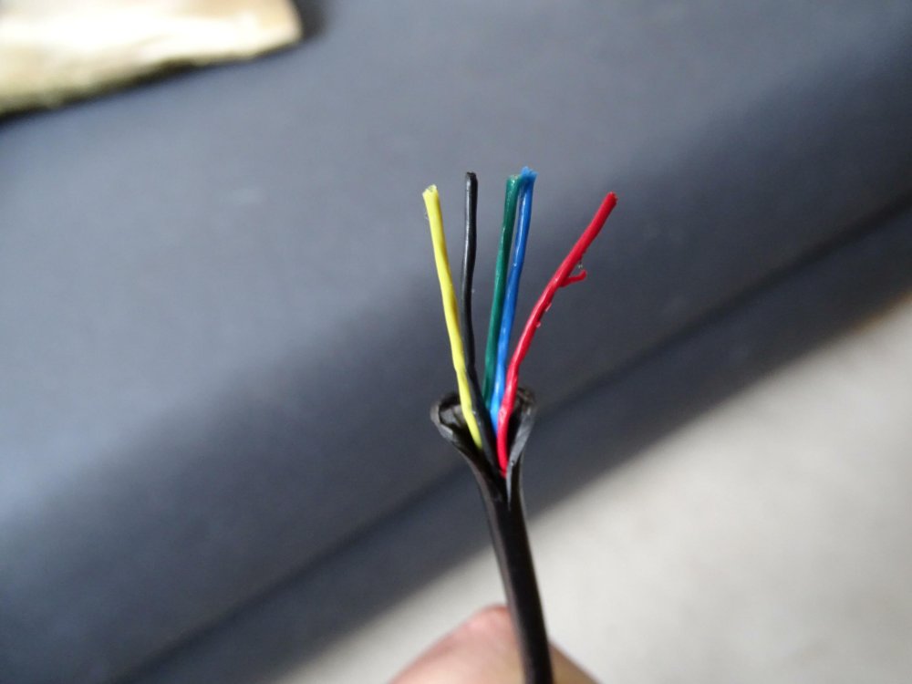

Does it have 4 wires or 5?
It's a 5 pin connector. You can see the exact design in the second photo.

What's the difference between KT / 8fun / King Meter? Is there any way to tell which one I need? There's no brand name on it, and all these displays on Aliexpress look nearly identical.
Unfortunately many brands use the same generic looking display, problem is each manufacturer has different commands/protocols when it comes to the intelligent 5 wires models.
Kingmeter typically are used with lishui controllers as you have on the Pendleton.
8fun are the marketing name of Bafang , whilst KT are Kuenteng, none compatible with each other usage wise due to the software programmed in to the 790 & controller pcb's.
So one has to be careful when selecting an item, it needs to specifically name the brand. Also some have the 6km/h button or alight button, the light button model has 6 pins with an extra center one.
Edited by Nealh
With the 4 pin leds one can get away using any generic 4 pin type usually, but with 5 pin there are more comms between controller and display to confirm compatibility.
Edited by Nealh
The question was how many wires, not how many pins! 790 is normally 4 wires or 5 if it has the light switch, but I'm not sure if there are digital versions that have 5 wires. Is it possible to open it up to see what's connected?

A standard analogue one without light switch has 4 wires. The only way to know which version is to open it up, unless there are only 4 wires in the cable.
that does not matter much, in view that his problem is the membrane switches don't work reliably anymore.
if he has 5 wires before, then his light won't work, no big loss.
I think you might have misunderstood the point. He needs to determine whether his display is analogue or digital.
4 wires are definitely analogue
5 wires with a light switch can be either, so you have to look at the markings on the pcb either in the controller of display
5 wires without a light switch is probably, but not definitely digital.

I clipped the wire off the old display and stripped the outer insulation, it looks like there are 5 wires. This unit has a "walk" button, but not a headlight.

The main issue is compatibility with your existing controller. Obviously the 790 is made by company A and it is then made available to many 3rd party sellers. Each variant will have pcb which is programmed and installed at a central factory for the customer or the customer might buy the 790's in and install the pcb on their own production lines.
As I mentioned 8fun, Lishui, KT and many others use the generic 790 style but none or very few will work with each other. A basic analogue (4 wire ) should but once one has the 5th uart/digital wire compatibility raises it's head.
Generically the one system that is 99.9% bullet proof is/are KT uart systems, many many sellers supply the items and apart from making sure the correct connectors are fitted, any KT listed item will work.
One can buy any KT display of at least 11 different models and they will work with any KT controller. KT make their stuff widely available on the open market.
Bafang are quite good as well and there stuff can also be bought in many places.
Lishui are mainly an OEM supplier only so finding 3rd party components to buy is very hard.
Only two parts need matching for compatibility controller and display, most will use generic sm or Julet connectors except Bafang who use Higo. Although Higo fit Julet's the wire sequence is different so can't be mixed and matched with out chopping and changing wires over.
Most generic stuff will use any throttle, speed & pas sensor as they are analogue simple 3 wire set ups.
Let's get one thing clear, before you can buy a replacement 790, you must figure out whether it's analogue or digital. 4 wres in the cable would have made analogue certain, but 5 can be either.
As your display is now scrap, you need to open it up to see if all the wires are connected to the circuit board inside and look at any markings on the board where the two wires that aren't red, blue or black are soldered.
Most of the 790s for sale on the internet are analogue versions.
