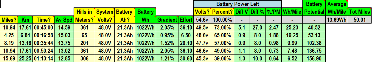

Here's how I am keeping track of it all:
The "Effort" figures are just so I can compare one ride to another. It doesn't actually mean anything on it's own as a unit of measurement - it's the average gradient for that ride, multiplied by the miles.
Here's what it all means:
Hills (Meters) = every hill in meters on the ride, added together, making sure it's the difference from the bottom of the hill to the top, since I live about 105 meters above sea level already.
Gradient = The average gradient for that ride based on hills and distance.
Effort = Gradient multiplied by distance (Km).
Diff V = Battery voltage drop since last ride.
Diff % = Battery percentage drop since last ride.
%/PM = Battery percentage used per mile.
Tot Miles = The ride distances when added together.
This should keep a good record of what the battery is capable of and how it performs on hilly Vs flatter rides. :cool:
I got a 15 mile ride penciled in for tomorrow (if I can be arsed!) that will take the total usage up to 30 miles on this charge. If it keeps using the battery percentage at the same rate as the short 2nd ride then in theory there might be about 34 miles left in the tank. Doing about 15 miles should safeguard against it not managing to do those 15 miles, let's see. If I post at 1AM tomorrow it's because it ran out and I was averaging 8 MPH (as opposed to 15 MPH with the motor) :D
EDIT: A few of my hill figures were off, this is right. It's getting complicated lol...

It seems the more I use the battery the less it drops in voltage for the same distances. Tonight I repeated the exact same ride as the first ride (but on PAS 2 tonight when the first ride was on PAS 5) and it's coming up with what I think must be impossible (7.48 Wh/mile). This is on quite a hilly ride. I know I wasn't putting in that much effort!
My prediction is, this is rapidly going to drop in voltage on the next 15 mile ride I have planned, maybe with the battery running out while on the ride but hopefully when I'm nearly back home.
Here's the chart up to now, something's not right about that last entry, maybe my display is mis-reporting the true voltage, I don't know...

Something's a bit off with the logic in your worksheet. You've done 34 miles and used more than half of your battery. There's no way you're going to get 102 miles out of the second half unless you switch off the electrics and push it. I'm going to predict somewhere between 44 and 50 miles total of normal ebike riding. You can make it anything you want by turning off the power and pedalling hard, but what's the point. Once you get down to about 5wh per mile, a non-electric road bike becomes a better option because it's faster, doesn't need charging and needs a lot less maintenance.
can you feel the difference in motor power yet from when it was fully charged?
I can't compare because I was all excited on the first couple of rides and had it on max PAS. My plan is to keep it on PAS 2 now until it runs out. Next ride will be 15 miles (or whatever makes it up to 50). After charging it fully next cycle, I will probably set it on PAS 3 for the whole cycle.
I don't believe for one second there could be 49% left in the tank but, it is theoretically a 1200 Wh battery so who knows.
If the power diminishes as the battery is used won't that get reflected in the average speeds? Well, if I stick to the same route and the wind is about the same.
I kept my trusty Cateye Velo on the bike and the trip distance and so on are taken from that, the Bafang P850C display doesn't let you set the wheel circumference in mm, it just has general wheel sizes in inches and, it always comes out with a trip distance slightly further than I really went, so the wheel is say 26" but it's turning more turns (as far as the display goes) as if it's a smaller wheel. It probably expects a 2.25" MTB tyre on a 26" rim, whereas my tyres are 1.75".
If I had a wider monitor I'd add "Bafang Distance" column and a "Real Distance" result column to the spreadsheet, it's getting like War and Peace as it is though.
That "Battery Potential" refers to what you might get from a full charge, if you did every ride like that particular ride. It won't be completely accurate because of what you were saying about 60%/40% etc.
It's more off than that, look again, it's coming out with a 136 mile range lol, something's off and it's not my formulas in the spreadsheet because the line was simply copied from the one above.
As the battery drains more, it's reporting a higher voltage than what it seems like it should be.

Just got another 15.69 miles under my belt or rather, my battery and motor has!
This battery is an absolute beast. I went an exact distance tonight to make the total mileage come out to 50 miles.
The first two rides I was hammering it on max PAS (5). On the last three rides I had it on PAS 2 the whole time (which is what I probably should have done from the beginning).
Does anyone know why, as I drain it more, the Wh per mile is getting better? It's not really getting better is it... I mean that's like some sort of false readout on the voltage and battery percentage? Although the ride tonight was both quite flat (as you can see from the gradient on the last ride) and I was on PAS 2 again.
I am expecting it to start weakening more from now until it's drained. It says 39% left which is ludicrous considering I only ever wanted a battery that could do 50 miles. It's done 50 miles hammering it on max PAS the first 15 miles of it and used 61% up. Just crazy.
Here's the spreadsheet up to now... I wonder how many more miles it's got left on it using it on PAS 2 :)

I added even more to the spreadsheet and it is saying the average of all those potential range figures is about 94 miles from a full charge, with the voltage cutoff estimated at 39.35V, but that's just averaged, I am getting different figures if I work it out for each ride, I guess because the first two rides were on PAS 5 with the rest on PAS 2.
The only direct comparison is the two rides that are 10.94 miles each, the first on PAS 5 (25.23 Wh/mile) and the second on PAS 2 (7.48 Wh/mile). That is a massive difference in Wh used considering it's the same exact route. Neither time had much wind. Does 3.37 times more Wh used sound remotely right just from PAS 2 to PAS 5?
After filling in so many details, the spreadsheet just isn't telling me much lol, only the real world mileage is going to prove anything.
I have the battery down at 21.3Ah although it's a 25Ah. I deliberately have it lower just because of a review where a guy said his LiitoKala 20Ah was giving him 17Ah.
I can see myself buying a battery 2/3 or even half this size and swapping to it, then saving this one for the odd epic ride here and there. I'm not carrying a 5KG battery around if there's no real need to! Then... I might be able to fit that smaller one where I originally wanted to have it, under my down tube. This 25Ah one is 11cm deep and with a suspension fork, it just won't fit there.
