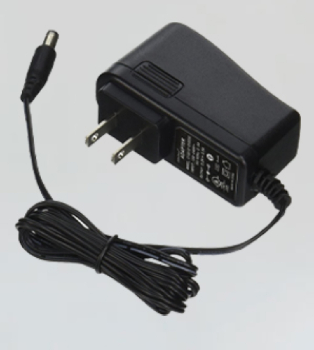

So I would buy something like this, use a scissors to cut off the end nub that would charge whatever it’s designed for, and a negative and positive wire should pop out of it?
Are they color coded so I know which is which?

Any old phone charger that is 5v will suffice, look carefully at the two wires the 5v/+ wire should have a stripe colour on one of them. But what one should do bare the ends put the probes on them and check for polarity, checking for polarity is one of the very basics with owning a meter. If one doesn't know then one should be asking themselves questions.
I didn't know but do now after a quick google :)
So I should;
1 - Pop into a phone repair store, buy an old charger and strip it

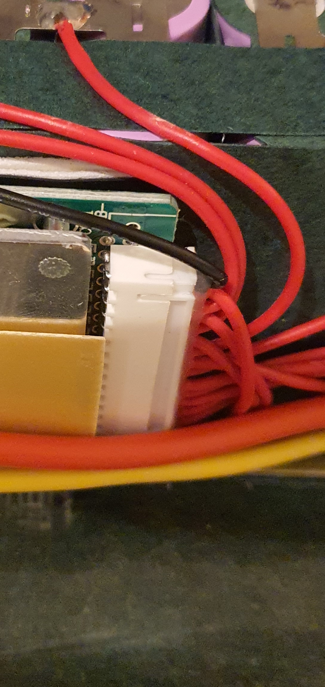

2 - Rip the JST off to expose it (this I am worried about as it's stuck to the component behind it - photo attached in next post again)
3 - Insert the negative wire into the 10th slot of the JST and the positive wire into the 11th slot, to charge the weak 11th series
4 - Test this series with a multimeter as it charges, and also touch it to ensure it's not overheating.
5 - Stop charging when series it reaches 4.16V.

JST seems glued to the green box behind it
If it is glue then try applying heat from a hair drier or heat gun to see if the glue is loosened/softened and then gently pry apart.
The White JST's are a very tight snug fit they aren't glued or stuck in, they are a two piece connector the female part is soldered direct to the PCB and the male part with the multi wires simply pushes in. Pry/lever it out gently a bit at a time from each side to remove using the wood or plastic tool, the joint is clear to see where to separate .
Personally if one is baring any wires then they need soldering or a pin from a pin strip added to each end to insert in to the hole. Bare thin wires are too flexible and will bend trying to insert the bared end, likely a fine strand will short against the adjacent one.
Without soldering I would use the magnet/washer method direct on the cell group, then the wires can't short as they are on opposite sides of the battery.

I found an old charger that has an output of 4.5-9.6V and 300-600ma, I assume this is no use and I need exactly 5v 500ma?
