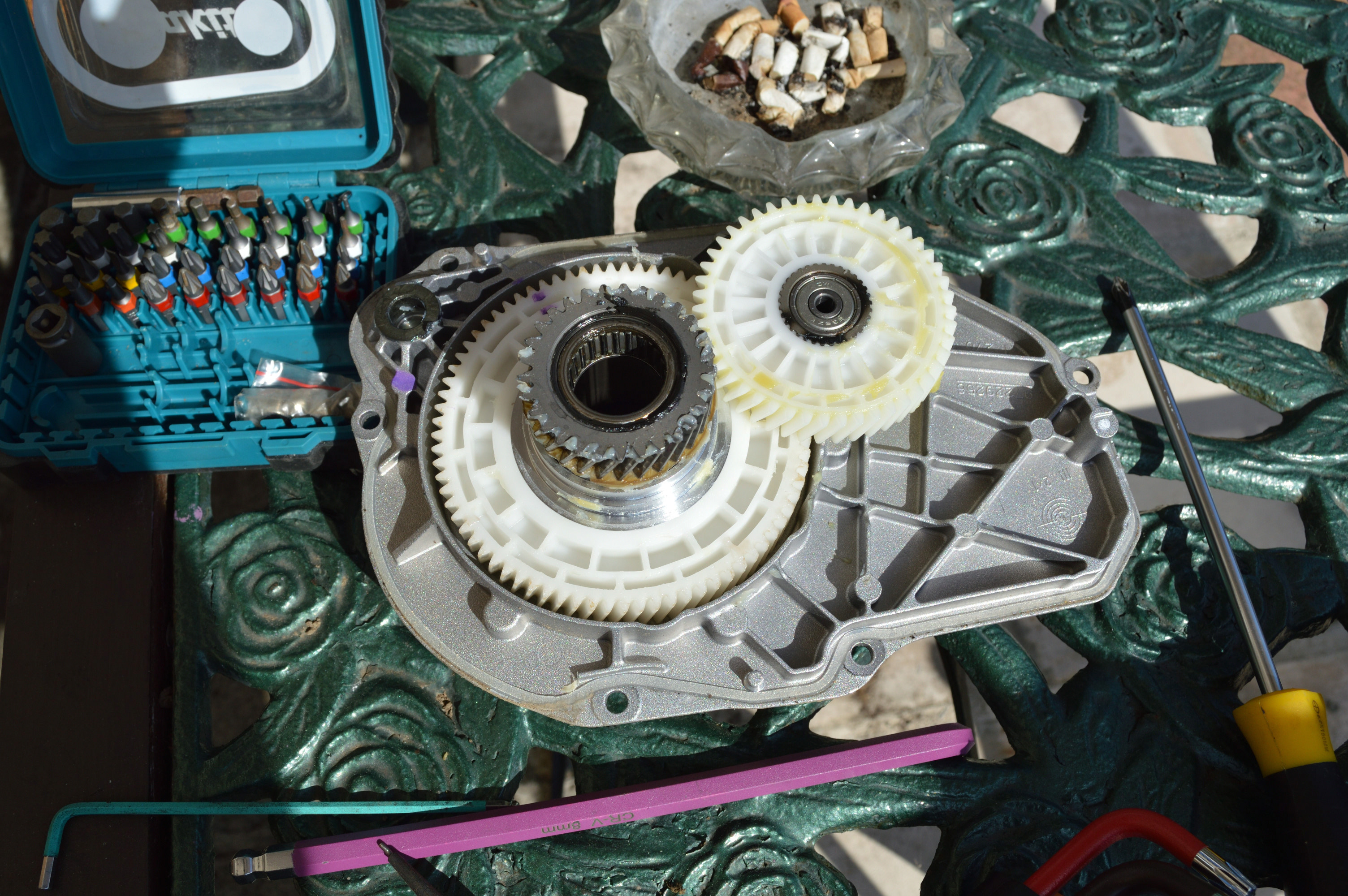

since i have had my bike i have never had any motor or batt problems even with a dongle fitted to remove the speed limit but dont ride in the rain if i can help it but i do hammer the crap out of it but after 7 years the bearings are worn and the transfer gear will also need replacing as pretty chewed up but peter can sort it for 160 quid and would be good as new but now have a cx motor so that is now a spare.
pic from a few years ago
pic this year
as you can see if i just kept going teeth would have started to fail at some point so these things will need a service at some point as nothing lasts forever esp with moving parts like this.

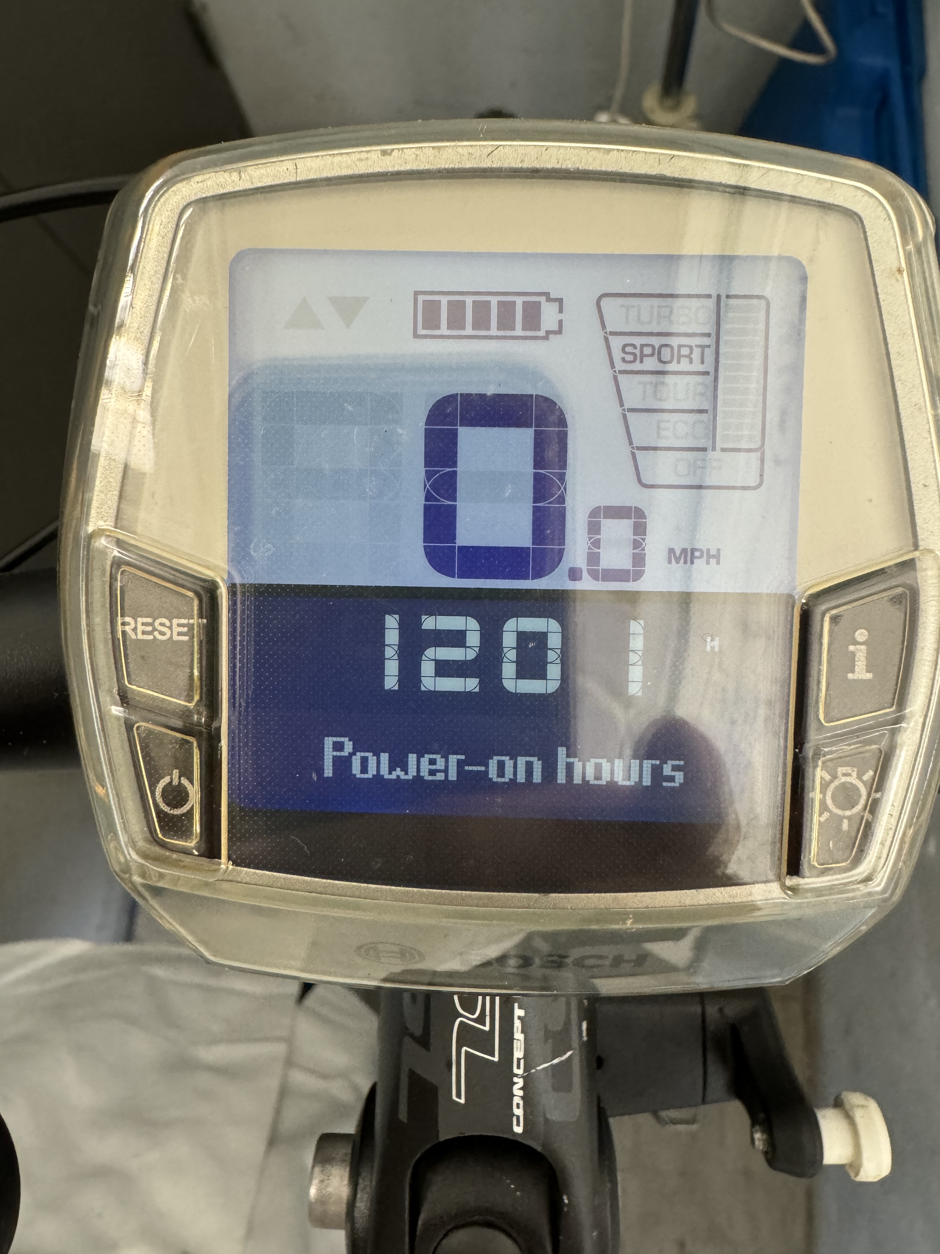

Just went over the 1200 power on hours in the 10 years I have had
Which equates to an average of 33 minutes cycling every day for the last 10 years.
