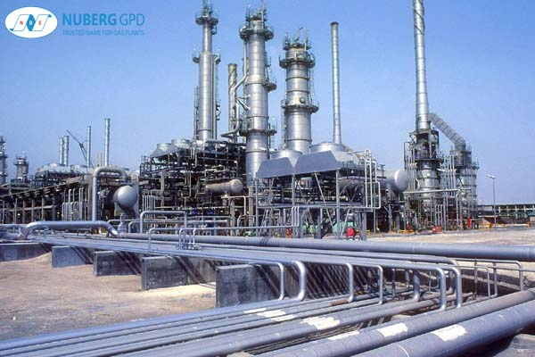

Steam methane reforming plant producing hydrogen. Guess what comes out of those chimneys.....
