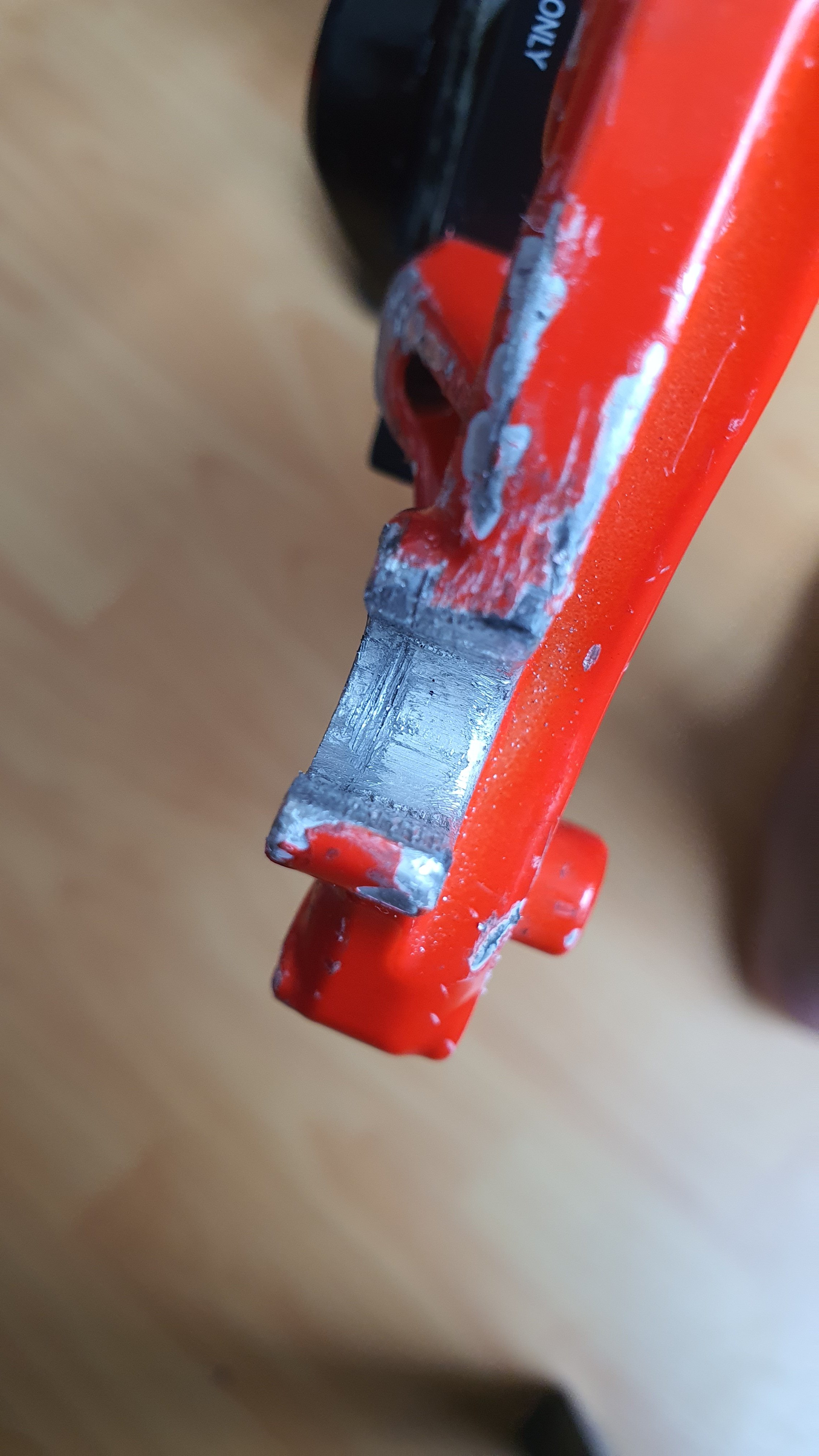

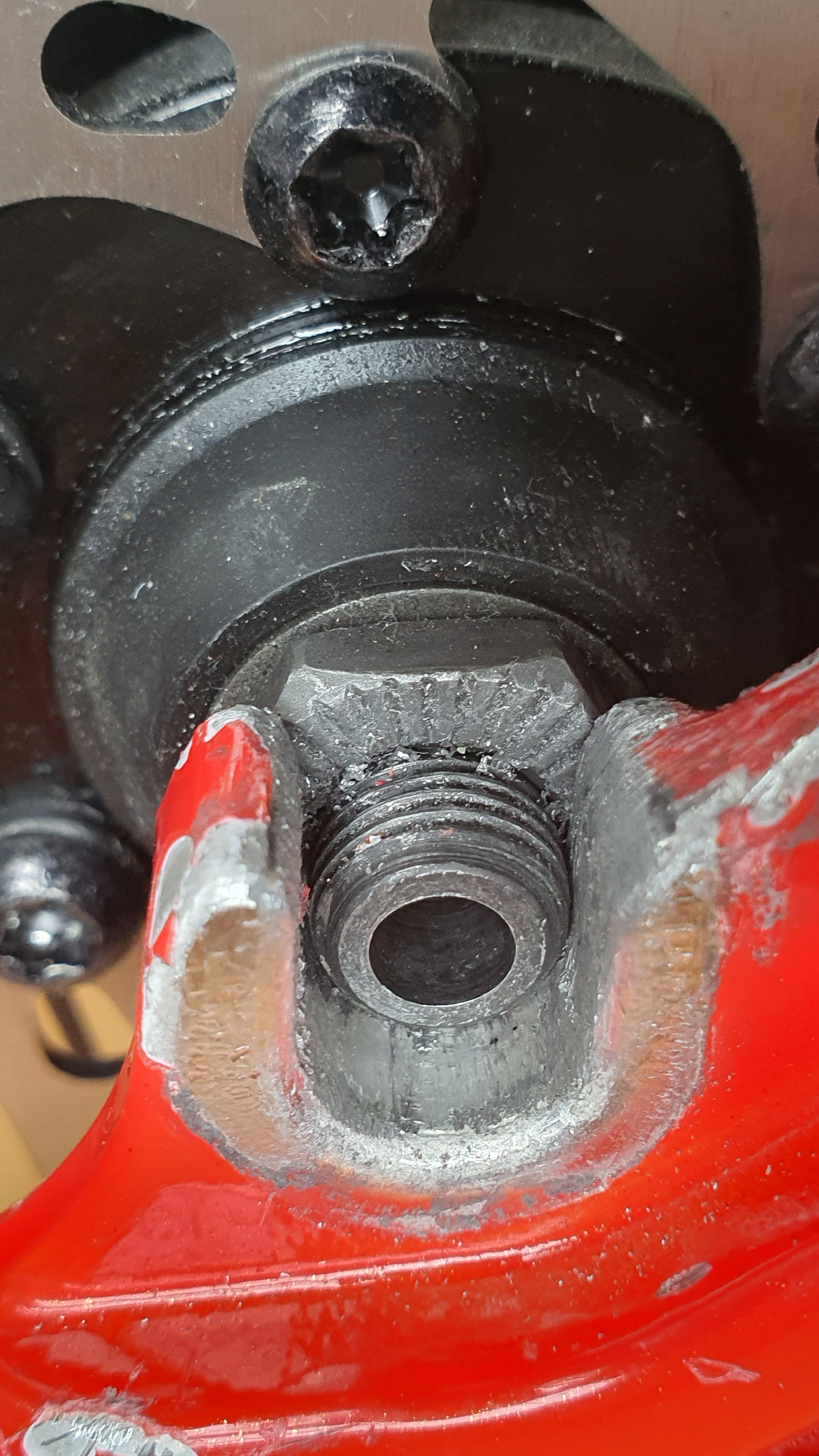

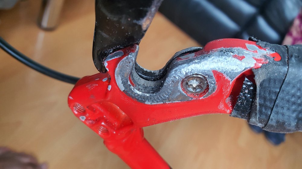

Hi I have a rear vertical dropout with a Rim that a Quick Release but the dropout has been worm is there anyway I can put a thru axle instead as the quick release one seems to not tighten and therefore when I pick the bike up the rear wheel falls I'm currently down for anything (except Quick release) I really want something sturdy but what is possible with my situation for example what is my options for this problem

Done please let me know if I can convert in to a thru axel or anything really I just need to make sure that rear wheel is sturdy and will never come off I don't mind if I have to use the bolt on way.

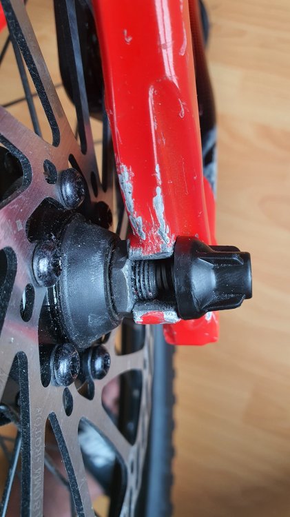

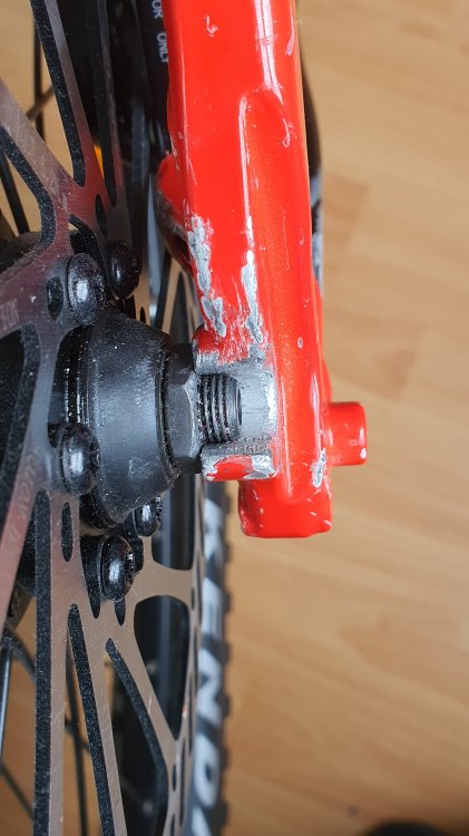

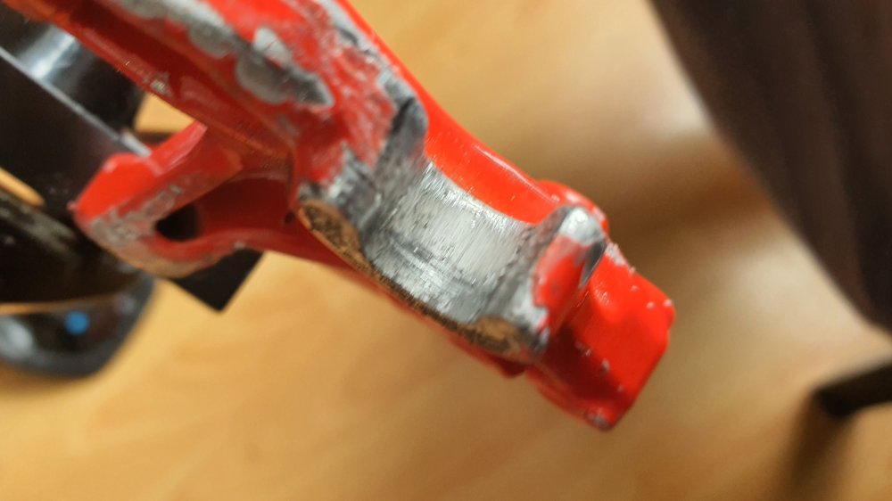

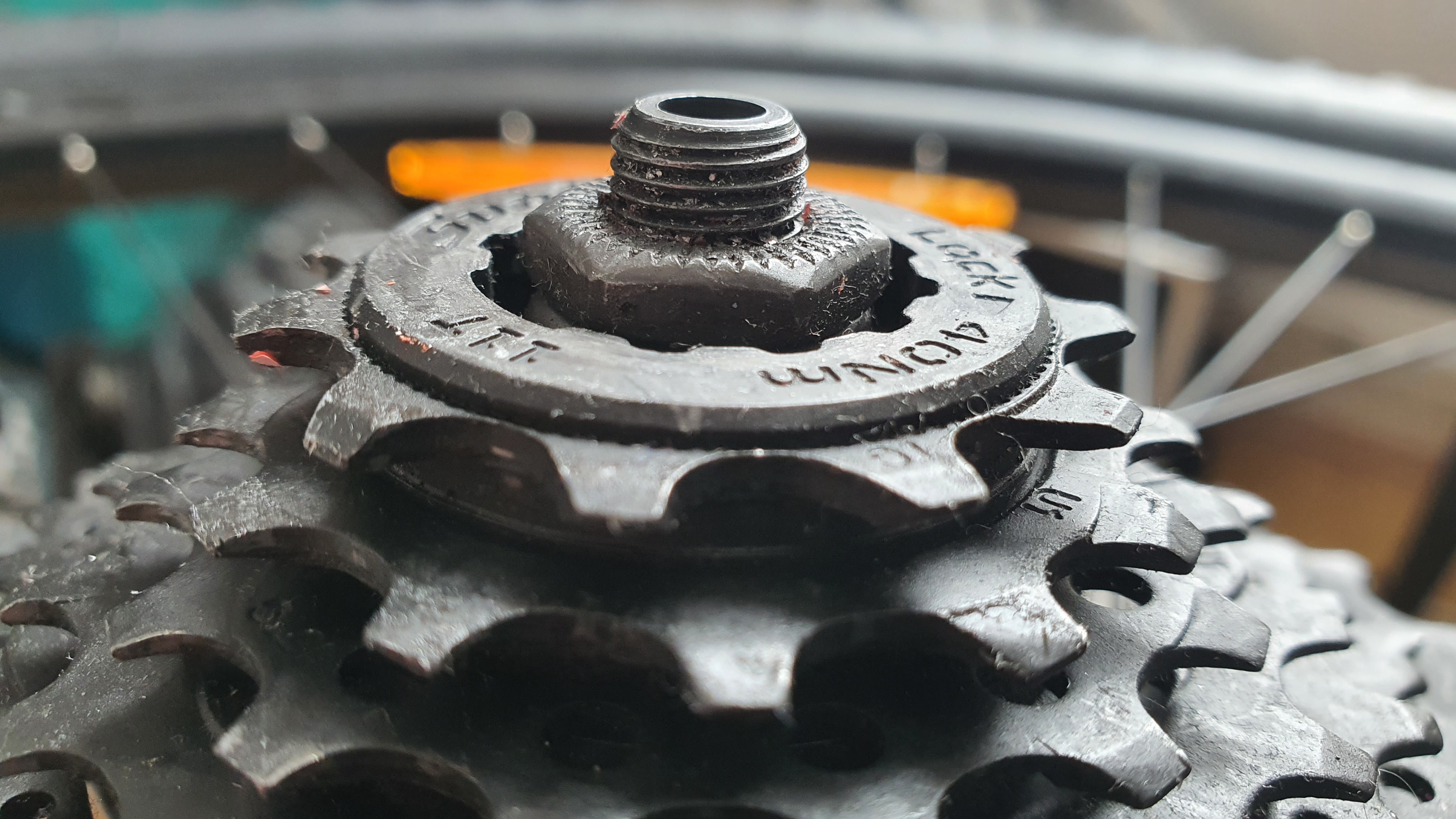

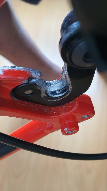

The axle seems to sit well enough in the frame, both sides, all surfaces are a bit worn but I have seen worse. If it is possible to improve flatness on the contact surfaces that would help.

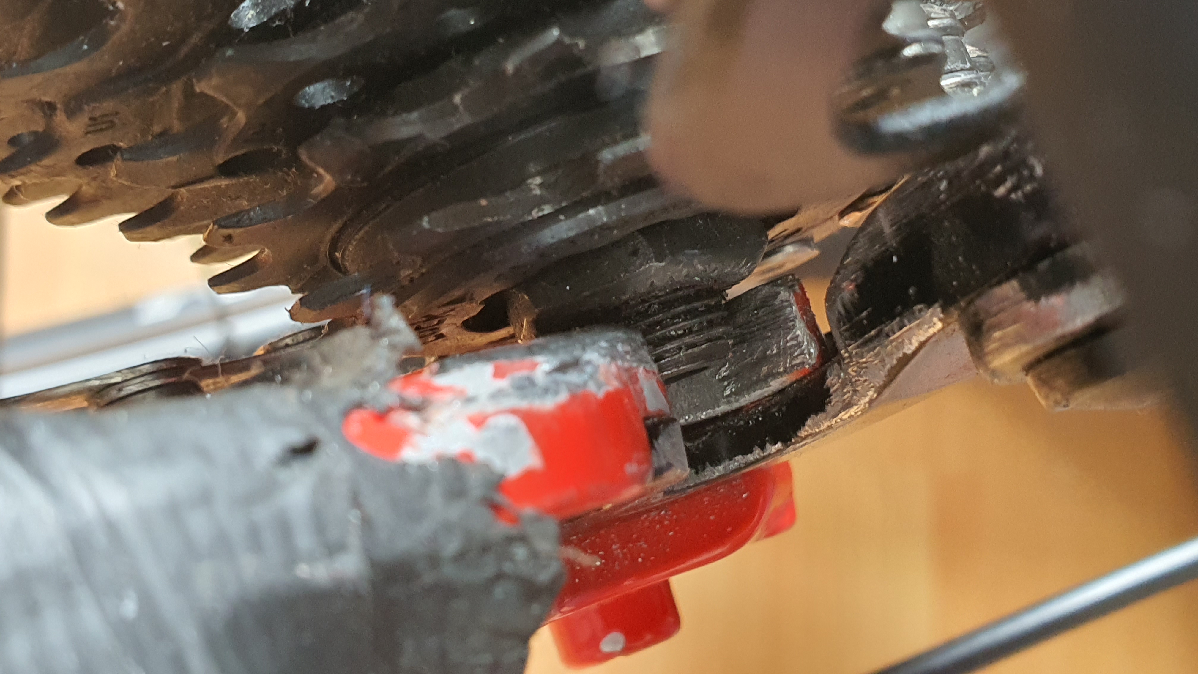

The derailleur hanger does not line up perfectly with the axle, so there is limited room for the nut to sit on that side.
I would be tempted to try a thick washer, big enough to cover plenty of frame surface on the drive side, and make sure you get plenty of compression in the QR action.
Is the QR itself in good order, I have had one in the past that wasn't applying as much squeeze as it should.
Go carefully until you are satisfied it is secure.

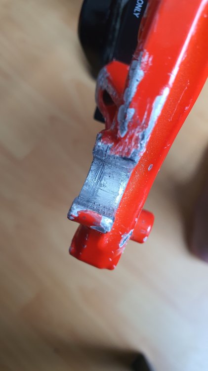

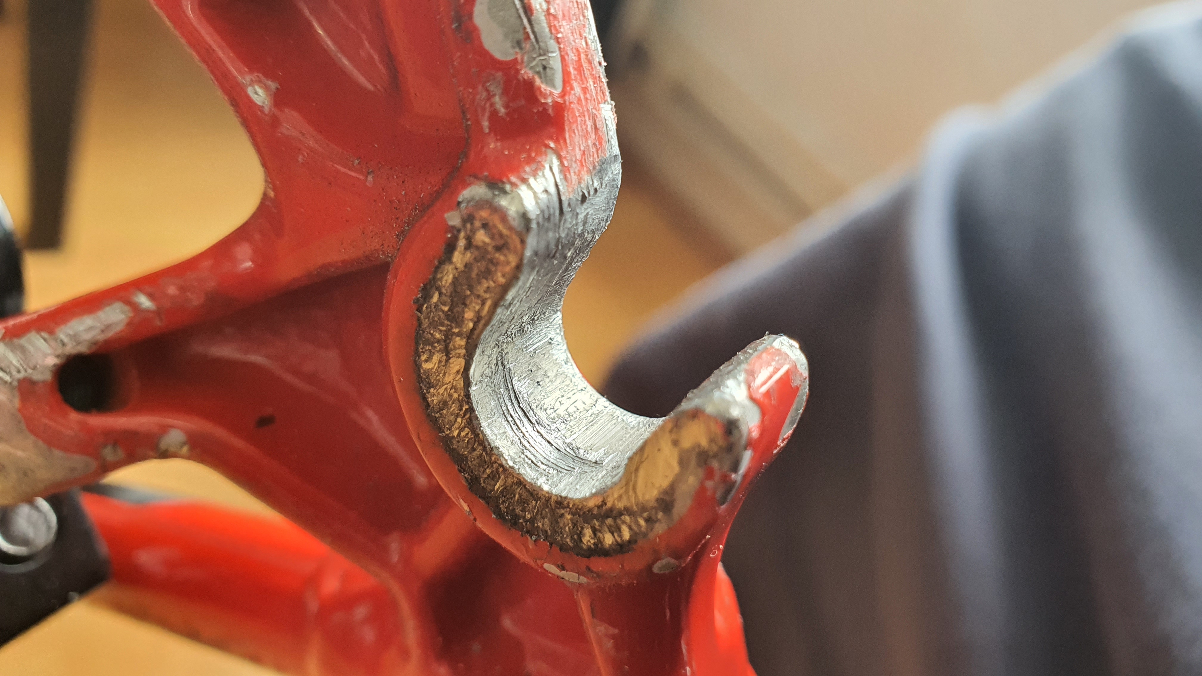

Drops outs look pretty worn to me, also brake side is missing a tension spring on the qr axle. The second pic the drop out face looks well mullered.
What do you recommend that I should do?
If that was my bike, I'd:
1. Try oiling the clasp mechanism on the QR, to see if that increases tightening. Like I said, I've found this worked on a couple of my old QR clasps.
2. Add washers as suggested in post #10 (possibly anti-rotation washers, because they're thick and strong) to the outer surfaces of the dropouts.
3. If 1. and 2. didn't work, I'd consider trying a ratcheting QR axle, after checking compatibility with the seller.
4. If none of the above worked and if it wasn't too expensive, buy a replacement secondhand frame.
Point 4. is perhaps a bit drastic!
Edited by guerney
That looks bloody horrible. You've seen worse? :eek:
Properly munched for sure. "Mullered" says it much better.

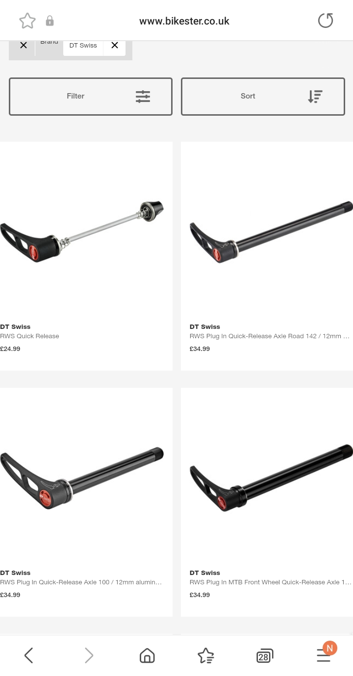

Do you know what size Ratcheting QR axle will fit
I'd find a seller and ask. And if it didn't fit after the seller had said it was compatible, I'd get a refund.
Which would I need? Is it the thin steel or the thick steel?
Screenshot_20220430-215514_SamsungInternet.thumb.jpg.0b08dbba9c1800e7aa759b465e3f20d5.jpg
Measure the one you have, double check with the seller - if you pay using Paypal, they will nearly always side with the buyer and issue a refund.
But if your dropouts are too worn, a new ratcheting QR might not sit straight when tighetend up, unless you add thick washers as mathewslack suggested in #10.

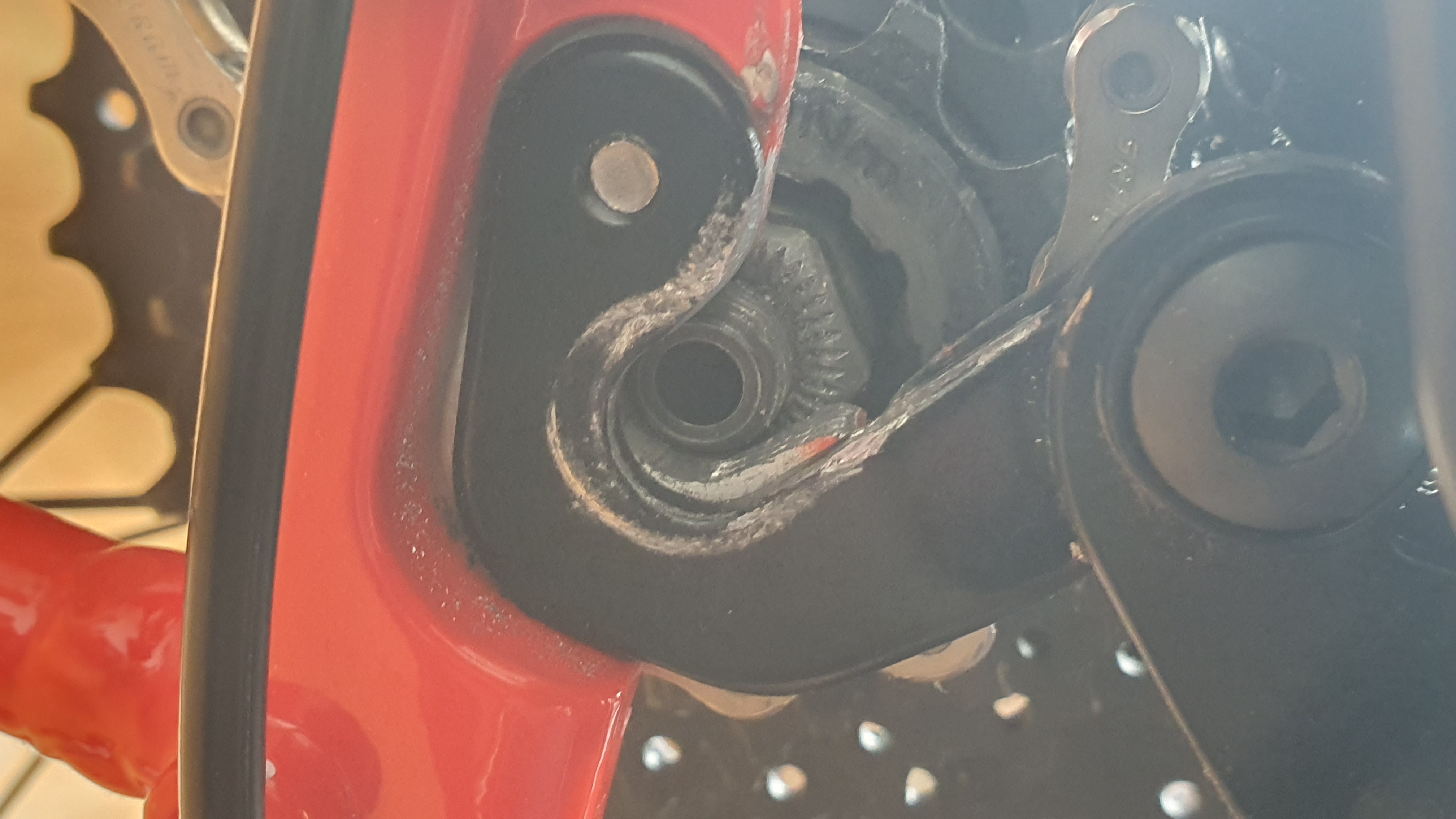

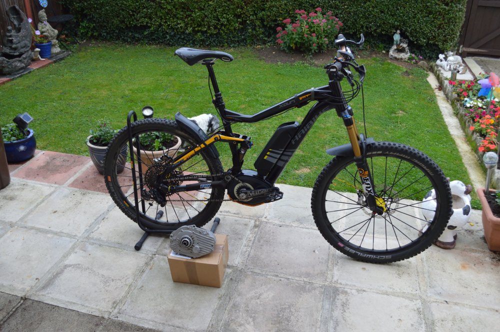

tho from the pics of those drop outs id say it is done its just worn to much and will just get worse as the motor axle is not even in the drop out and just sitting on the mech hanger and that is only held on with one bolt and if that falls out the motor will fall out the frame and big crash.
Holy sh*t :eek: in that case Abzy should hold onto his money...
Mind you, it does look to me like the motor on that side is resting on the frame dropout:
