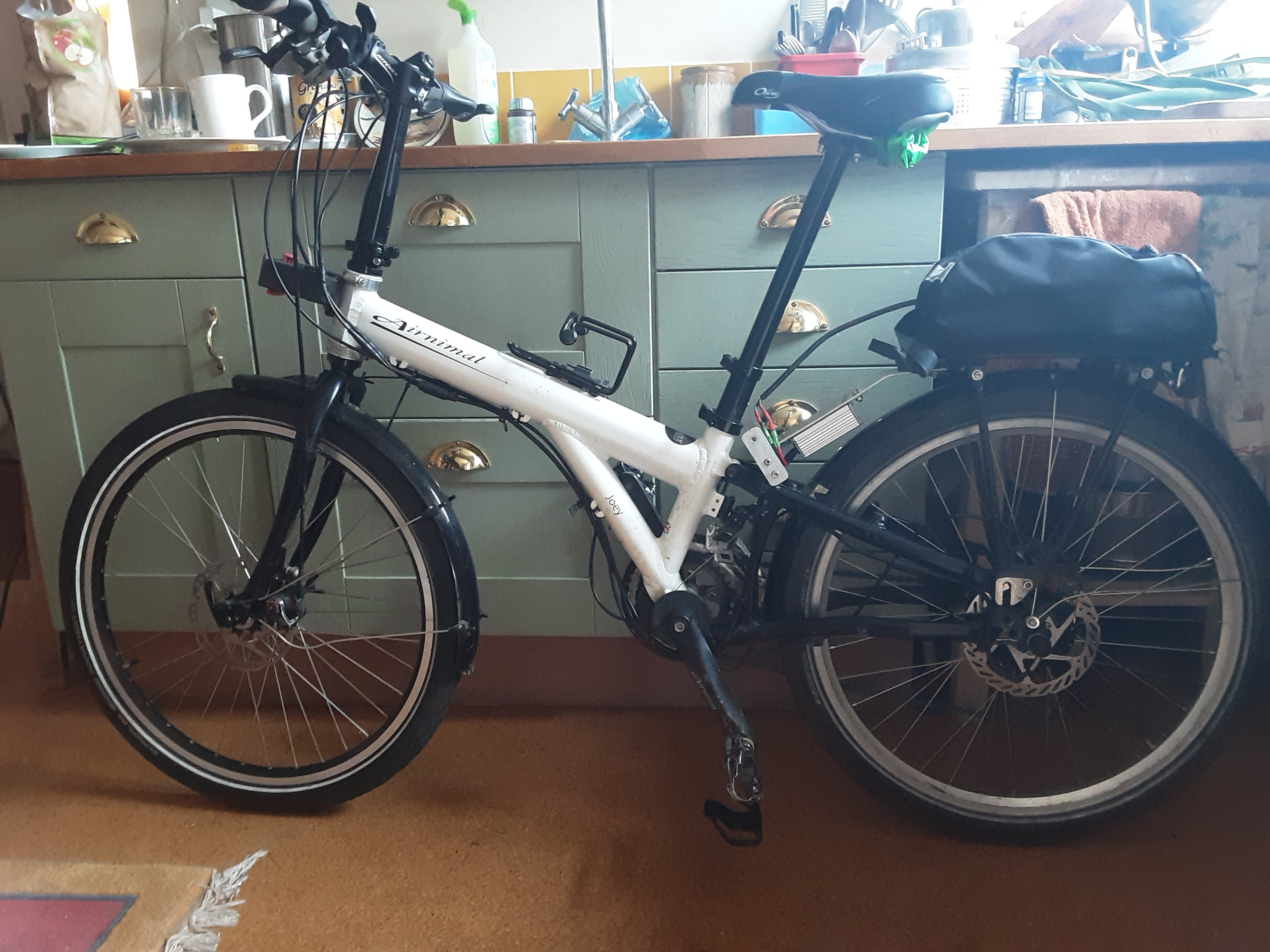

May 11, 20223 yr Many thanks. Problem now solved. I ended up looking inside the controller to identify the pins. All the pins except the black in the PAS and the throttle had the live and the signal wires the wrong way round. The 2 3-wire connectors were made by Lerner not julet. In case anyone else has the same issue here are the id's Julet 8 pin 1T2 female connector at the controller: Looking at the end and going clockwise from the 1st pin to the right of the locator nib. 1 white 2 Green 3 yellow 4 blue 5 red 6 purple (or brown as couldn't see easily) 7 grey 8 black The pins at the female connectors at the other ends are (using same id system): Throttle: 1 purple +5V (ie joined to pin 6 at controller connector) 2 black ground 3 grey LCD4 display 1 red +36v 2 black ground 3 yellow (RX*) 4 Green (data*) 5 blue (control*) * decription obtained from a photo on the net by Curt Welch I did not blow anything up when I had the live and the signal wires the wrong way round on both the PAS and the throttle thank goodness. I'm now back up and running with my new motor in the back wheel with more oomph than the previous little AKM85 in the front wheel.
