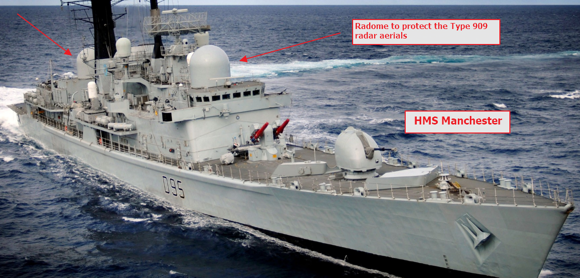

Wow. What the devil was that radar system? :oops:
It was the Marconi made radar type 909 used to guide the Seadart Missiles found in the Type 42 (Sheffield Class) destroyer. The radar beam could in good sea conditions track a one metre square test target to in excess of 70 miles - when I say 'track', that's knowing it's postion within +/- 10 metres iirc - the best I ever got was something like 80 miles on a good day.
The radar beam was a hazard to health and the directional aerial system had a dedicated mechanical system of cam operated switches to ensure the beam did not irradiate crew on the upper deck and it was not allowed to opearate in harbour or when steaming close to other vessels.
This was early 80's technology - no microprocessors even - mainly TTL logic and discrete components - I learnt a lot in my 2 years in that ship but of course it's old hat now.
