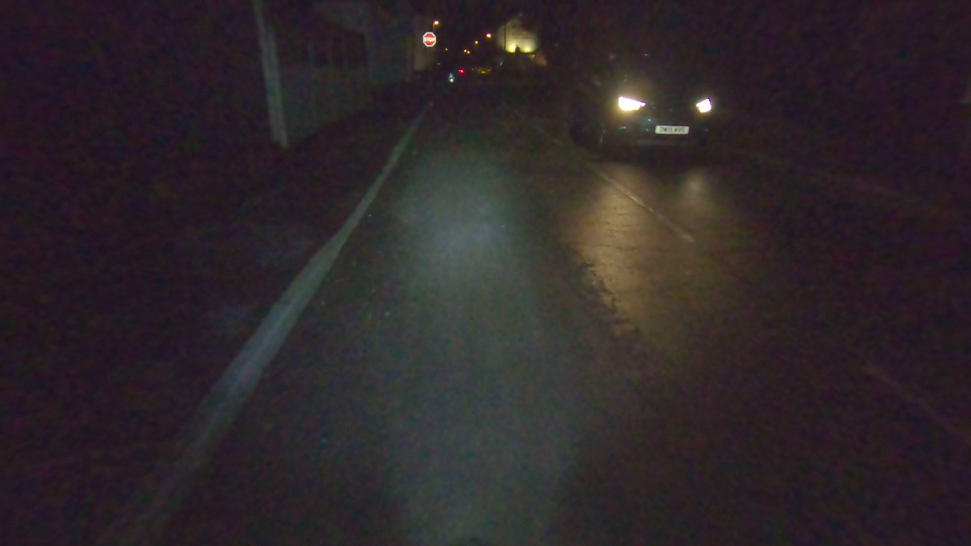

As I spectulated on these forums some months ago, control over shutter speed may well be key to capturing clearer views of vehicle number plates at night (something my cheapo Crosstour 4K lacks) - there is much less motion blur, but oodles more noiose because of such high ISO... but I'm pleased to report that ISO 1600 and shutter at 1/240th of a second, is more often than not, capturing large sections of, or whole number plates - these screengrabs from video don't look cinematic, but that's not what want from a cycling-flight-recorder-in-case-of-horrible-accidents.
When passing fast and close:
When passing by fast (from a brief period of shooting @ISO 800):
Also a fast pass (ISO 1600 again and hereafter)
It appears I can even get some plate info from approaching vehicles, if they're close enough to the beams of my headlights:
I'm not managing to capture 100% of passing numberplates, I'll do a proper calculation at some point, but it's much more often than not.
Well, there you have it - if you own a GoPro Hero 7 Black or similar action camera with full manual control of the same era or newer, it's quite likely that you too can capture number plates while cycling about at night.

If you can get control over ISO and shutter speed, I think your camera is likely capable of doing the same - they just didn't built control over shutter speed into my cheapo Crosstour 4k, I'm pretty sure it could have done this too. Kudos to GoPro for including full manual control over settings, instead of making a camera which pleases just surfer dudes and bras showing off - but there's auto mode for that, which works great in daylight.
Can't say I've seen it on the GP4 maybe in the app if there is one...
Is yours a Black version?
https://gopro.com/content/dam/help/hero4-black/music-bundle-manuals/UM_H4Black-Music_ENG_REVB_WEB.pdf
...if so, you don't have direct control over the shutter and can't use a set value, but you can force the camera to use faster shutter speeds (selected by the camera automatically for the scene, changing with scene lighting conditions - allowing the camera to select shutter speed dynmically can lead to bad results on many cameras - the algorithms vary in effectiveness, also limited by CPU capability) by locking ISO max to say 1600, and lowering Exposure Compensation. It's on page 72 of the manual. Sorry to say, it seems your GP4 operates in rather the same way as my Crosstour 4k, but if your GP4 sensor and software is better, you should have more success than I did.
Edited by guerney
