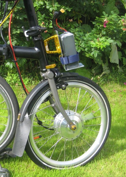

For my eBrompton I am currently moving the battery from a handlebar bag to one on the front baggage block. The weight of the battery is taken by an aluminium bracket.
A bag will then be fitted over the aluminium bracket. The same approach could work with a Bosch battery, with the holder fitted to the bottom of the aluminium bracket. The bag I am using for eBrompton would take the Bosch battery too;
