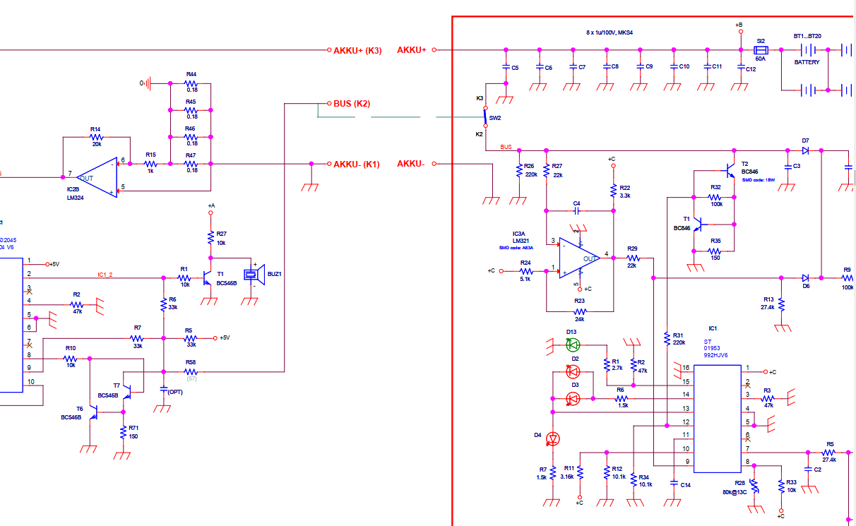

I found a schematic which shows the combination of the ALl3640CV 36v charger connected to a 10S2P 2.6Ah battery.
The centre connector is clearly labeled BUS (K2) and from the schematic it does appear to be how the battery communicates with the charger.
But also shown is a switch SW2 which links the BUS connector to Chassis\GND, this is what would happen when a solid blade is inserted into the central connector. But if 'SW2' is made then there cant be comms between battery and charger via the BUS.
Battery fuse is shown as 60A.
