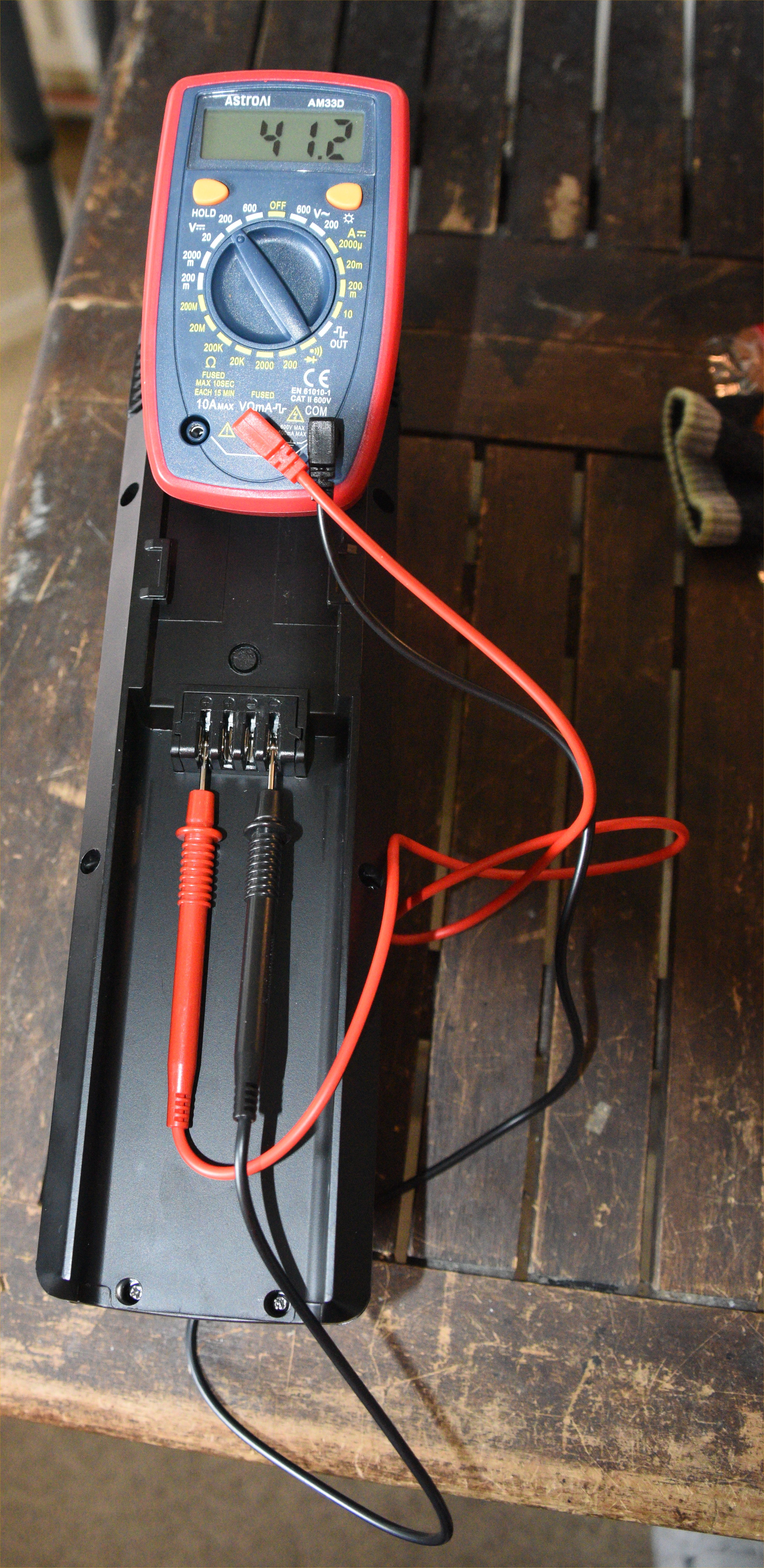

A voltage meter , simply turn the dial to DC 200v and probe the +/- output of the battery .
It should give the battery voltage reading.
Yes either will be fine , the DC scale is the white scale to the LHS of the dial.
As with all meters DC LHA , AC RHS.

Take a reading from the outer marked +/-, it doesn't matter which way around the meter probes go in.
In fact do the test by swapping the probes over to learn how correct polarity works, when the polarity reading is wrong you will see the voltage reading with a minus in front of it.
If you're new to electrics don't use the meter terminal marked 10A / mA10A yet. With a battery, work slowly in good light in a comfortable position, and if anything isn't what you expect take a moment to think it through or read up. Maybe steady both hands on a surface and move one probe at a time like a pen.

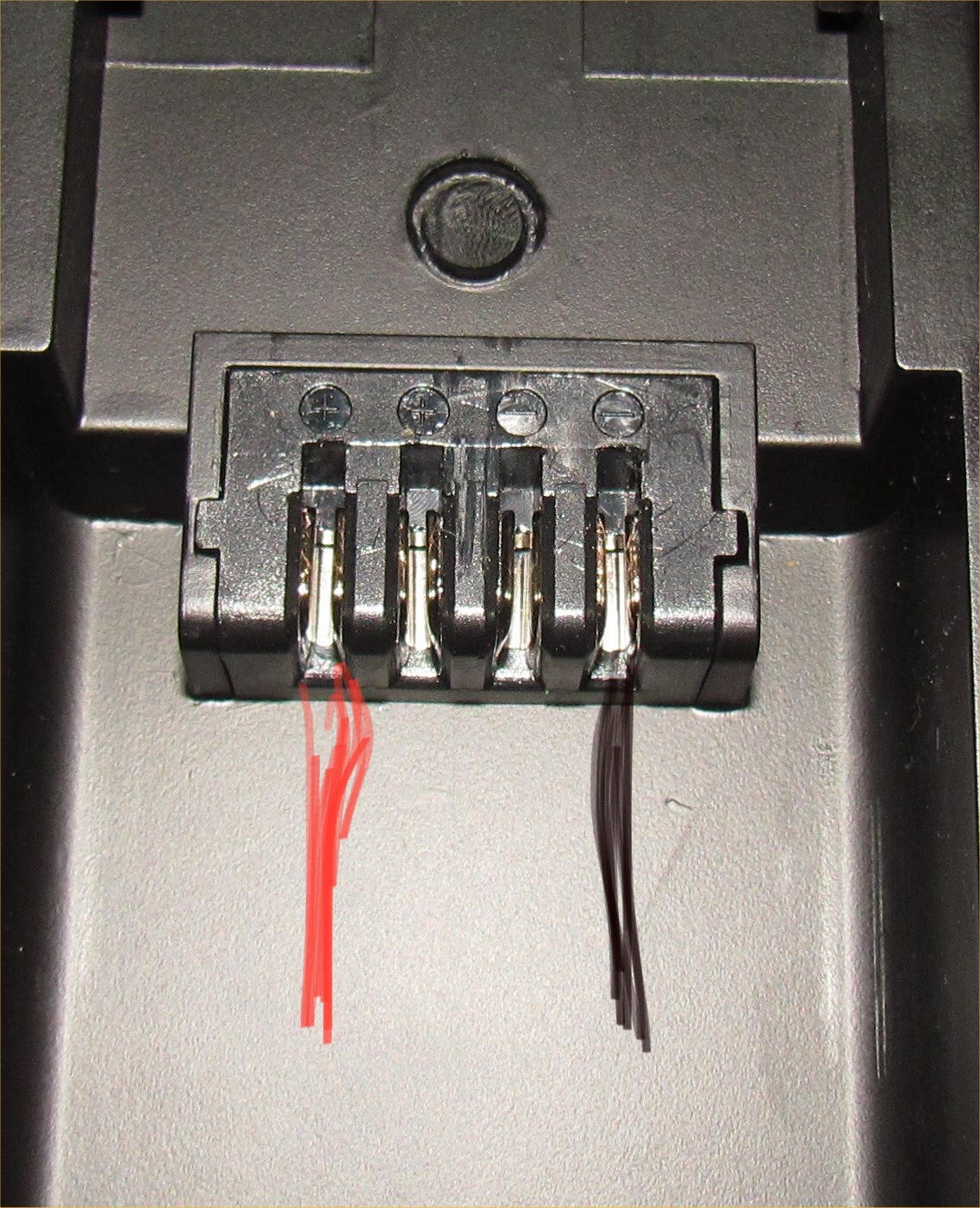

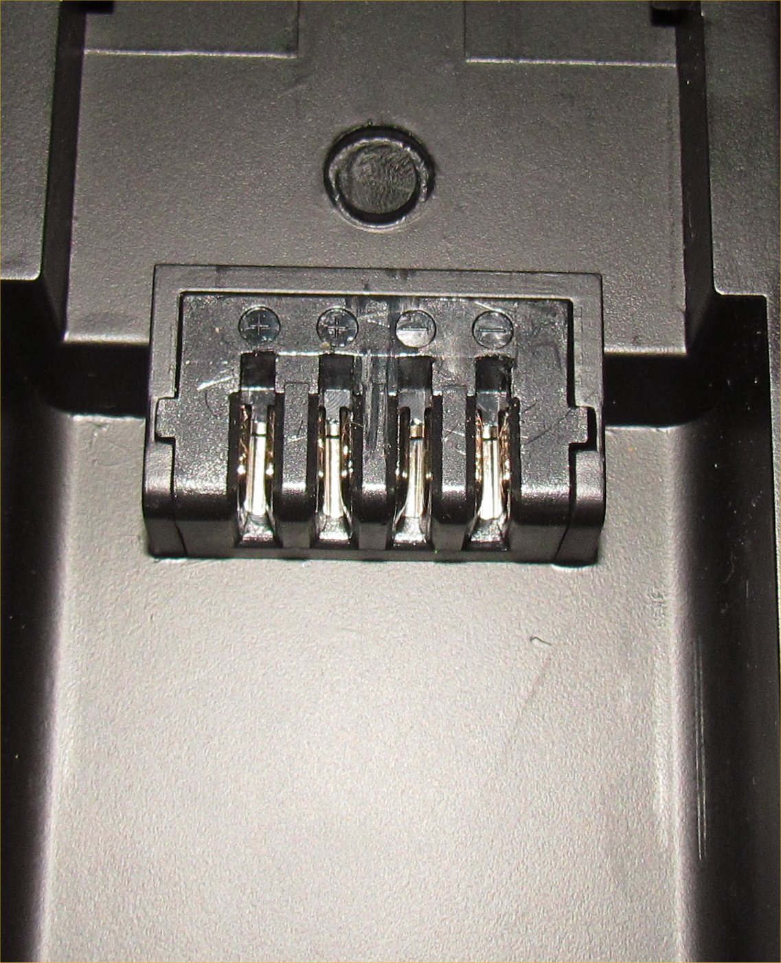

[ATTACH type=full" alt="Img_1817.jpg]58351[/ATTACH]
looks like someone has been in there with a flat blade screwdriver to 'adjust' the inner 2 terminals a little more than the outside 2?? though it could be a camera angle/light thing??

The terminals look blackened. It's best to turn the battery off before sliding it into or out of the battery mount, else there's a spark, which blackens terminals.
I use a very tiny drop of 99.9% isopropyl alcohol on a bit of thin folded tissue paper or cotton bud to clean those battery contacts, and the contacts on the mount. Liberally use too much, and you risk isopropyl leaking into the case.
I think you're right. The inner two contacts do look adjusted.

WOW !!!!!!!!!!!
Blasted amazing, I have learned so much £8, and it worked, thanks for telling me HOW, it was a lose connection on the 4th terminal thing, I closed the gap and amazing, thanks again
