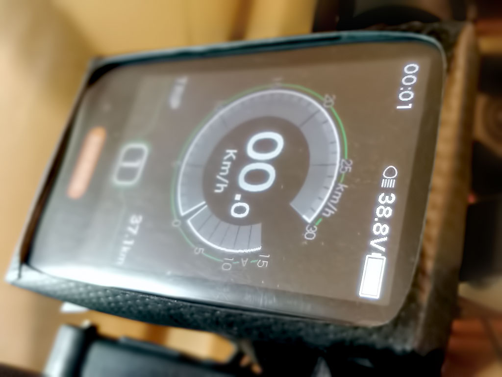

I don't trust waterproofing claims made about anything. I've left my Bafang BBS01B mid-drive conversion standing in rain on it's kickstand for hours many times while out gardening, I've also cycled in sustained heavy rain for hours and 43 miles, my motor has also survived complete submersion over both pedals for 13 seconds, when a pond appeared in the road after a sudden thunderstorm, and my bike created a bow wave pedalling through with assist - and that's the magic of silicone sealant between mating surfaces of controller and motor, between both sides of the gasket sandwiched in between. I admit it's not a perfect solution, but it certainly works for me. What also works for me, are liberal coverings of connectors and connections with marine 4:1 self adhesive heat-shrink and self-amalgamating rubber tape, and a rain hood for the display. 4:1 gets it over so many different connectors, and not just on the bike! I use the stuff for audio connectors too, to reinforce the exiting flexes, which otherwise usually fail first. It sets quite solid, but still flexes a bit if narrow, and can be set into a shape while still hot. I've soldered the battery wires to the controller directly. It's electric, why let water in? It's crazy.
That shock pool-like puddle took me completely by surprise - I was doing about 10mph around a bend and suddenly I was in it.... I had a bit of momentum after the rapid slowing after splashing in, and knowing that route, had already geared down in preparation for the long queue at the lights beyond the bend... so standing on the pedals (first time I'd done that on my Dahon, bit awkward on a folding bike)(there were cars behind me), managed to power through assisted by pedal assist.
And my display has a DIY rain hat.
slightly-prettified-waterproof-cover-display.thumb.jpg.9f28beabe6df9d9f517685f6e4285ebb.jpg
