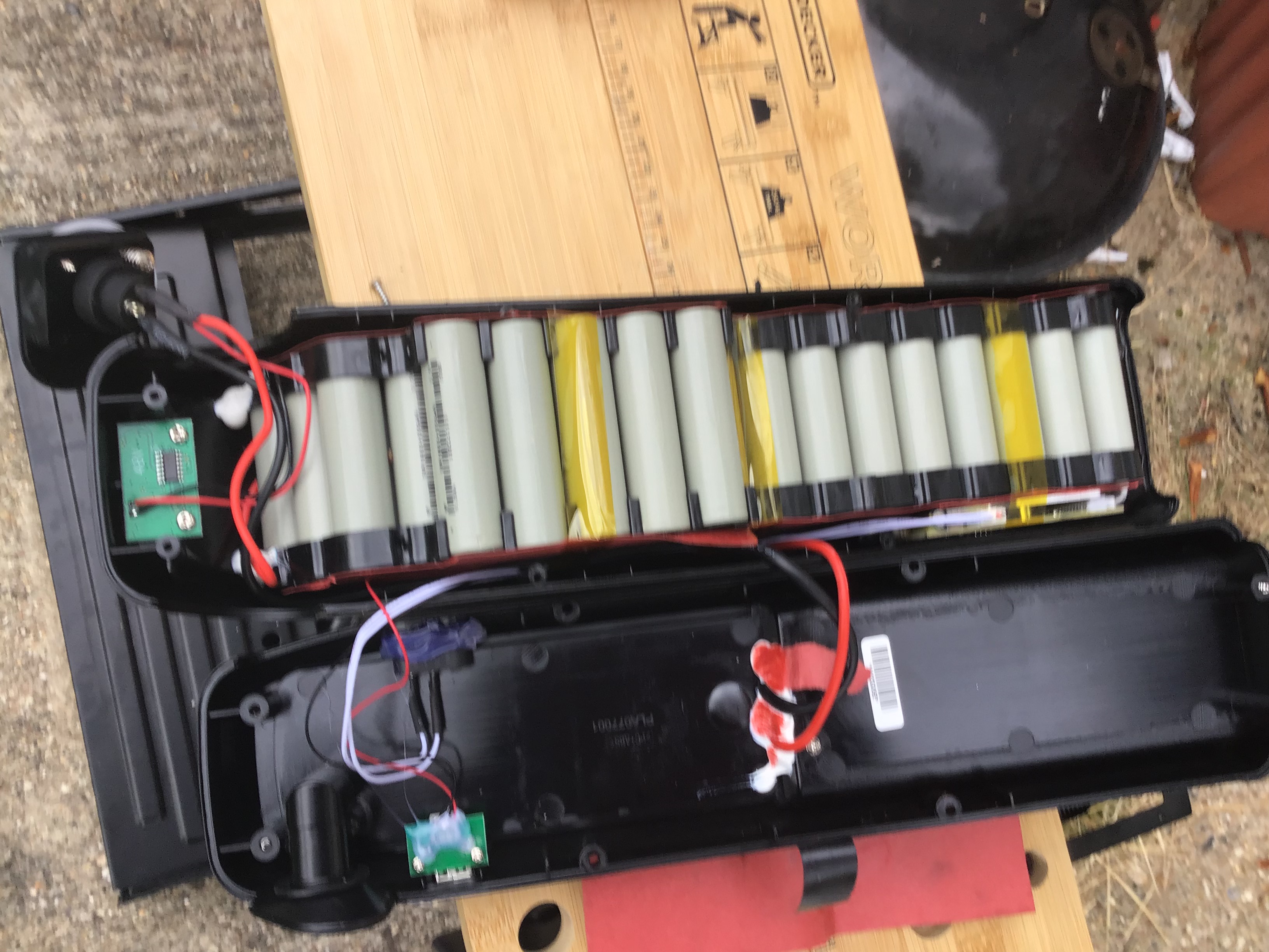

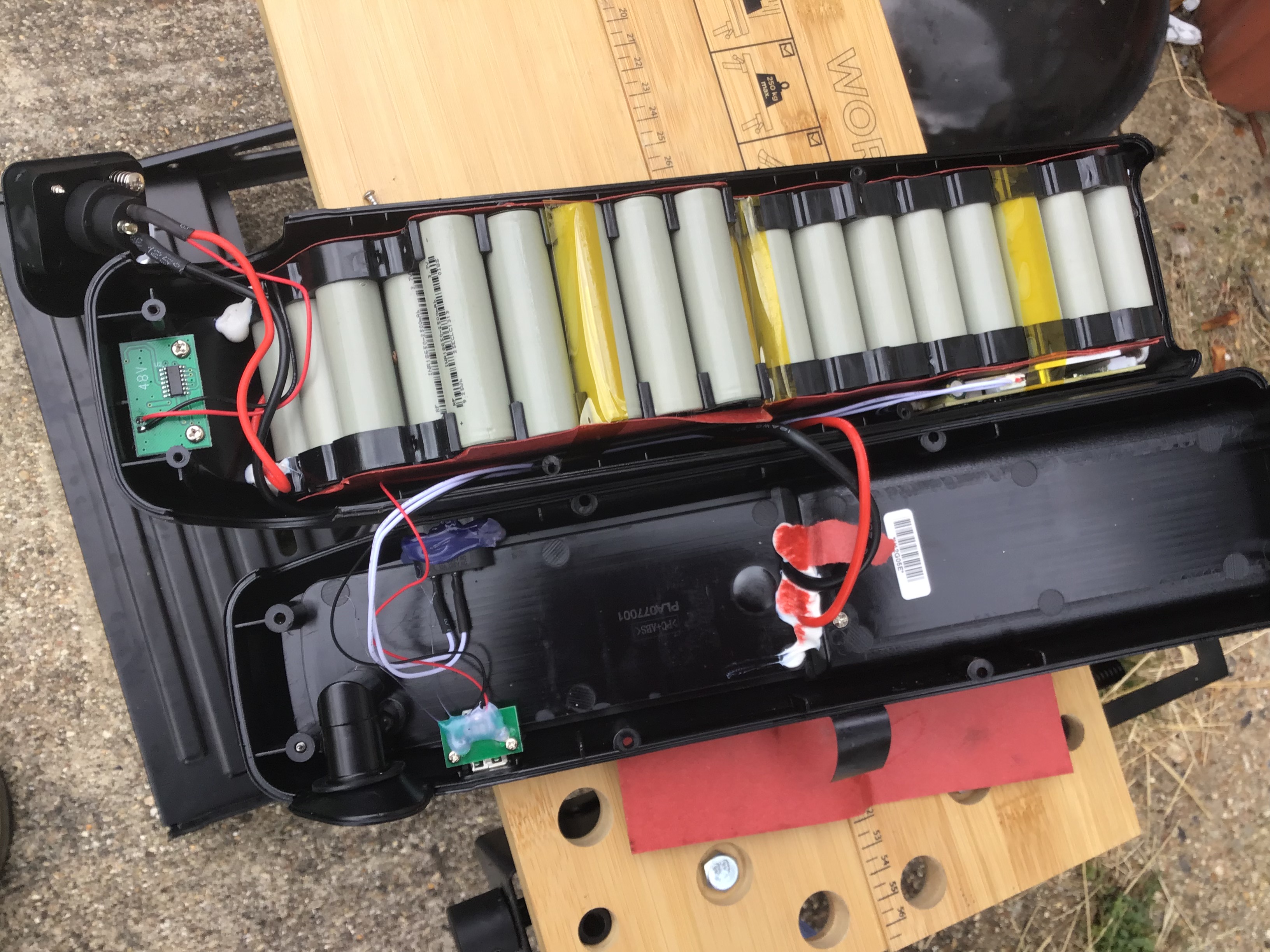

Thanks saneagle, Just looked inside the battery cannot completly free inerds from the case seems to be some bonding between inerds and case.
Cannot see anything obvious, nothing smells burnt,
Cant see the bms properly, No wires appear loose,

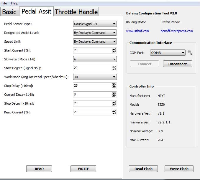

When the 36V BBS01B controller limit was 15A, keep current at 100%, and using maximum assistance all of the time, I used to get 43 miles max from my 19.2Ah/691Wh LG MH1 18650 celled battery ≈ 16.1Wh per mile over mixed terrain. My bike's wheels are smaller than the OP's. I'd be interested to see all of the OP's settings, either export of configuration file or screenshots of configurator.

BBS range is all about the keep current and adjusting to max will have an effect on range.
My old BBS01 I use to manage 52 miles from the 14.5ah battery , KC though was set at a modest 20% by Woosh.
I think they're all set like that by Bafang. Here's a screenshot my original "Keep current" I've kept stored...
