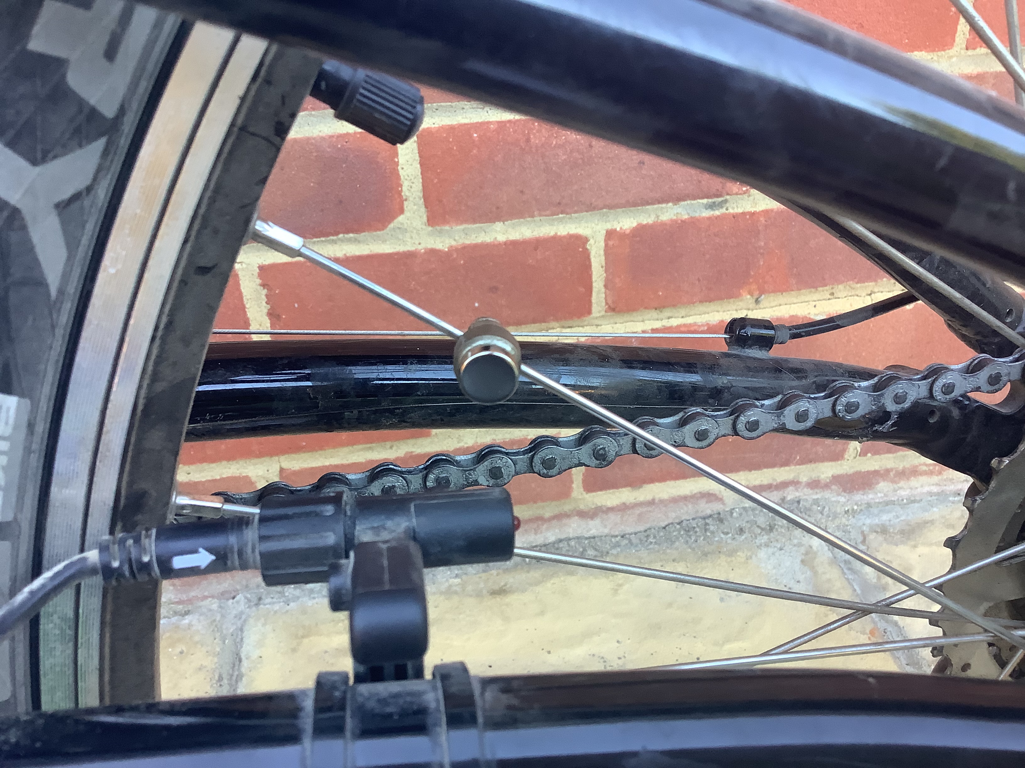

August 10, 20241 yr On mine the display will time out if it doesn’t see a wheel speed signal after 5 minutes. The time out is adjustable on the display. I use 2 magnets for the speed sensor to increase the magnetic field.
August 10, 20241 yr Might have been some other kit I was thinking of, might even have been on ES, I'm probably recalling incorrectly - can't find the thread. On the BBS01B: if the PAS is activated but thre's no speed detection via speed sensor, an error is shown on my DPC18 display. If neither PAS or speed is detected, the display automatically shuts off after 3 minutes - that's a user definable parameter in the display. Turning the battery off and on again resets.
August 10, 20241 yr On mine the display will time out if it doesn’t see a wheel speed signal after 5 minutes. The time out is adjustable on the display. I use 2 magnets for the speed sensor to increase the magnetic field. [ATTACH type=full" alt="IMG_0080.jpeg]59308[/ATTACH] 5 minutes! My Shimano doesn't give me 5 seconds! This starts to sound a likely cause.
