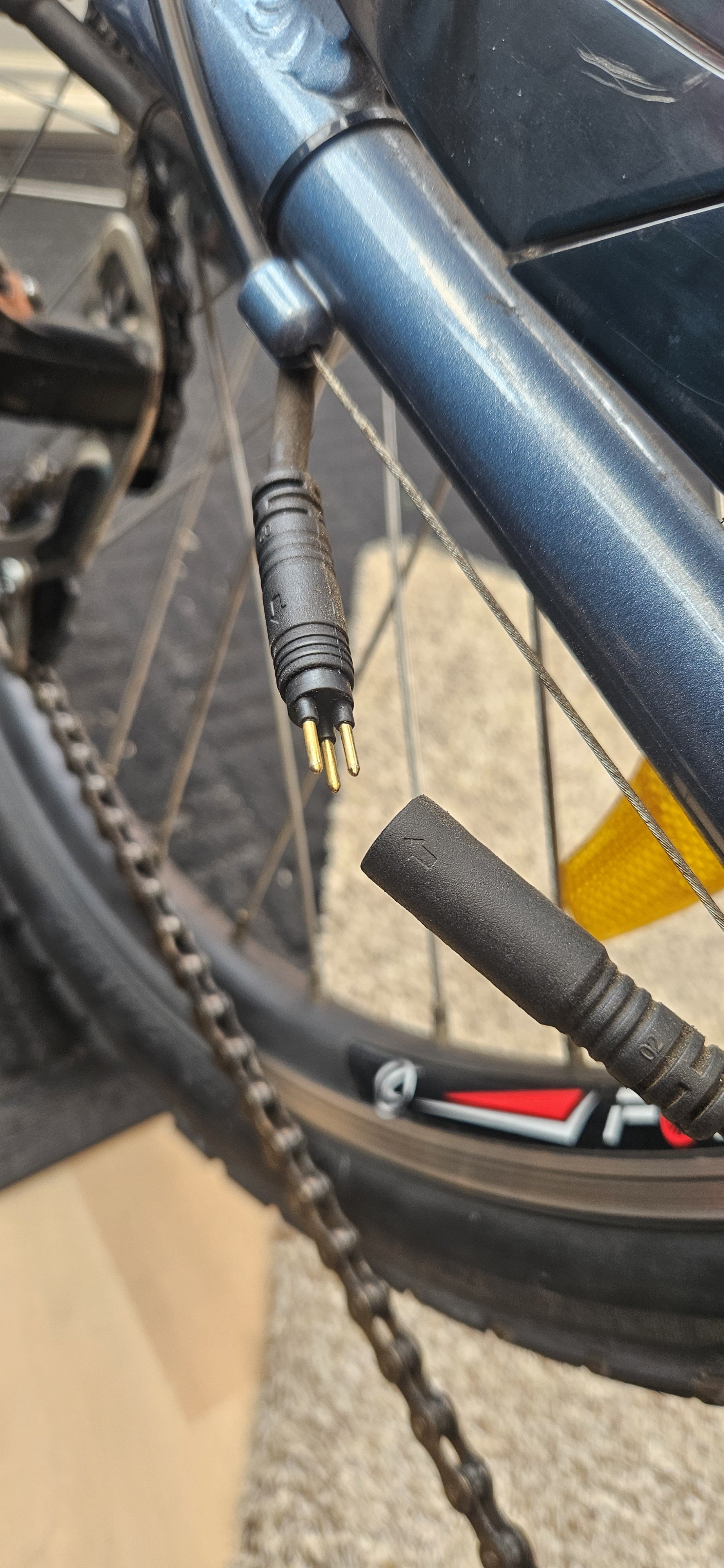

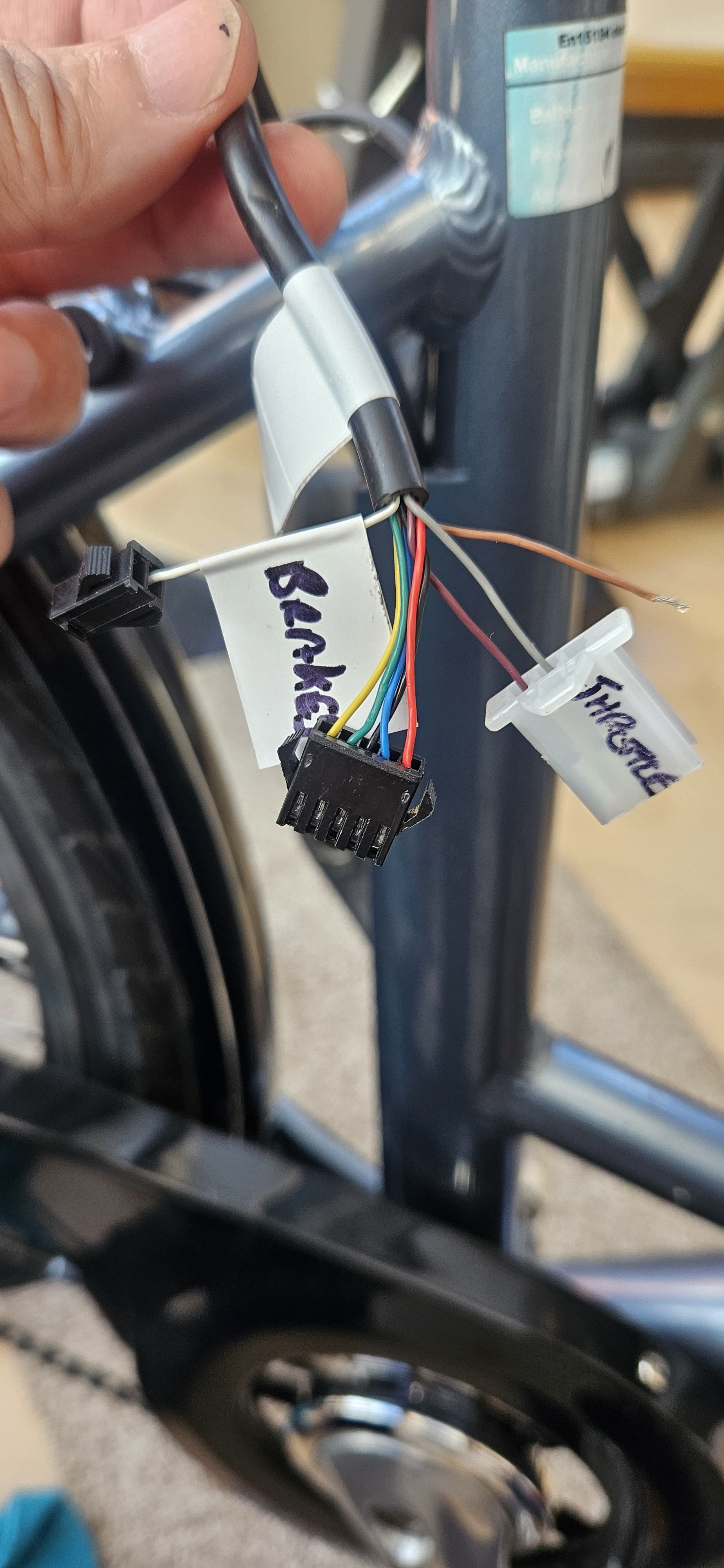

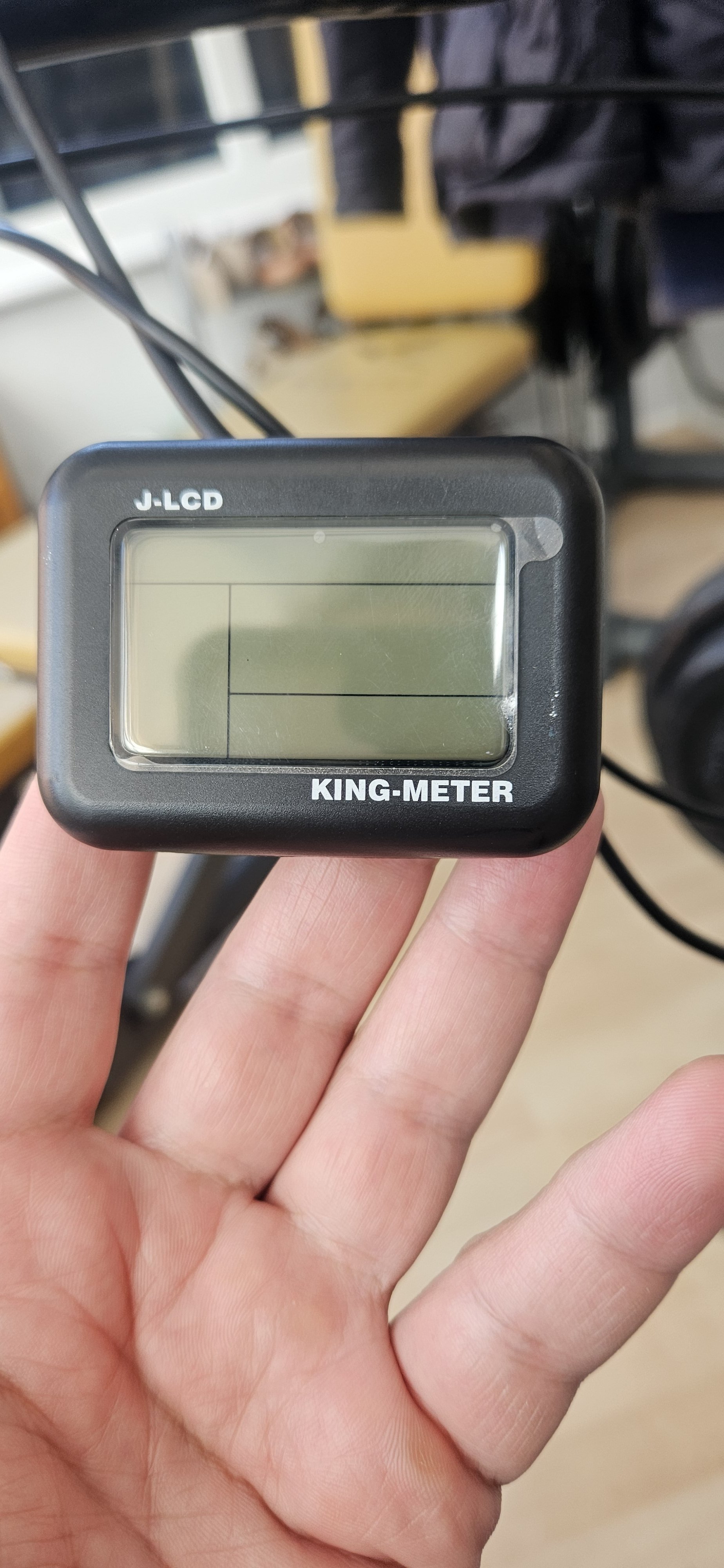

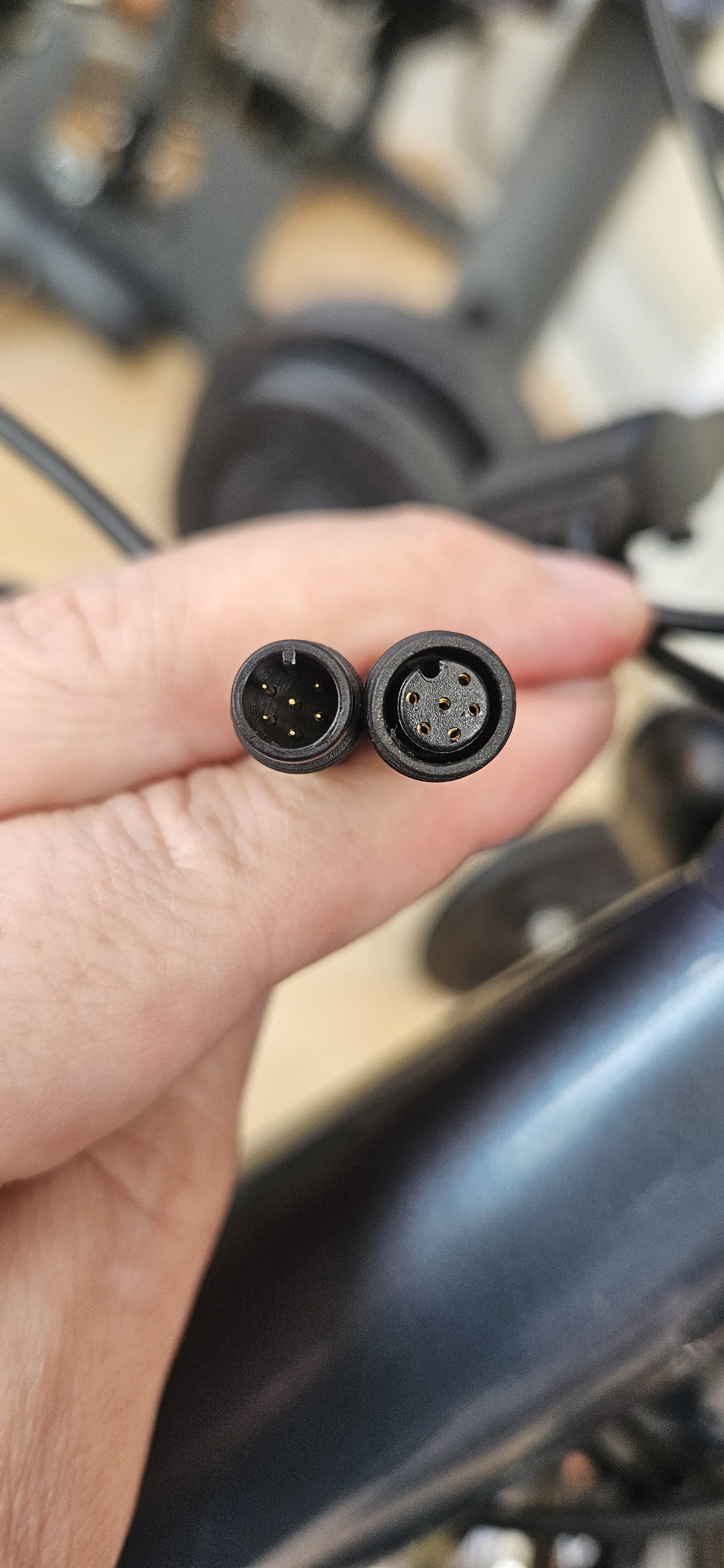

August 20, 20241 yr hello hopefully someone can help me identify where this wire is supposed to go and what it does ,the brown wire.It goes to the center of the round JULet plug coming out of theJ-LCD KING METER control display.
August 20, 20241 yr hmm #1 with no power connected test continuity with a multimeter between the black (ground?) wire in the display plug? and the loose brown wire.. and fingers crossed for a beep that indicates its a common ground connection. both the brake and throttle plugs look 1 wire short to me .. any sign of loose wire strands in either?? do corresponding sockets have fully populated contacts, or?? how does the bike respond now when the brown wire is disconnected, everything but the brake cut off or throttle working would be a big clue
August 20, 20241 yr just isolate the loose wire with some tape and testing the bike system will have no detrimental effects other than aspects not connected correctly wont work
August 20, 20241 yr Also send pic #1 above to the supplier for advice.. if a reputable kit seller they should send out a replacement pdq on that evidence alone..
August 20, 20241 yr Brown, by a process of elimination, must be battery power for lights. You can test that with a meter when you have the LCD connected. Don't forget that you need a ground for the throttle.
August 20, 20241 yr Brown is battery voltage or 5v. Use a meter and find out which it is when probe to Gnd. The wiring looks to me like a Woosh set up , if that is the case the Brown isn't used and simply needs isolating. Edited August 20, 20241 yr by Nealh
August 20, 20241 yr Author hmm #1 with no power connected test continuity with a multimeter between the black (ground?) wire in the display plug? and the loose brown wire.. and fingers crossed for a beep that indicates its a common ground connection. both the brake and throttle plugs look 1 wire short to me .. any sign of loose wire strands in either?? do corresponding sockets have fully populated contacts, or?? how does the bike respond now when the brown wire is disconnected, everything but the brake cut off or throttle working would be a big clue [/QUO hmm #1 with no power connected test continuity with a multimeter between the black (ground?) wire in the display plug? and the loose brown wire.. and fingers crossed for a beep that indicates its a common ground connection. both the brake and throttle plugs look 1 wire short to me .. any sign of loose wire strands in either?? do corresponding sockets have fully populated contacts, or?? how does the bike respond now when the brown wire is disconnected, everything but the brake cut off or throttle working would be a big clue hello and thanks, no pins with missing or sign's of broken wires, only started looking at the wires and saw the brown wire on its own because the bike was very jerky when using the throttle when setting off. I traced the loose wire back to the centre pin on the main display loom but I cannot see where it should go on the brushless controller.
August 20, 20241 yr Author Brown is battery voltage or 5v. Use a meter and find out which it is when probe to Gnd. The wiring looks to me like a Woosh set up , if that is the case the Brown isn't used and simply needs isolating. thanks it is a woposh, so you think it's fine to tape and leave, was hoping it would fix the jerky throttle when connected to the correct place. also there's only 3 fat wires coming from the motor. could this be a reason for the throttle being jerky , feels like it doesn't know where it's meant to start off thanks
August 20, 20241 yr Author hmm #1 with no power connected test continuity with a multimeter between the black (ground?) wire in the display plug? and the loose brown wire.. and fingers crossed for a beep that indicates its a common ground connection. both the brake and throttle plugs look 1 wire short to me .. any sign of loose wire strands in either?? do corresponding sockets have fully populated contacts, or?? how does the bike respond now when the brown wire is disconnected, everything but the brake cut off or throttle working would be a big clue brakes cut of fine, rides ok with pedal assistance, just jerky and stalls sometimes when setting of from a standstill , when moving throttle is fine
August 20, 20241 yr Author thanks it is a woposh, so you think it's fine to tape and leave, was hoping it would fix the jerky throttle when connected to the correct place. also there's only 3 fat wires coming from the motor. could this be a reason for the throttle being jerky , feels like it doesn't know where it's meant to start off thanks
August 20, 20241 yr It's not a Woposh, it's a Woosh bike. Your motor is sensorless. Some controllers don't work very well sensorless. That's why it doesn't start up well. You need to pedal it to get the motor turning first, otherwise you can damage the controller. Never give it power if the motor is stuck. Why are you messing with this bike? What have you changed? Edited August 20, 20241 yr by saneagle
August 20, 20241 yr Author not changed anything it was my mums and it's been sat in the garage, just wanted to find out why it didn't set of smooth , then I found this loose brown wire and thought it must have come loose.
August 20, 20241 yr Author wanted to make sure it was all OK before I give it to my sister, I have not fitted a throttle it came from the shop like that years ago.

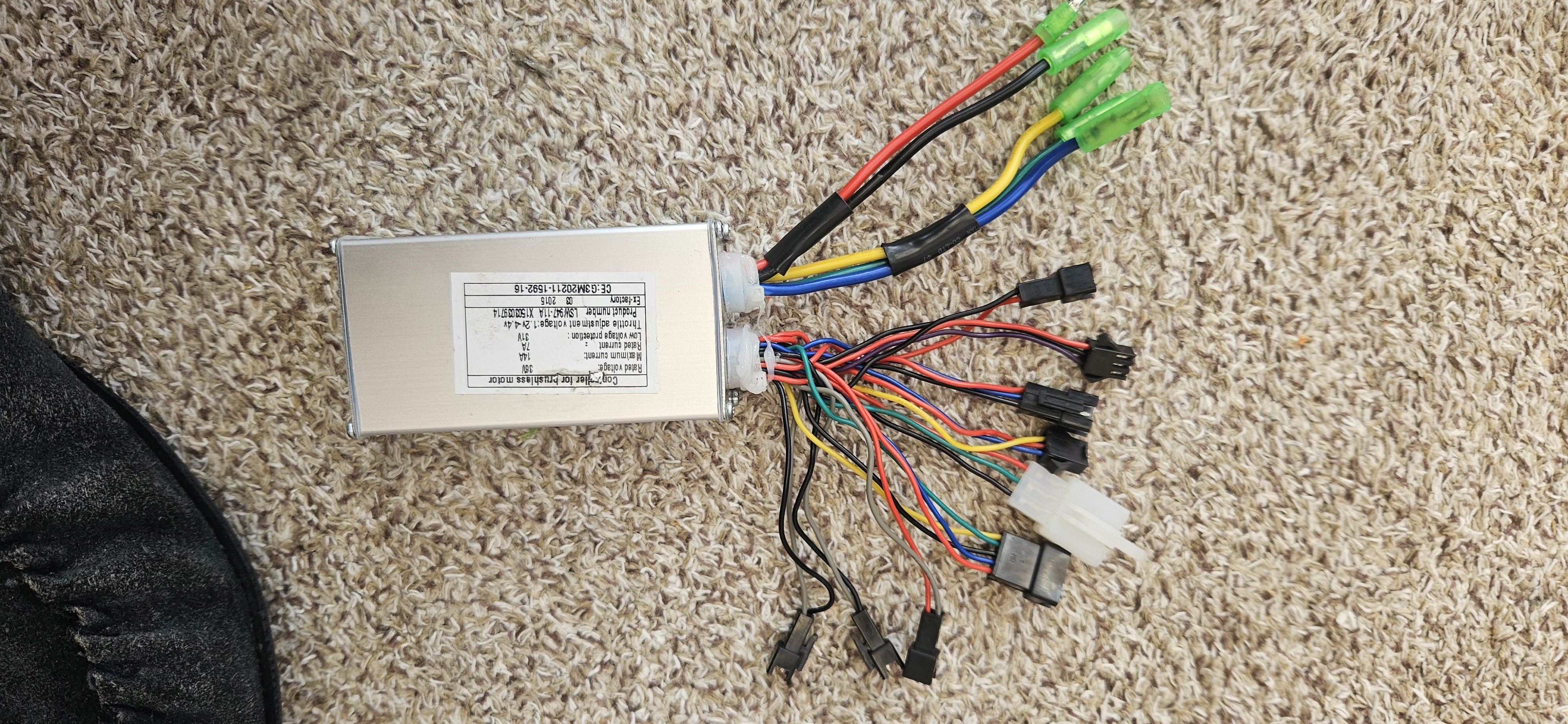

August 21, 20241 yr Right then thanks for the update confirmation. As I said the Brown is unused in that case then so simply insulate the end with heat shrink. The controller is as always a Lishui speed controller and as mentioned a sensorless motor and controller, the bike is likely some 8 -10 years old or so. Throttle wise it is harsh and operation is all or nothing. The lishui set up used on your bike (Santana /Santana petite ? ) is the same as the Bigbear and BPM kit of old from Woosh. Edited August 21, 20241 yr by Nealh
