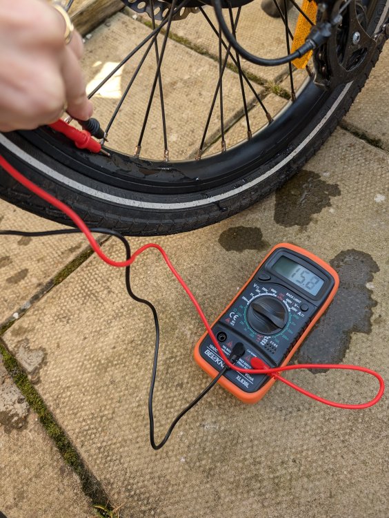

So today I got a multimeter and tested between the rim, nipples and spoke. Rim-nipple was steady 0.1 and spoke to nipple was an on off 0.1. This was cleaned and dried first.
Then I did it with everything wet from rainwater. The rim-nipple reading was 15.8 upwards, and the nipple-spoke reading was around 2.5.
From what I gather this is significant enough to show some galvanic reaction, yes? The interesting thing is that when I measured my son's cheap Halfords bike, it had similar readings but less visible corrosion despite being used all winter on our salted roads, so I may be wrong but I feel like this is an issue of the galvanic reaction and materials with less resistance to corrosion or something like that.
Wisper have said something about sending replacement wheels but I've asked for more clarification on what the cause is as I don't want it just happening again. My interactions with customer service have been odd this time. When I asked for a follow up I was asked "remind me of the problem please" and to send photos, despite having done so in my first email to them.
Anyway, if anyone has some insight into these results that would be super helpful. I want to make sure I get a proper long term solution.
