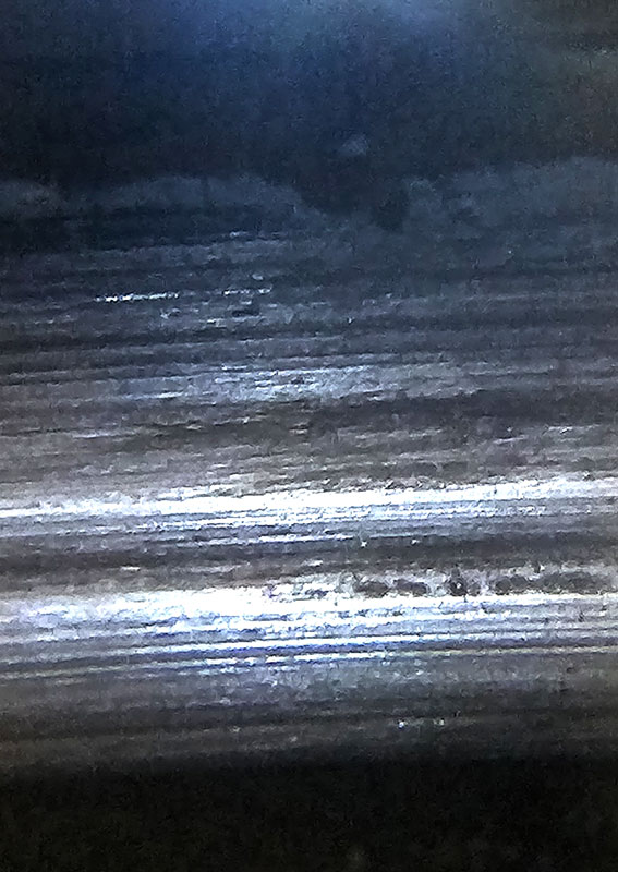

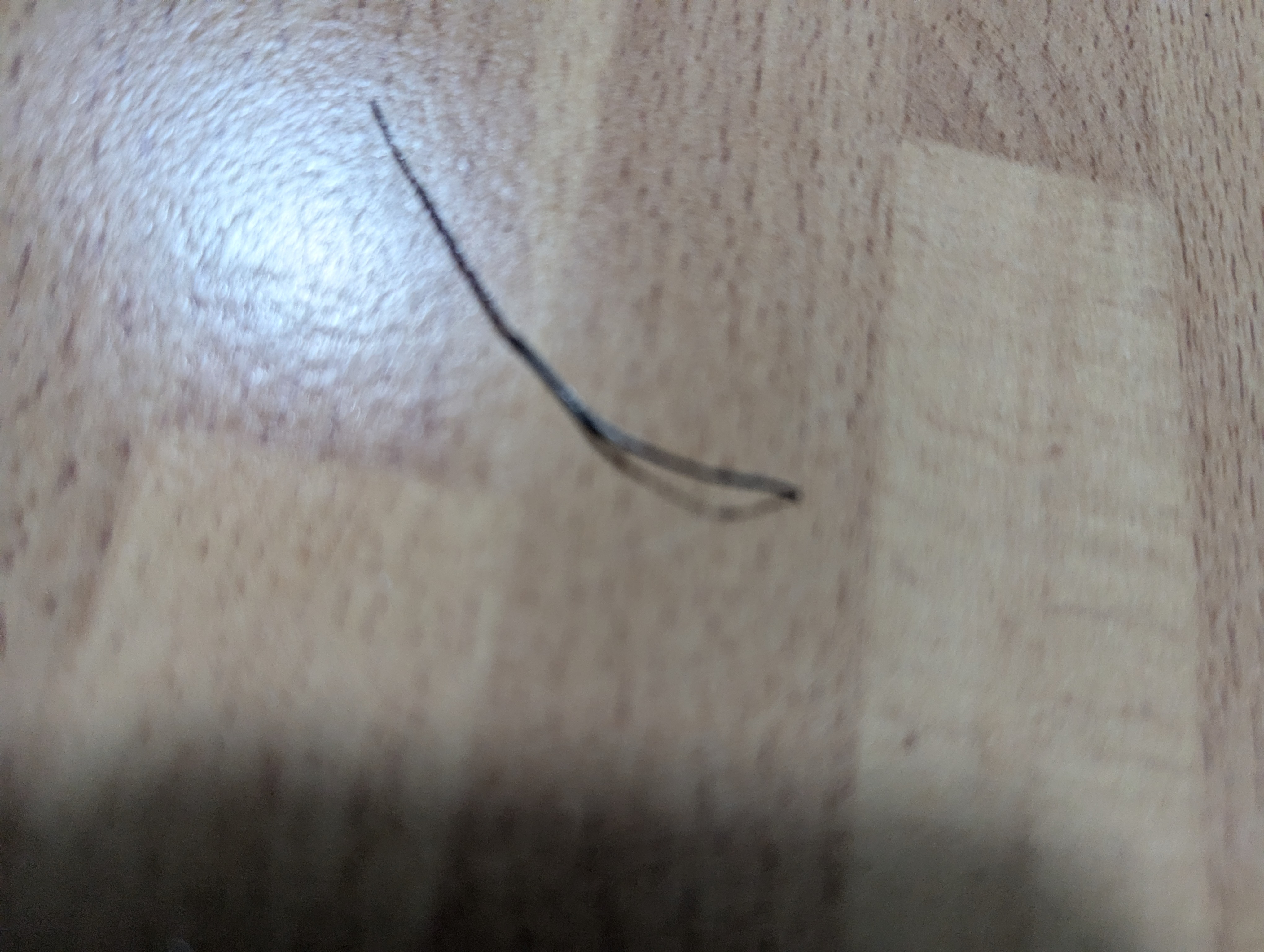

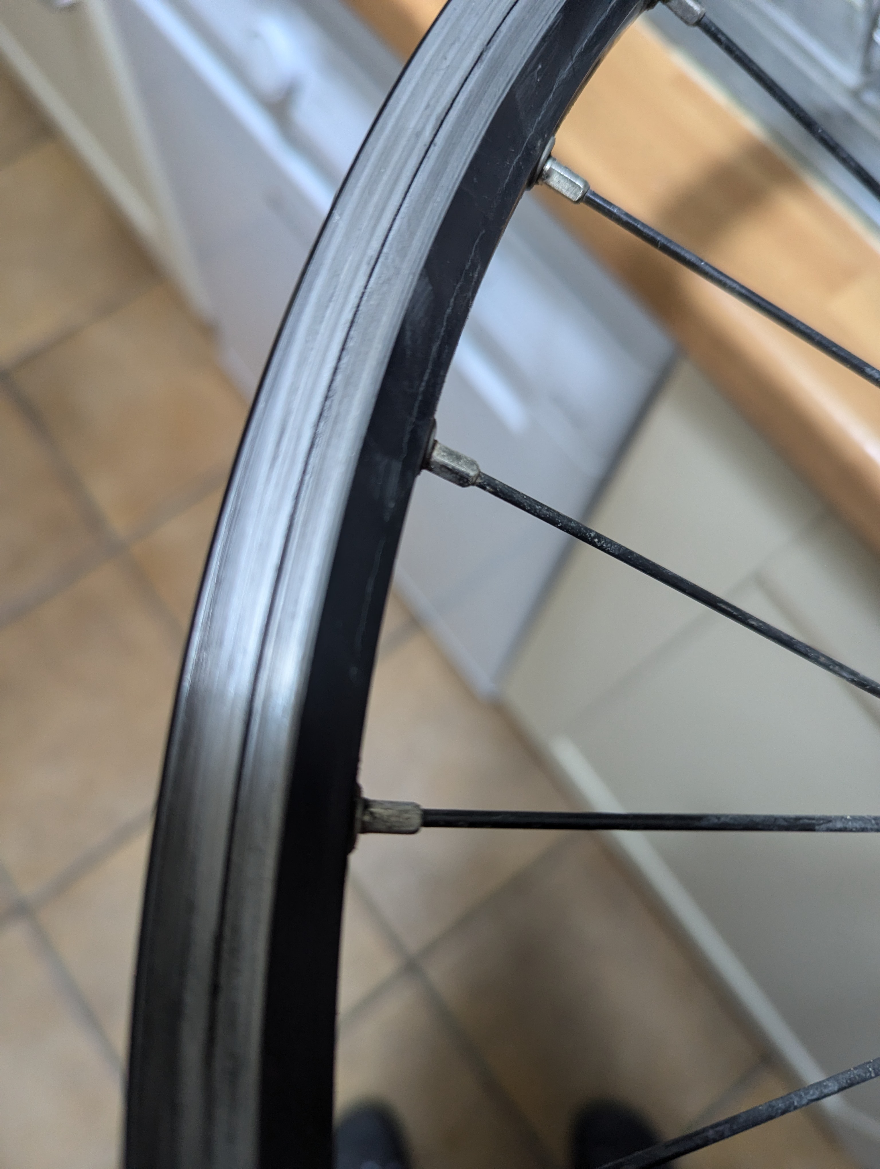

November 18, 20241 yr Hi all. My rear wheel rim has a section about 300mm long where there is a ½mm grove and I can pull out aluminium wire. Is this a manufacturers fault? See grove This is what I've pulled out with my finger nail Anyone seen anything like this before?
November 18, 20241 yr Rim brakes? does the rim appear excessively worn? whats the front wheel condition? how old is the wheel? Not seen the likes myself?? the pics a bit blurey is it stranded wire? or perhaps a more structural piece of the rim itself? If necessary relacing a wheel is a doddle thanks to a couple of 10 minute youtube vids and in my limited experience of 1 x wheel build amazon prime next day delivery and no quible returns made time the only factor in getting the right size spokes.
November 18, 20241 yr Many rims have wear strips that look somewhat like that. When the wear strip becomes invisible it's time to replace the rim. It may be your wasn't that well made, and that the wear strip is mostly worn away but the bit left has degraded.
November 18, 20241 yr The black groove is there to tell you when to replace the rim. When parts of the groove disappear because the bits either side are worn away, it's time to replace the rim. Yours looks Ok at the moment, though it is obviously wearing, so keep an eye on it. The bit you pulled out is just a bit that's peeled off the worn edge. It's nothing to worry about.
November 18, 20241 yr Author Ok. I think it is a little worn out then. 2500 miles on it and I bought nearly 2 years ago. The front wheel has the same milage but doing much better and less wear.
November 18, 20241 yr Ok. I think it is a little worn out then. 2500 miles on it and I bought nearly 2 years ago. The front wheel has the same mileage but doing much better and less wear. So youre a rear brake dragger then. But 2500 is ok, its paid its due.
November 18, 20241 yr Author Yeah. Not sure why back brake is doing the damage though. Going to switch kit to another bike with discs at some point. See if that works better
November 19, 20241 yr Some of the most efficient (from the point of view of breaking) rim brake pads also cause the most wear. Also, if the rim wear and the issue you pointed to at the start are much more on one side of rim than the other it may be that your brakes aren't correctly adjusted.

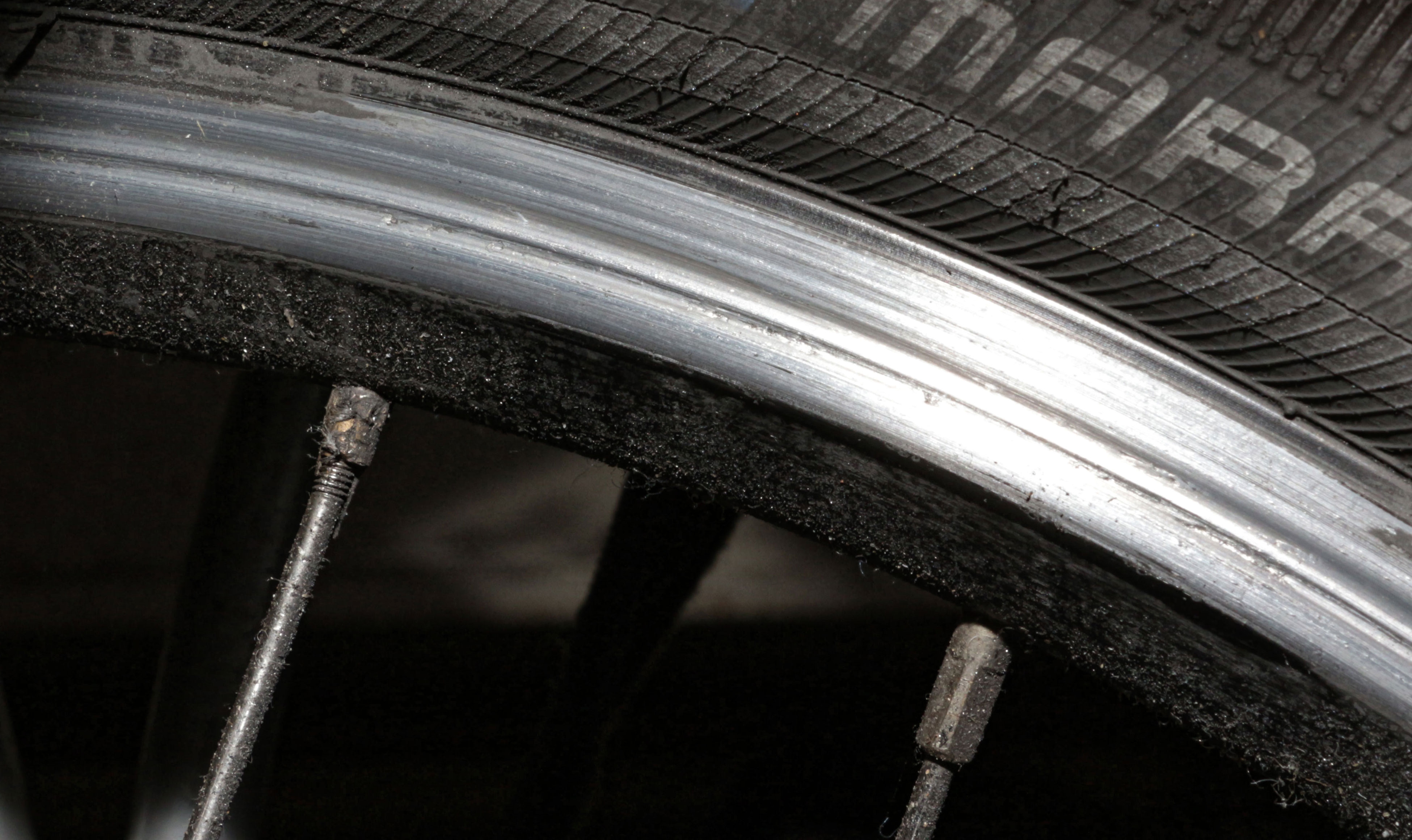

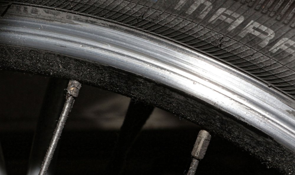

November 23, 20241 yr My present rear wheel rim had a wear indicator line. I can't remember if it's now the ridge in the middle, or the groove below it. Edited November 23, 20241 yr by guerney

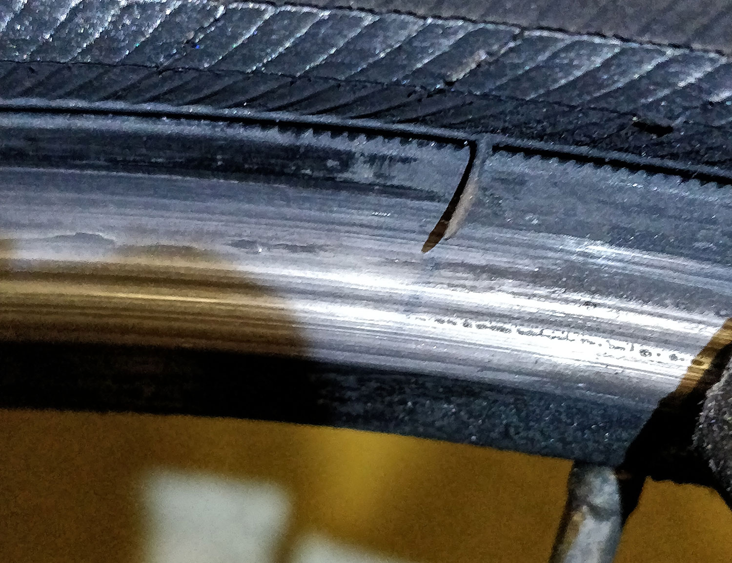

November 23, 20241 yr A shadow from a Schwalbe Marathon Plus tyre rubber fang? Round 2 of spot the rim wear indicator line: The first photo was my phone's camera focusing through a jeweller's loupe, also how I took this pic of my exact likeness which miraculously appeared in a microwaved carrot top the other morning. It even had fangs. I am become Jesus! Will my bike now float on water? I should attempt that wine trick again. Edited November 23, 20241 yr by guerney
November 24, 20241 yr My present rear wheel rim had a wear indicator line. I can't remember if it's now the ridge in the middle, or the groove below it. [ATTACH type=full" alt="61017]61017[/ATTACH] Death would be imminent.
November 24, 20241 yr So how do you know if a wear indicator line has never been there or simply disappeared due to rim wear? Can't say I ever noticed one on my cargo bike wheels, which are incredibly sturdy, although I had thought about fitting hydraulic brakes just to be on the safe side.
November 24, 20241 yr He knows. Nothing exists. Death would be imminent. Has been for months and hundreds of miles, looking pretty much the same. It was cheaper to buy a whole new rear wheel from the amazing BankruptBikeParts than it was to buy a replacement rim, so I did... So how do you know if a wear indicator line has never been there or simply disappeared due to rim wear? Can't say I ever noticed one on my cargo bike wheels, which are incredibly sturdy, although I had thought about fitting hydraulic brakes just to be on the safe side. ...but the "New old stock" wheel's rim doesn't have a wear indicator line. Periodically take measurements? If the rims wear concave, [mention=18796]Sturmey[/mention] suggested holding wire or spoke of known width against the rim while measuring, and subtracting wire width. Edited November 24, 20241 yr by guerney

November 24, 20241 yr I have experienced rim failure on a number of occasions. In all cases, I got a warning when braking from the brake lever pulsing due to the rim bulging outwards in one spot. In all cases, I just let some air out and the rim got me home. The place where the rim is joined, usually 180 degrees opposite the valve is a vulnerable place. I have on one occasion had a rim failure before the groove wore away. Some people claim that the groove actually causes a weakness in the rim. The Ryde/Rigida rims that I like have no groove but holes appear when they are badly worn but I have seen them bulge out before this. I have attached an old magazine article below with one suggestion to test rim by over inflating but I think this can damage modern lightweight rims. Perhaps try over inflating only a little extra, say 20psi extra to test and then let the pressure back down to normal. By the way, I have just worn down a 160mm brake disk from 2mm to 1mm (I read somewhere they should be replaced at 1.5mm) after 19,000Km, so they wear out too, but much less often and are much easier and cheaper to replace. ....The pleasures of cycling in the hills....RimWearGauge.pdf Edited November 24, 20241 yr by Sturmey
November 24, 20241 yr Author I'm starting to think my Chinese brake pads have contributed greatly to the problem. The wheel has deteriorated in the last week so I've ordered a new cheap wheel off Amazon.

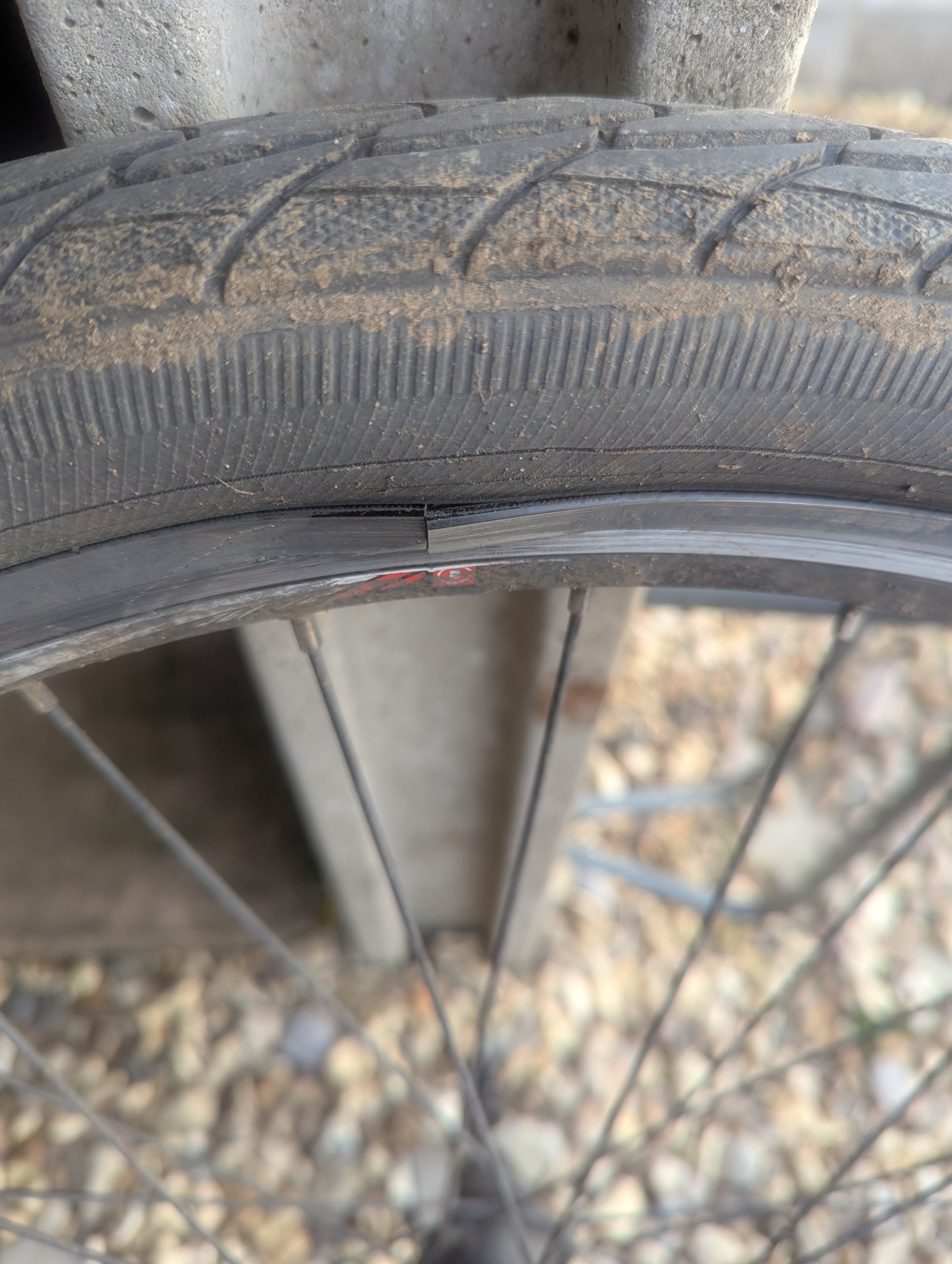

January 25, 20251 yr Author Update. Swapped wheel today. Friday the rear wheel locked as jammed on brake shoe. Finally the rim failed although I'm surprised it's split.
