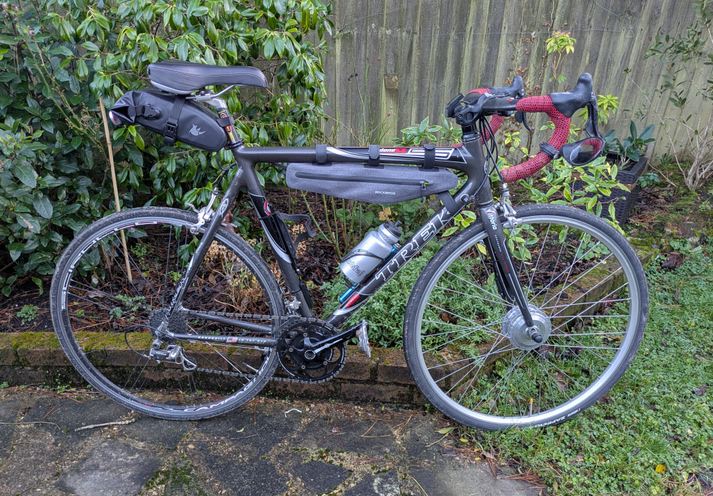

Since taking the pic for post #13 above, I've further fettled in an effort to hide cabling to a more pleasing level. The battery pack is in the seat pack and the controller in a small top tube bag along with the essential roadside repair kit and a couple of spare tubes, all controlled by the small KT-LCD4 display on the handlebars. Now all I need to do is re-build the front wheel using the Campag rim from the original wheel and 'bob's your antie' as they say.......

Thanks for sharing this . Something similar on the Clubman if done well could even enhance the look. The silver front hub would fit in well in proportion and complementing the crank and other chromed parts and the controller could go in the existing bag on mine. As you mentioned adding a lightweight kit to an already lightweight racer/ road bike of this type is unlikely to affect the feel/ handling to any significant degree and could add an extra dimension in terms of usability in a package that comes in at a very low weight for an ebike. The cost of the entire kit although important may be less of an issue to a point as you would be converting something you have and perhaps could say are emotionally attached to. However with the market now offering cheaper and cheaper perfectly usable bikes e.g. since starting this thread the Apollo Phase which seems quite popular and reliable has gone down to 499 (and with a couple of combined discount vouchers £400 for me) Apollo Phaze-E Electric Mountain Bike 20" | Halfords UK it may even be feasible to buy something similar at a lower cost than a kit and utilise some or all of the parts somehow coming in at a lower cost than the kit.
