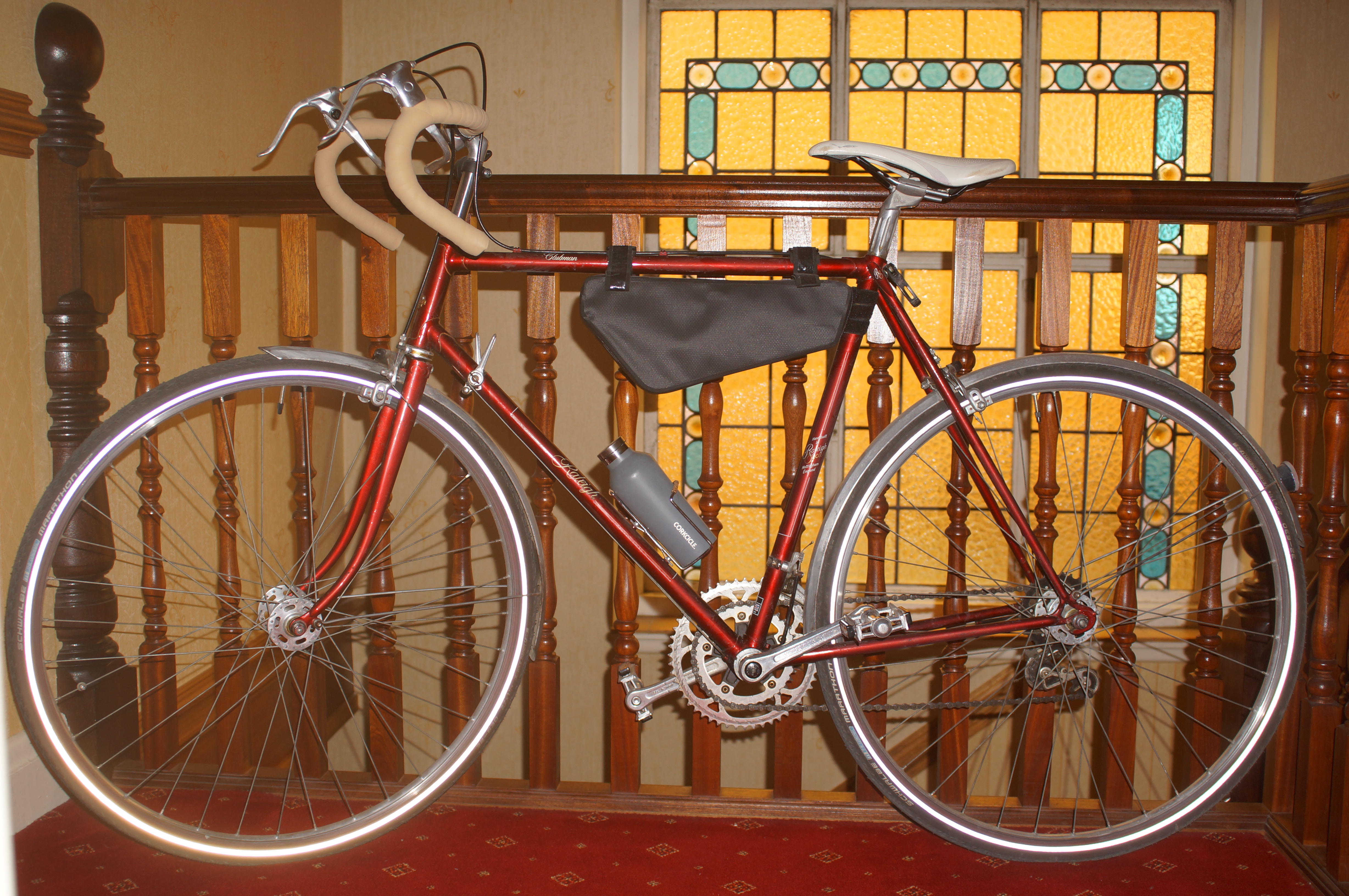

Hi, the era of the Ferrari Testarossa which are now in some peoples opinions controversially being converted to ev. How would you convert this ? Thank you.
How far do you want to go? How fast do you want to go?
Thanks for the replies. It would only be for preserving the knees uphill/ along the straights is fast enough so something lightweight and low power which is unlikely to impact safety of the brakes. The black bag/ bottle could be used to hide some of the electrics
AKM100/Q100H motor from BMSbattery:
https://bmsbattery.com/motor/631-16312-q100h-36v350w-rear-driving-ebike-hub-motor-ebike-kit.html#/213-rpm-201
Kt controller kit from Topbikekit or BMSB (S06S). Block connector type.
https://bmsbattery.com/controller/1006-s06s-250watts-torque-simulation-sine-wave-controller.html
Bottle battery from Aliexpress
https://fr.aliexpress.com/item/1005001889766799.html?src=google&pdp_npi=4%40dis%21GBP%21180.91%21148.79%21%21%21%21%21%40%2112000034614028186%21ppc%21%21%21&src=google&albch=shopping&acnt=494-037-6276&isdl=y&slnk=&plac=&mtctp=&albbt=Google_7_shopping&aff_platform=google&aff_short_key=UneMJZVf&gclsrc=aw.ds&albagn=888888&ds_e_adid=&ds_e_matchtype=&ds_e_device=c&ds_e_network=x&ds_e_product_group_id=&ds_e_product_id=en1005001889766799&ds_e_product_merchant_id=107737469&ds_e_product_country=GB&ds_e_product_language=en&ds_e_product_channel=online&ds_e_product_store_id=&ds_url_v=2&albcp=17859500389&albag=&isSmbAutoCall=false&needSmbHouyi=false&gad_source=1&gclid=Cj0KCQiAsaS7BhDPARIsAAX5cSAzihggaf4aejE3Qpo3C8jHx0TB35w441cGt9UWnmrUc5TGrf5ntWoaAqO9EALw_wcB&gatewayAdapt=glo2fra

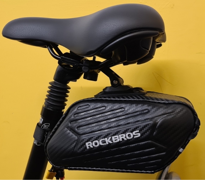

Toolbag for controller under seat
https://www.ebay.co.uk/itm/305095703503?_trkparms=amclksrc%3DITM%26aid%3D1110006%26algo%3DHOMESPLICE.SIM%26ao%3D1%26asc%3D277988%2C277309%2C278303%2C277737%26meid%3D92bc9932fdc144378da70627a86ee916%26pid%3D101875%26rk%3D3%26rkt%3D4%26sd%3D116264423333%26itm%3D305095703503%26pmt%3D1%26noa%3D0%26pg%3D2332490%26algv%3DSimVIDwebV3WithCPCExpansionEmbeddingSearchQuerySemanticBroadMatchSingularityRecall%26brand%3DUnbranded&_trksid=p2332490.c101875.m1851&itmprp=cksum%3A30509570350392bc9932fdc144378da70627a86ee916%7Cenc%3AAQAJAAABUNthdh9o32sOfKme0krmx3yc5y0DRWWwwpiraCEsA5rOcanQjqu91drTeDElZLF31uaWQXaQ2pNTl5IMyA1OfooQwqEcJUvtG9LvKPKHgcRzphx12iPvBSva61o%252BMhuWL%252FrjeNcDGezQ%252FdxQfAGV3ekq3A8AaWn0XRVsErA%252FQBhH9y%252FICYKeZfPY1Fk9FBIILvEMgsXAgccDRY2r%252BKNkSi7j5hIaBwQjSS6Czq7yRr9lh2Av%252FRphj3Hr94nzn4ovjW%252Fi34YmCCLEHAhQvHJUZs%252FyDuwFAq%252B%252B%252F83BRsoj9bIsMbr7yG5NeXiCyvdKTD7kpIbRuDPI4lBAV6SO9F1eZz0WTBUV8tWgfoEbVQbEdAmkMOSaKNhx7jXXCQYrRsebneaWG%252FTuntEd8fuCM6at5%252BQMed%252Fp1JP2YzO7I6ZBO9%252BgjtLBhIIPPM1AaRttvQVhOw%253D%253D%7Campid%3APL_CLK%7Cclp%3A2332490&itmmeta=01JFSV8F0EVQN4RQD0FAZB6HAZ

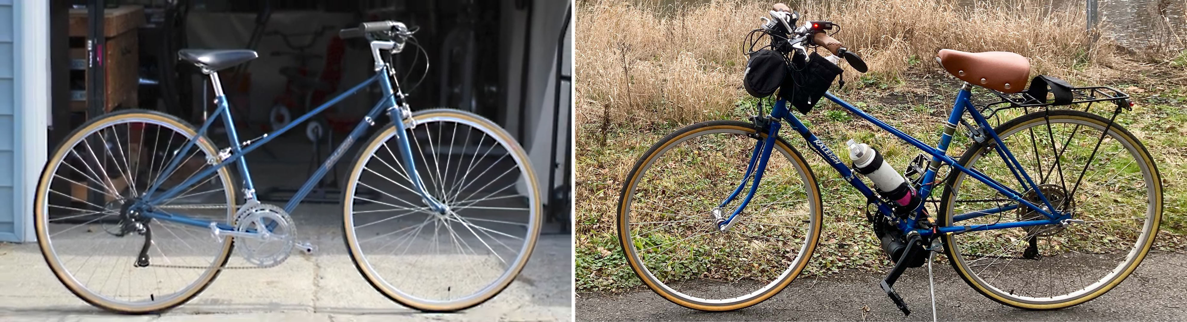

For this Raleigh Mixte, I used a low cost TSDZ2 mid drive. For me, this is less expensive than buying a motor/wheel and controller, I had some teething problems with my motor, not being used to a true 250W motor. I've ridden it 2000 miles this year. Top speed is based on hardI am able to pedal that day. It's torque sense, and the system is intended to respond to your pedal pressure. It used to be 18 mph and now it's about 24 mph. This bike is from the 70's, and my best days are from there.
The caliper brakes are fine for pedelec speeds. This bike comes in around 40 pounds.I use a small 26 cell 48V battery made with Sanyo GA cells. Good for 300WH and almost 40 miles.

Very little resistance above that speed. Maybe combine with 36v 10Ah bag battery that attaches to saddle with room for controller eg Woosh (1.8kg)
https://wooshbikes.co.uk/?batteries

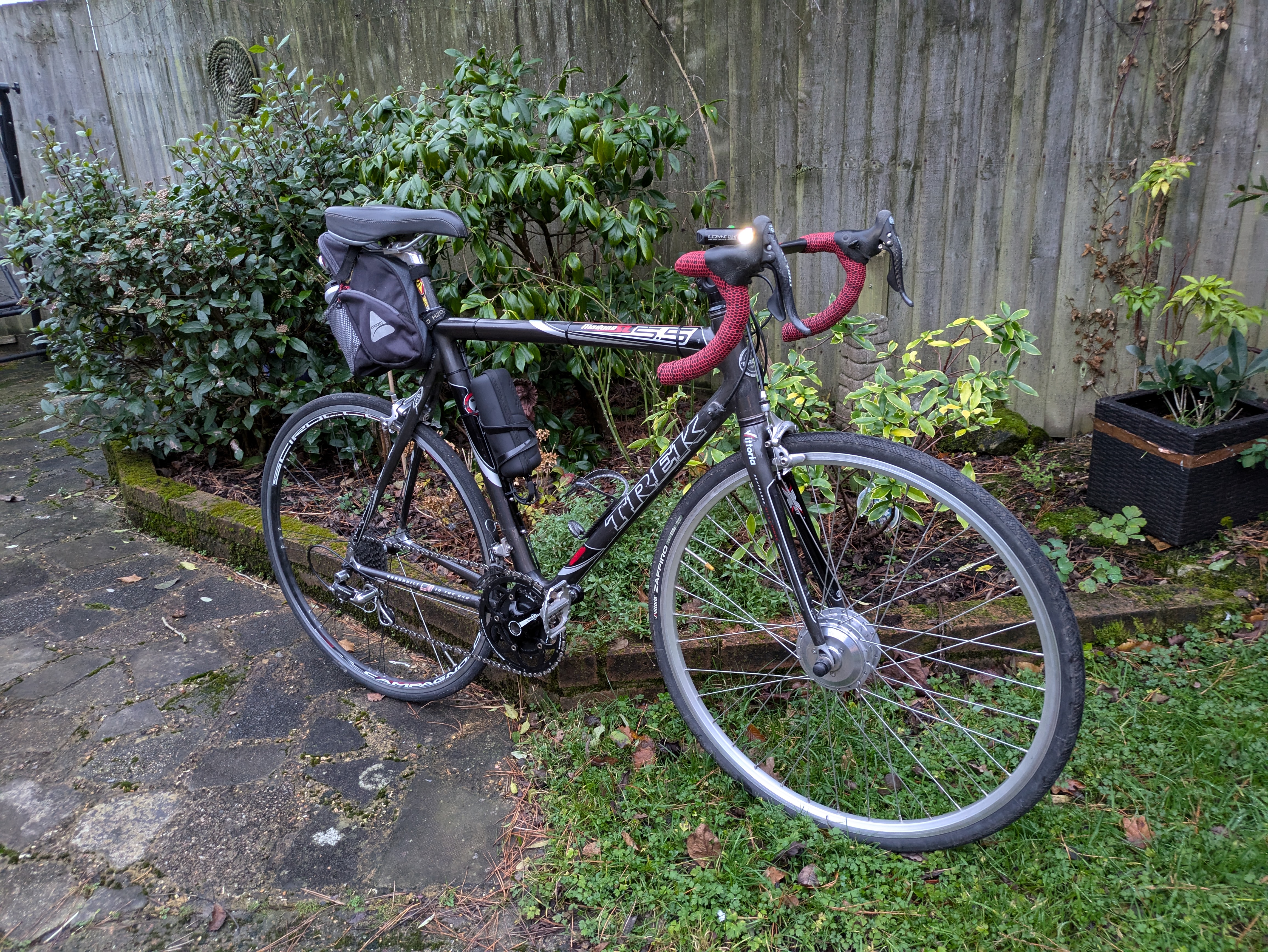

Hi [mention=24073]Vin[/mention] - as you've seen, opinions vary - here's some more to add to the pile:
  • The brakes
    - if we take a front hub conversion as an example, you'll be adding the weight of the motor plus the electronics and a small bag to hold them - so around 2.5Kg. Then there's a battery - if your'e going for something like a 7Ah then let's say 1Kg, so around 3.5Kg.
    - Now, if you're brakes are serving you well now then IMHO by just adding 3.5Kg won't make much of a difference.
    - plus if you are only going to be using the motor for marginal assistance then your road speed isn't going to be much if any different from what it is on the unassisted version
  • Having used a bike with a TSDZ2 mid drive conversion for a few years now, my fitness level has improved and I don't have to use as much 'e' in my biking as I used to, thus I resurected my road bike with a front hub conversion (Aikema 100SX)PXL_20241217_155057466.thumb.jpg.cd9899a51e445c873a47941aedba9e84.jpg.
  • In that conversion I'm still working out the most discrete places for the KT Controller and wires but the battery fits nicely in the seat pack.
  • Oh, and early days (less than a 100 miles so far) but the ride it gives me is very enjoyable and because the total weight of the bike (less tools) is around 14Kg, much of the ride is over 25Kph and thus battery usage is frugal with my 8.4Ah battery likely good for 60+ miles (yet to be fully range tested).
