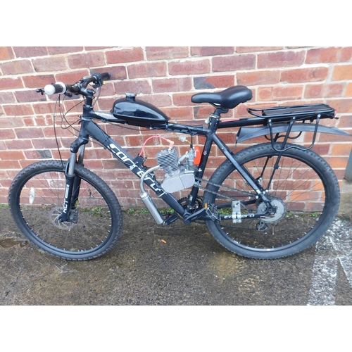

Why not a petrol kit if your not taking the bike onto the road? Cheaper?
[ATTACH type=full" alt="62296]62296[/ATTACH].
Looks sick but I don't think the neighbors will think so
