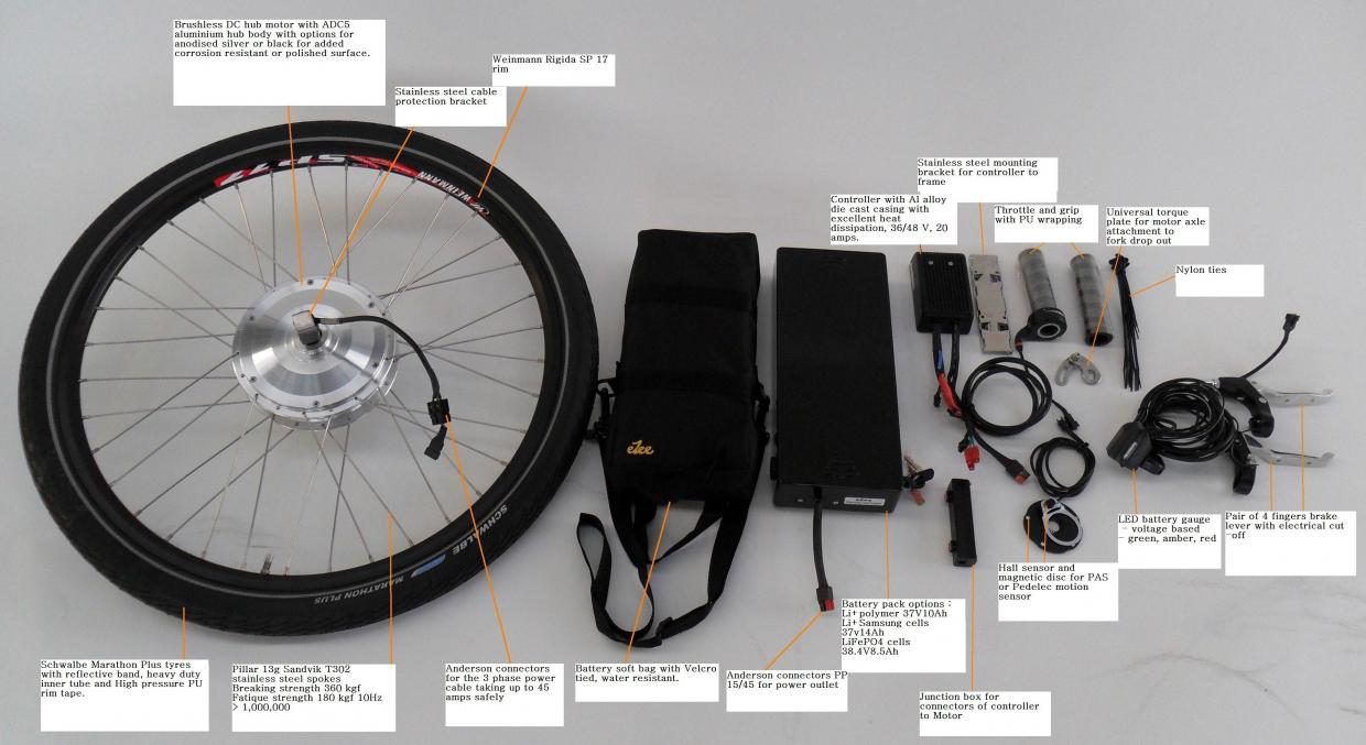

A standard kit as seen in the image below weighs from 7 to 7.5 Kg, the variation is due to things like wheel size, whether the brake disc rotor is fitted or not etc. I have just realised that the included 180mm brake disc rotor is not shown here.
[ATTACH]2318.vB[/ATTACH]
[ATTACH]2318[/ATTACH]
Thanks. To sum up, my existing wheel weighs 1.7kg, so for the largest kit I will be adding an extra 5.8 kg (7.5 kg - 1.7 kg) to my existing tourer wight of 17.3 kg to give me a total weight when kit fitted of 23.1 kg. Is this correct ?

Those calculations are basically correct. The eZee kit comes with a Schwalbe Marathon Plus tyre which is probably heavier than yours, a front wheel kit has more cable than a rear, so there are a few variables to take into consideration.
