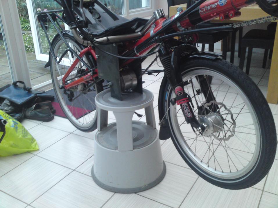

This is interesting ... because I have "fork plates" with a particular very basic shape (I was thinking about making it lighter and more sexy ...cutting bits away , drilling holes, etc ... ) I can use it to balance on a office stool:
[ATTACH]2843.vB[/ATTACH]
Now.. if I add some telescopic legs I have a travelling bike stand which would be brilliant. when I had THAT puncture I had to lay the bike down on its side to do the repair ...

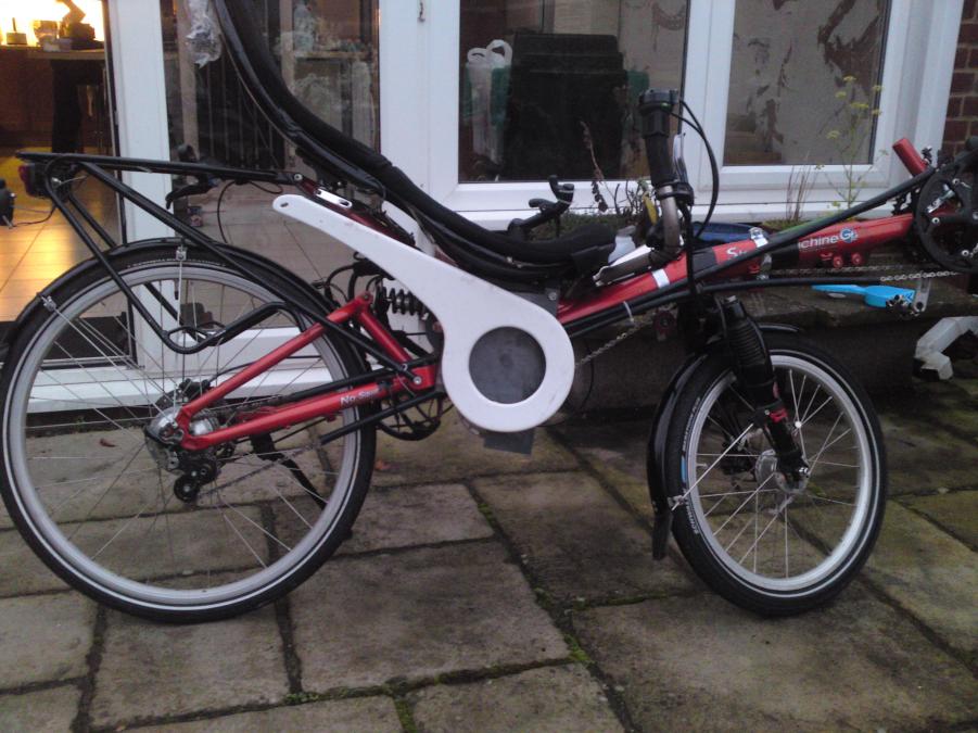

Concentrated on the gearing last night and moved the chain to the smaller chainring. 48T to 36T. Had to remove some more links and improve the arms of my chainwheels and move the motor slightly to avoid some chain rubbing ... and then a midnight test ride around Alton including a hill this time! ... was noticably better. Much improved torgue and motor performance. This morning I sat looking at the bike with its bent handlebar, supped some tea and pondered and then snapped out of it and decided to try again! ... So glad I did, had an excellent cycle to work. No messing about this time. No cameras. No photos ... well, except this one which emphasizes my need to make use of things .. in this case a disguarded bit of plastic from a Ultra Motor Fast4ward ...

Here is a photo of the new chainwheel config:
[ATTACH]2849.vB[/ATTACH]

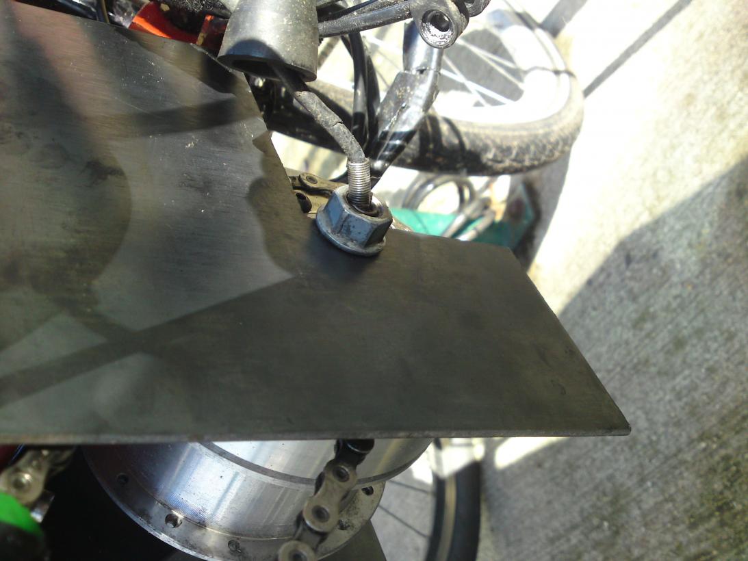

One of the things I am concerned about although the evidence suggests that I needn't be ... is my use of the drive side wheel nut. As I have very little axel to screw onto the wheel nut is almost not attached. In fact you could remove it altogether and there would be no difference. My conclusion is that its not needed. I suspect that because I am using slotted "drop ins" the axel isn't going anywhere so I dont need the wheel nuts? Here is a photo:
[ATTACH]2848.vB[/ATTACH]
It wouldnt do any harm to keep them.
I would just to be extra safe. Its hardly like they take up much extra weight...
