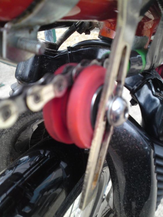

Having moved the motor the chainline is much improved. However, my chainwheel installation leaves much to be desired. Cycled to work this morning shaving off the red wheel plastic from my chainwheels. I wondered what that nosie was! ...

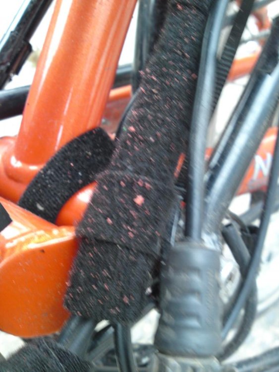

Ok... next mistake ... next challange ... The section of hose pipe that was protecting the front forks AND the brake cable that is cable tied to it failed ... I cycled home without that protection and have now punctured my magura marta disc front brake cable. I know its punctured because royal blue fluid went everywhere and when you try to brake there is nothing there! ... If found some utube vids on bleeding etc ... but nothing on cable suppliers ... Does anyone know where I can get some cable? Is my lbs likely to stock this? ... Obviously I'll find out tomorrow but it would be good to know ... also, any tips from members who are experienced with these breaks ...
You need to help a few more old ladies accross the road!
Stainless Steel Braided Hydraulic Disc Brake Hose 85cm | eBay
thanks d8veh. Ordered ... I think where I've gone wrong is when I dropped down to the smaller chainring. This has taken the chainline 5mm or so closer to the frame and closer to trouble! ... Although having said that if I had secured my piece of hose correctly then it would be fine ....
Now I'm looking for a bleeding kit and some of that blue stuff.

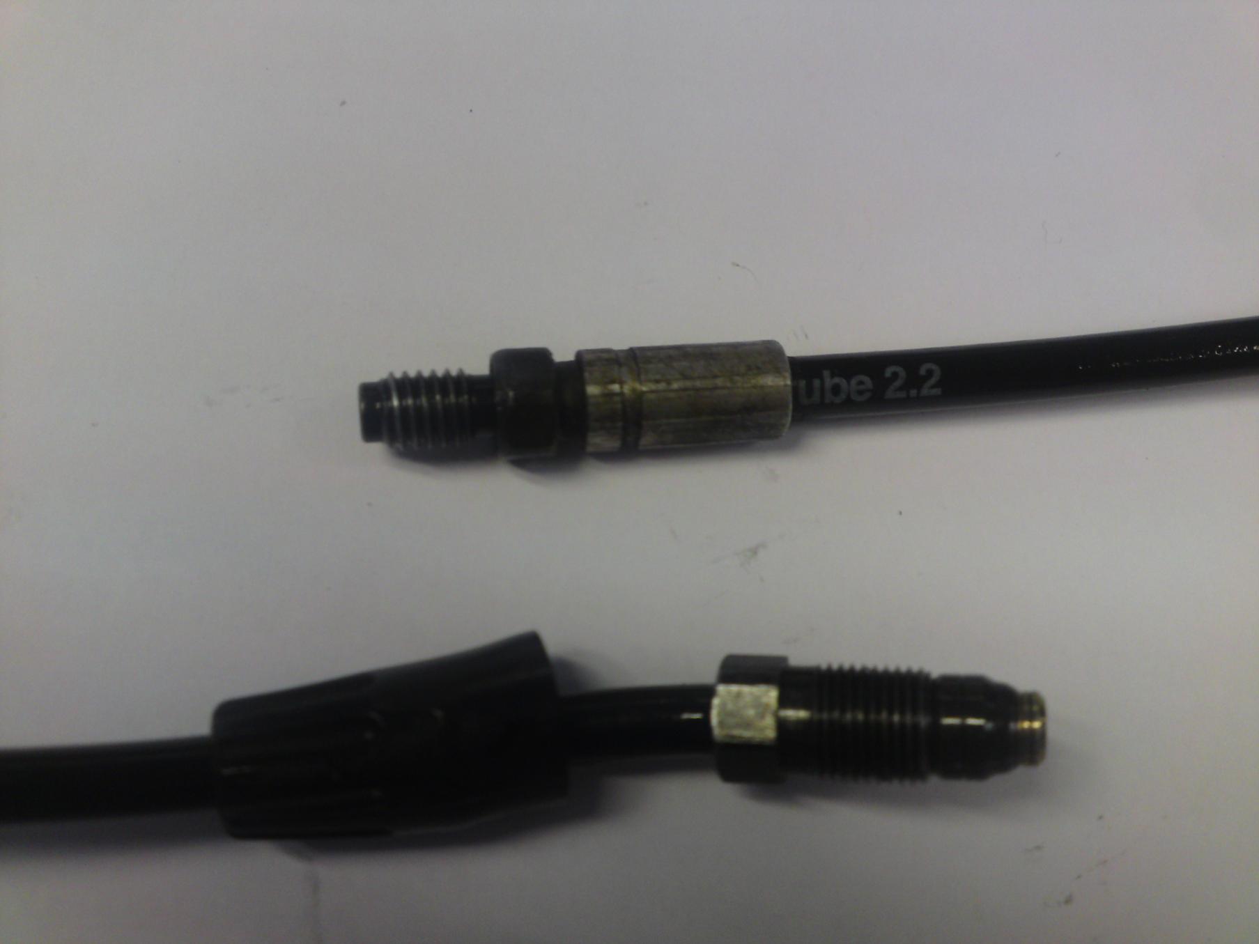

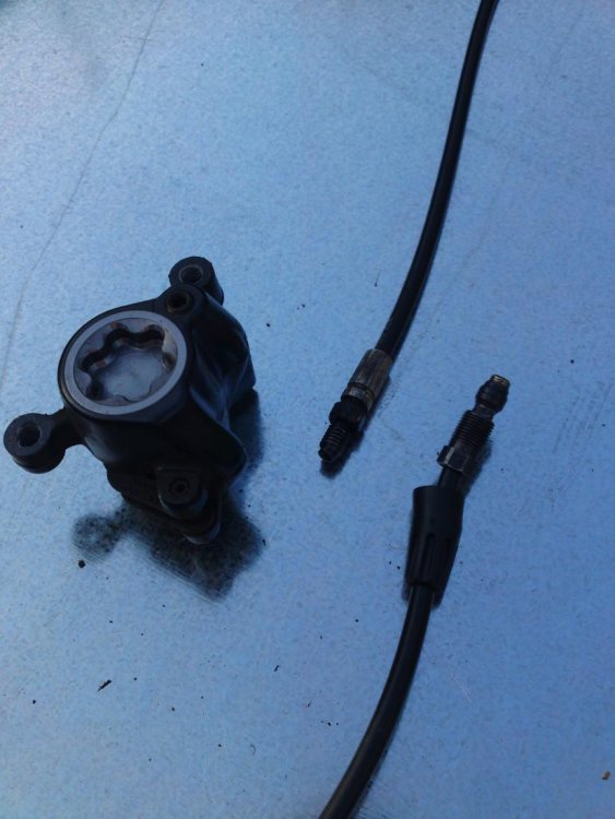

Got my cable. Could use some advise on what to do. Perhaps some step by step postings if you have the energy! .. and I'll take pictures of everything I do ...
The current status is the damaged cable is still connected probably with some fluid in the system. Here are the cable ends:
[ATTACH]2905.vB[/ATTACH]
How do I know that these endings are ok for my Magura brakes?

I need to change the endings or get a cable with the current endings that look like this:
[ATTACH]2911.vB[/ATTACH]
Can I divorce the endings from the cables or is this not recommended?

Here is my cable:
[ATTACH]2912.vB[/ATTACH]
Question remains: can I get the connectors off the old and new cables and make up my new cable? .....

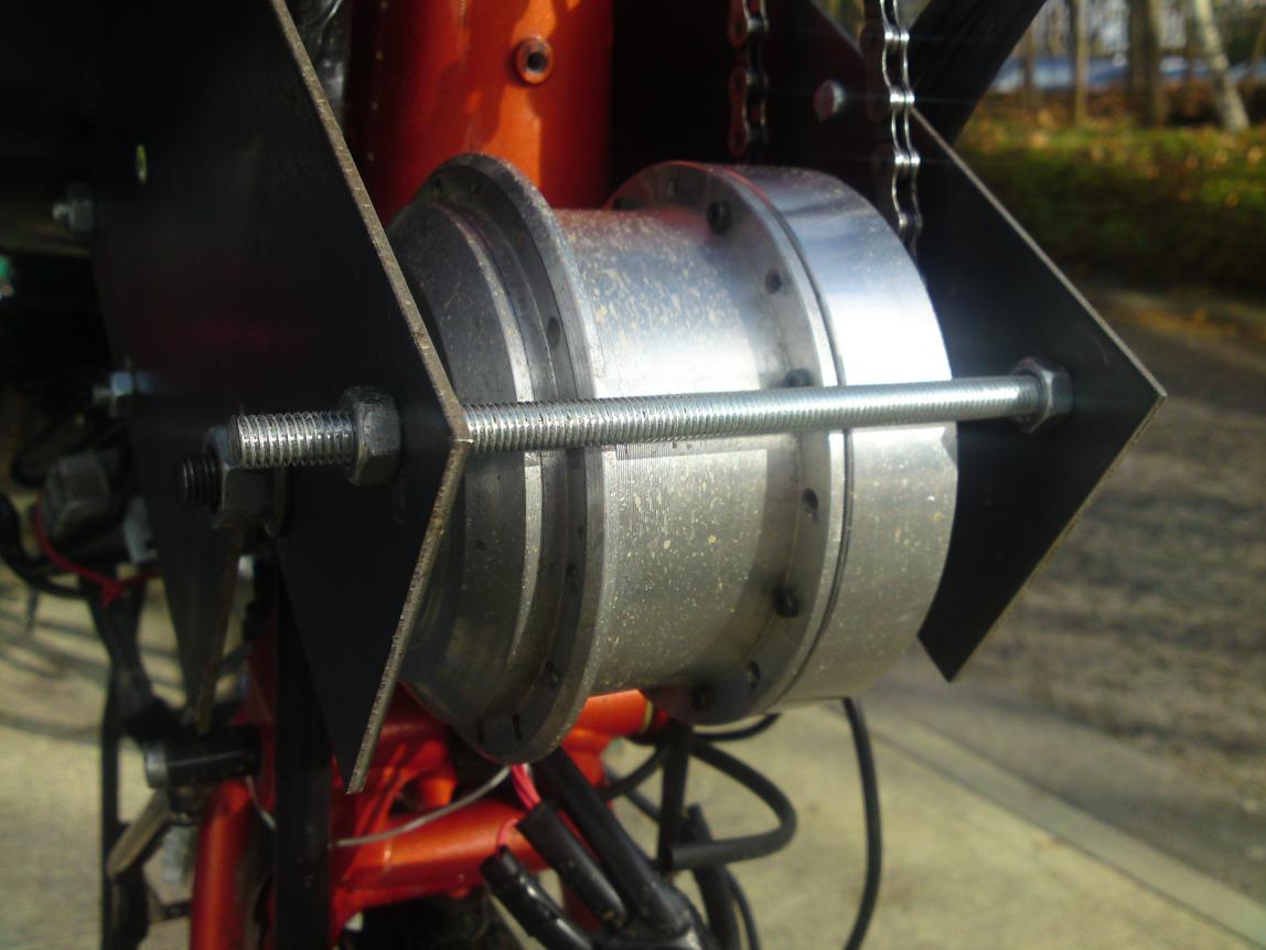

Added a fourth threaded bar as my 3mm plates were still not as solid as I would like! ...

Hi Alan if you type the model of your brake into the searchbox on this page it should come up with the info you require:
Search: MAGURA - The Passion People!
With regard to re-using the hose ends, If you can remove them from the old hose without them getting damaged, and the new hose you have is a match with the old one for internal and external diameter, and material the hose is made of is the same it should work fine :)
thanks oigoi. Cycle Kingdom in Fleet is quite close and can make a cable up for me for £15.00 and could do the complete job for about £30.00 depending on the state of the pads .. might give me a bit off if I part exchange the other cable ..

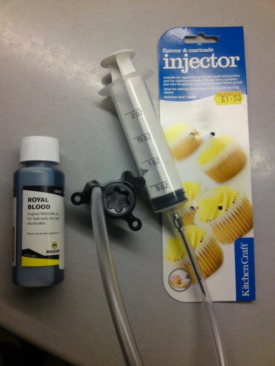

Got my cable, some blue blood, a screw a hole in it, some pipe and a food injector!

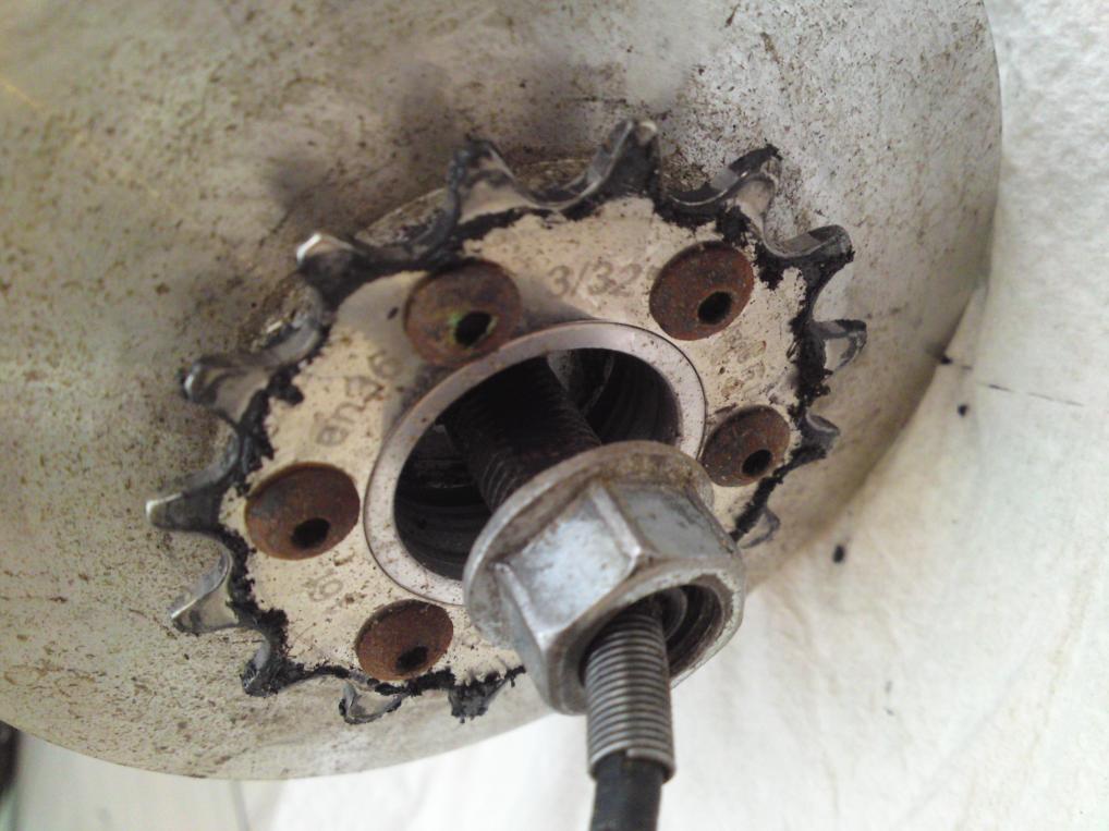

Only bad news was another chainwheel failure which must have happend this morning and at £10 a pop I really need to sort it.

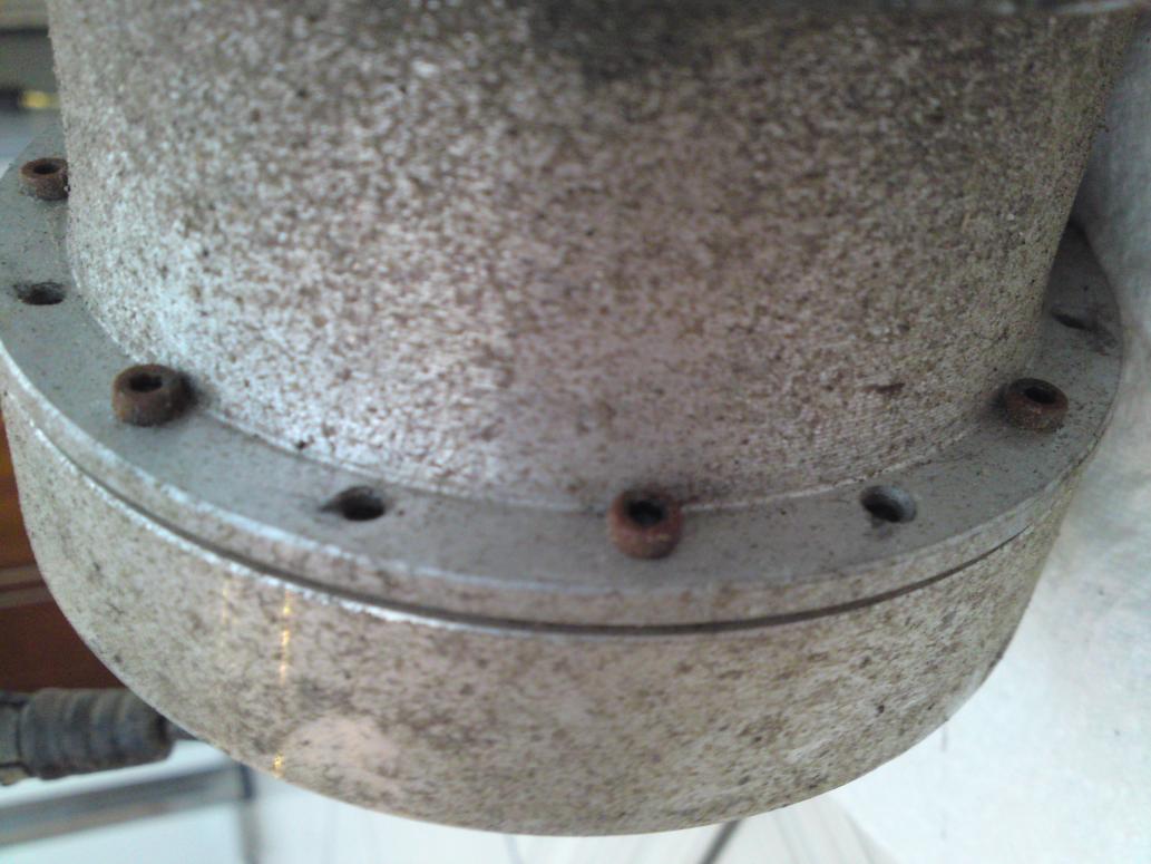

Done 700 miles now. Tongxin looked in need of a clean. After the clean:
[ATTACH]3115.vB[/ATTACH]
And this is how I did it:
