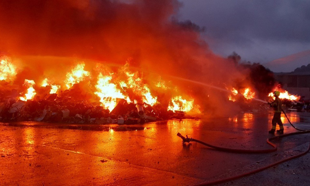

we have had ppl post on this forum with batts that has been in a canal then wonder why when charging it smoke is coming out. :rolleyes:
then they throw it in the bin and this happens.:oops:
