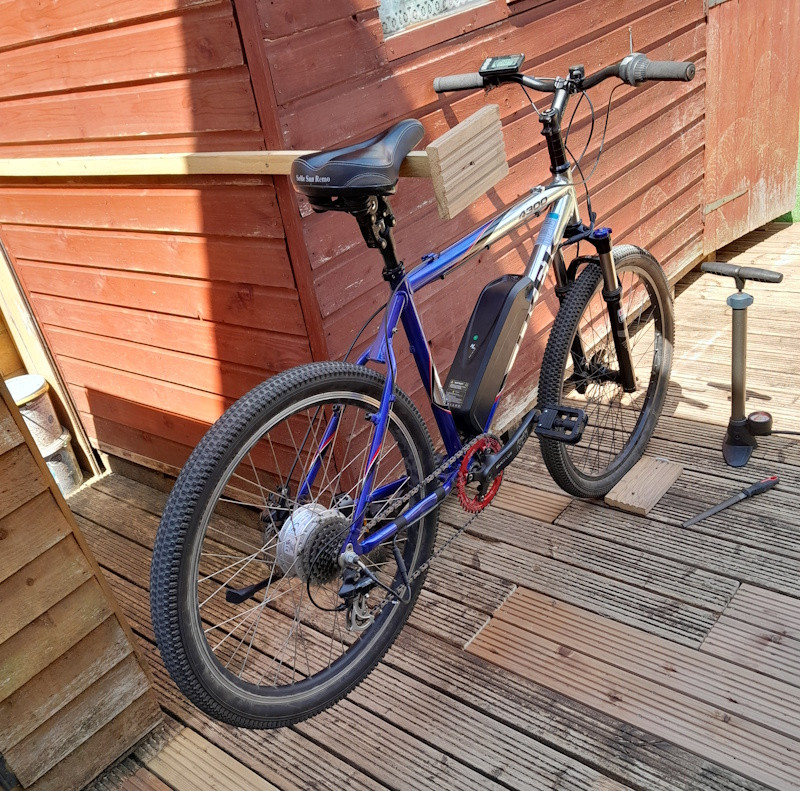

So this morning I went to get my bike out of the shed and the back tyre was completely flat.
So shoved a new tube in there just to be on the safe side.
Still, it gave me an opportunity to file just a little bit more from the drop-outs to get an even snugger fit for the axle.
So anyway then I got my bike up on my DIY bike stand and thought I'd try one of these police back-wheel-off-the-ground-speed-tests.
So when I'm pedalling slowly, sure enough the max speed was 15/16MPH, but If I pedal fast it would go over 30MPH.
The thing is, if you get stopped and they decide to do this type of test, how do you convince them to pedal slowly?
I do not believe rozzers are doing this stupid test.
Can you set magnet number = 2? Did that to my BBS01B and it's now happily showing half speed on this dumb and fictitious no-load pedal assist speed test, and it's very arduous for me to show much faster than 20kph pedalling by hand with the bike on a stand (I tied the bike frame to the stand's top tube with rope, in case the jaws/clamp failed, but it didn't). Half speed, probably because the second magnet (Cateye) isn't long enough, or as long as the Bafang kit magnet; the Cateye needs another magnet stacked and stuck on to be closer to the sensor. The Bafang kit magnet is stronger than the Cateye, which is stronger than the cheapo AliExpress spoke magnets. As is, my bike will pass this ludicrous and absurdly stupid fantasy test, if the fuzz go by just speedo readout.

Had another go with two cheapo AliExpress magnets this time and.... speed was correct until a little over 27kph, then the controller became very confused and calculates speed = 16kph to 19kph regardless of how fast I pedalled by hand with the bike on the stand (tied the bike frame to the stand's clamp arm with rope, in case the clamp jaws failed with the motor's vibes, but it didn't). Same result when using two Cateye magnets. We're allowed 10% over 25kph = 27.5kph, therefore again, as is my bike would pass the no-load pedal assist speed limit test, if pigtailed fuzzball Jesus-beardy plod go by speedo readout alone. My BBS01B is quiet, I can barely hear it while riding, and I can't hear or feel it operating when pedalling by hand at high speed, rozzers won't be able to either - drowned out by the noise of the chain, cogs etc. Because there's no load, there's no voltage drop on the display, and my display doesn't have a Wattmeter, can't see if the motor is assisting.
My rear wheel has 14 spokes per side. Magnets = 14 is accepted by BBS01B firmware, but I can't install 14 mixed magnets without sticking thin magnets (stacking a 1.5mm and 1mm combos) onto the Cateyes and AliExpress cheapos, to make the distance to the speed sensor about 1mm.
With 7 AliExpress magnets, max speed displayed = about 7kph max regardless. Bafang controller was much befuddled and confused, but my wonderous bike of maximum awe inspirementation and absolute magnificence of the highest order possible in this universe or any other currently existing in this multiverse, passed yet again!
These AliExpress cheapo spoke magnets require glue to stop them turning on spokes. The Cateyes don't, neither does the Bafang kit spoke magnet. AliExpress cheapos are shoddily made pieces of shizz.
Two Cateye magnets will do the job, if I believed fuzzball Jesus beardy pigtailed tasermeister rozzering plod orificiers were doing this profoundly stupid test, and I most emphatically don't - curiosity got the better of me, hence this post.
Can you set magnet number = 2? Did that to my BBS01B and it's now happily showing half speed on this dumb and fictitious no-load pedal assist speed test, and it's very arduous for me to show much faster than 20kph pedalling by hand with the bike on a stand. Half speed, probably because the second magnet (Cateye) isn't long enough, or as long as the Bafang kit magnet; the Cateye needs another magnet stacked and stuck on to be closer to the sensor. The Bafang kit magnet is stronger than the Cateye, which is stronger than the cheapo AliExpress spoke magnets. As is, my bike will pass this ludicrous and absurdly stupid fantasy test, if the fuzz go by just speedo readout.

I placed two Cateye magnets as close as possible to the speed sensor, and the result is the same. I reckon it's a strange techno variant of scaremongering by trolls, but if it does transpire coppers are indeed stupidly testing pedal assist speed with wheel off the ground:
1. My bike would pass that test using two magnets, but would be de-restricted because the algorithm can't work out speed to cut off electrical assistance - the only way I could detect this with the bike on the stand, was by temporarily connecting the throttle - drive train too noisy otherwie, high speed pedalling by hand drowns out motor noise. Throttled or pedalled on the stand, my speedo doesn't display faster than 27.5kph, 10% above 25kph. On throttle, about 16 to 17kph immediately, but a little above 27kph is momentarily displayed, after throttle is stopped and the rear wheels slows. There's no alternative open source firmware for the BBS01B, but there is for BBS02 and BBSHD - original firmware can be replaced with open source, but can't be backed up.
2. I'd be forced to try every configurator available permutation of speed related firmware parameter. Until there's proof of this dumb test being conducted by plod, I cannot be arsed.
Also tried three Cateye magnets, for the slim to negligible chance of the controller's programming calculatng speed using whole numbers/factor of 360° would be more accurate... and the speedo never displayed more than 17.5kph, no matter how fast I pedalled by hand with the bike on the stand or throttled - the system was speed derestricted in use, when using pedal assist or throttle. MY AWESOME BIKE PASSES THAT DUMB TEST YET AGAIN!!!!
I've set it all back as it was, with one Bafang kit magnet.
I dont think its necessary. It would be a full time job trying to stop them from falling off. But the guy below tried it.
Two and four magnets configurations work for that dude's BBSHD. With my BBS01B conversion there's no immediate joy, but thank you for your post and the link.
