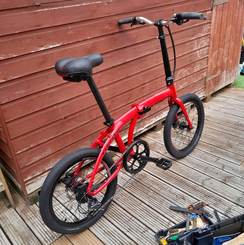

So another day in paradise, now I've proved that the motor works, it's time to strip all the electrics off the Carrera (bar the motor) and put them back on my Trek.
First thing I did was check the front disc which I used in haste yesterday from my box of bits and it was causing me problems. It is a Hayes disc, therefore the original from my Trek, which means it is 23 years old, I checked it out and it is out of true, also notice the wear marks, time for the scrap bin. So I fitted the original disc that came with the Carrera. All is now good in the front brake world.
Also, does anyone know where to obtain these oblong washers? Used on Hailong battery cradles, I can't find any anywhere.
So I fitted the Rust-O-Matic magnetic gadget which is how the two folded halves of the bike stay together. I smeared some grease on them.
I noticed that when it comes to removing the axle nuts on the front wheel, they undo pretty easily, even if I've done them up pretty tight. On closer inspection I noticed the flanges on the nuts were preventing the nut fitting inside the lips on the fork drop-outs (are these what they call 'Lawyers Lips'?) So I have fitted the nuts in reverse for now to solve the problem. But it looks shite and I can no longer use the rubber boots to cover the nuts so now I need some plain nuts as replacements. Any recommendations? I guess they are M12?
I said in an earlier post that the front drop-outs were nearly horizontal, that's not quite true, they are more like 45 degrees, I have tried to improve the drip loop (that cable tie is a temporary measure).
So now she waits, front motor attached, just waiting for my package from Top Bike Parts.
Edited to add: I also fitted my home-made label to try and keep Plod off my back.
