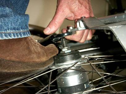

Upending a bike to fix a puncture is a bit infra-dig in some roadie circles - one should be able to remove the wheel with the bike upright.
Not so easy with a heavy ebike.
I have bar ends on the Rose, so can upend without damage.
But if it came to it, I might try to remove the rear wheel with the bike on its side, having first removed the nuts, disconnected the hub cable, removed the outer cable from the flimsy bit of metal it's attached to on the hub, and removed the chain tensioner.
Not that removing the rear wheel is a faff, you understand.
53,477
30,787
There's always this way which I use on the road if changing a tube, and I've even used it for fitting a thick Marathon Plus Tyre.
This one is an alloy frame, but you do it at your own risk!
