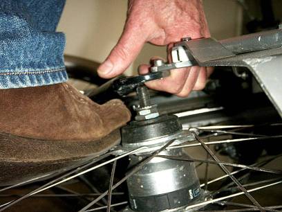

You don't need heat. You just need to go beyond the elastic limit. I had to go to about 220mm to settle at 155mm. Aluminium work hardens, so you can;t keep moving it without heat, but once will be OK.

User bastl-axel writes about the workflow of stretching a bike frame with heat:
"It's really just relaxing in the metal structure. But only 5mm expand, then heat until a large area and allow to cool, and so on and so forth, until the dimension is correct. Steel must be about 10 mm flare so that it remains 5 mm and the aluminum even 15-20 mm. Slowly ran keys. Gaining further bending always only once after cooling, relax and measure the threaded rod. With a 4 nut on the slack side, one can measure the old position of the bent dropout, where you turn this mother ran to the outside of the dropout slot. Because you really have to go back again in the final voltage phase to further bending and then turn only further apart. If you have too much bent, one can also easily turn the dropouts back together." http://www.pedelecforum.de/forum/index.php?threads/alu-hinterbau-aufweiten.27803/#post-401399
Deleted member 4366
I prefer my method. Lay the bike on its side; put a foot on the lower drop-out; grab hold of the other one and give a big heave-ho. Never mind the metal relaxing, you can relax with your beer afterwards while the theorists are still calculating.
I love these Germans, they're so technical. I made all my money by showing them how to throw away all their technical theories and do things in a simple practical way.

Similar to d8veh method for tube changes, perfect when on road to avoid getting mucky:
:D
You're right because you have experience. I am a cautious person and want to avoid a disaster...
