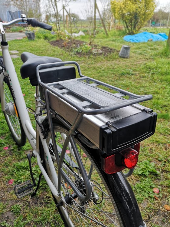

Hi All I started a thread entitled 'Software updates' but then took it off topic to discuss my other half's bike (half's or halves ). Looks like we've fallen into the oft fallen into mistake of buying second hand and ending up with a dodgy battery, well, lets say less than perfect. The bike is a supermarket (French) special, probably 10 years old, 250W front hub motor with a 24v 10hA battery. The main difficulty is that the battery start giving problems as soon as Jools start to climb a hill, and frankly she's really slow (not 'cos I'm so athletic, my Mecina cross 9 is!). I'm just about convinced that instead of a direct battery replacement, I go with a new 36v system (battery, controller, display and wiring) but retaining the motor, but which one? Bike battery , motor and motor connections shown below, I've only just taken notice of the info on the motor, I see it's a Bafang (they're OK aren't they) but it's a puny 180W, maybe I should look to replace that too? All thoughts/suggestion most appreciated Ian

Hi All Photos, Bike, battery connections and motor connections, again any and all help is so much appreciated. I reckon the bike is a pretty generic design , Chinese built and sold under many and varied names? Cheers Ian
