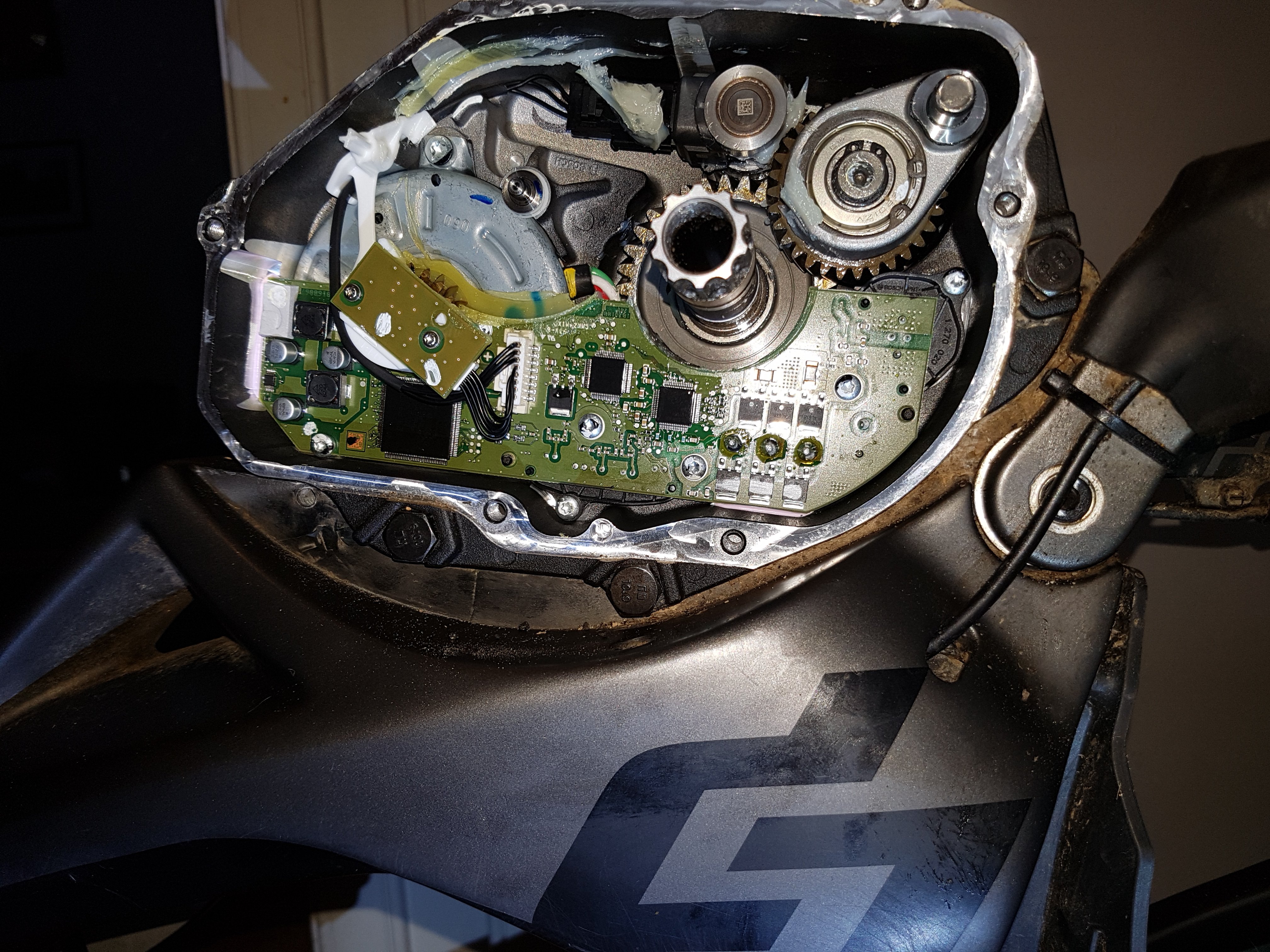

  18. On mine i did not add extra grease to the metal gears, the gears left in the motor seemed very clean. Where there was a dob of grease on one of the nylon gears and it was very tacky when rotating by hand. I did use silicone grease on the bearing, and when re-assembling the bearing seal. My motor rotates ok now, it is still stiff compared to a standard bike bb, but much better than before. It seems quieter with a longer range to boot. btw I did this because I had no other choice, I did not ask a bike shop. Although from what I have seen, Bosch are only interested in warranting motors as complete drive units and are not really supporting secondary market. Knowing what I know now I would not buy another Bosch either new or second hand. My experience of buying bits of manual bikes on ebay and building them up doesn't fit with ebikes. Despite the massive costs they seem to be disposable if they go wrong, hardly environmentally friendly.

  21. Open case, I was surprised how clean it looked inside, it is very well sealed. I use my bike on very wet and muddy Dartmoor. Bike is upsidedown, I did consider putting on its side for when I pulled the driveside cover away, but carried on ok as it is.
  22. I just replaced my drive side bearing on cX motor. It is straight forward enough, just requires a bit of tapperty--tap-tap-tap. I used enduro bearings and you in addition to normal bike tools you need the Bosch chain ring tool. 1) remove battery (do not risk motor starting with fingers in it). 2) clean bike 3) take off pedals (crank puller needs octalink insert) 4) optional remove chain (I gave mine a clean and oil). Quick links are useful. 5) Use Bosch chain ring tool to remove chain ring screw cover. Chain ring comes off. 6) remove plastic covers from motor. 7) remove circlip from driveside axle. 8) prise off ring and plastic grease cover if fitted to drive side axle. 9) clean all dirt off aluminium motor 10) optional remove motor discount cables. I did not do this. 11) pick the glue out of torx bolt heads, drive side. 12) undo torx bolts 13) prise open motor gently. 14) the cover will come off probably with white plastic gears attached. 15) lift white satellite gear off. 16) pull main gear out of axle shaft reveals roller bearings (pictured below) 17) you should only have drive side cover and bearing. Tap it out. 18) clean grease, tap new bearing in, I used old bearing to tap home. 19) clean plastic gears if dirty. 20) reassembly the plastic gears they slide together nicely. 21) reassemble to motor body, line up gently and feel gears slide home. 22) put it all back together. My bike is second hand so no choice. Unlike new enduro bearings, the old bearing is only sealed on one side. Do this at your own risk invalidate warranty etc etc.
