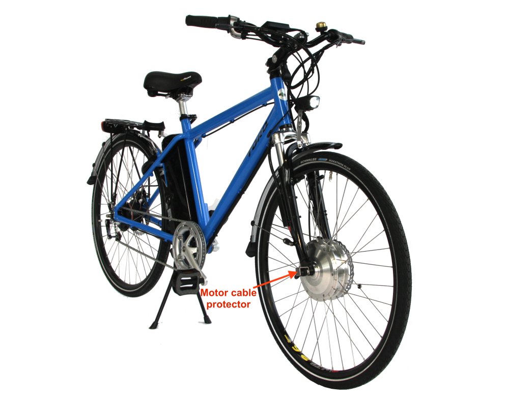

a second hand bike makes sense. You soon save enough money to buy a better bike next time. Don't bother buying a new battery for it though. Most ready built bikes are optimized, upgrades are uneconomical. If the woosh predictor recommends the zephyr-CDN, it's because you have serious hills in your area, buy a second hand bike with the biggest 36V motor. Kits aren't cheaper than ready builts from woosh, without previous experience, you run a risk of not achieving your goal.
If you can't find any suitable second hand, ask Hatti @ woosh for a Mono. These used to be sold for £399 and they are good on hills. They are no longer sold on the woosh website but I think they still got one, she probably can give you a good deal.
http://wooshbikes.co.uk/mono.html
http://wooshbikes.co.uk/mono/dimension-mono.jpg
