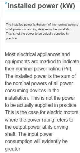

Firstly, in this context a motor does not provide a wattage, it consumes it. In nearly all pedelecs the power (watts) is controlled by the voltage (battery) and current (controller).
The rating of that motor is about how much power it can consume before it fails.
You can debate 'nominal' all you like, but that's irrelevant. 'Rated' is the important bit.

I understand all that, but you are missing the fact that it's about motor rating. Just for clarity I will say it once more. Motor rating.
Not motor output.

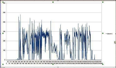

Try as I might ( well try as bike might) my worst current drain has been 268 w/h..(over 30 mins) Which is about what you,d expect for a legal pedelec with nominal output of 250w..

I,m talking about LEGAL pedelecs. Yes the motor is capable of drawing more than 250w. Yes its capable of providing more than 250 w...but with a LEGAL pedelec I,m finding it impossible to put it in a situation to do either.
Folk keep saying they have bikes capable of delivering 600 w etc...( yes yours might be, not disputing that) but the bikes system with 15.5 mph cut off, high cadence low torque cut off, its almost impossible to put bike into a situation to draw over about 250w..
Yes I could keep my graphic high by abusing both bike and my legs.( ie falsely high gear, low cadence lowish speed) but moment I pedal " normally" ( correctly) current draw diminishes below the legal limit..
If folk know of a way to draw more than 250w ( without dongle mod) please tell..I don't think its possible on my yam haibike.
