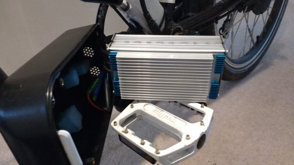

I added some small heatsinks. Unfortunately the larger heatsink in the photos wouldn't fit in the case! D'oh! Oh well, the tiny ones that are left will help for now. More are on order.
I then vented the case, with one vent at the front protruding slightly to stop rain flowing into the hole and two at the bottom.
The controller was just loose and audibly bouncing around so I added some sponge to make it more secure.

The extra heatsinks arrived today so I soldered the shunt a bit more. Looking forward to testing that later!
