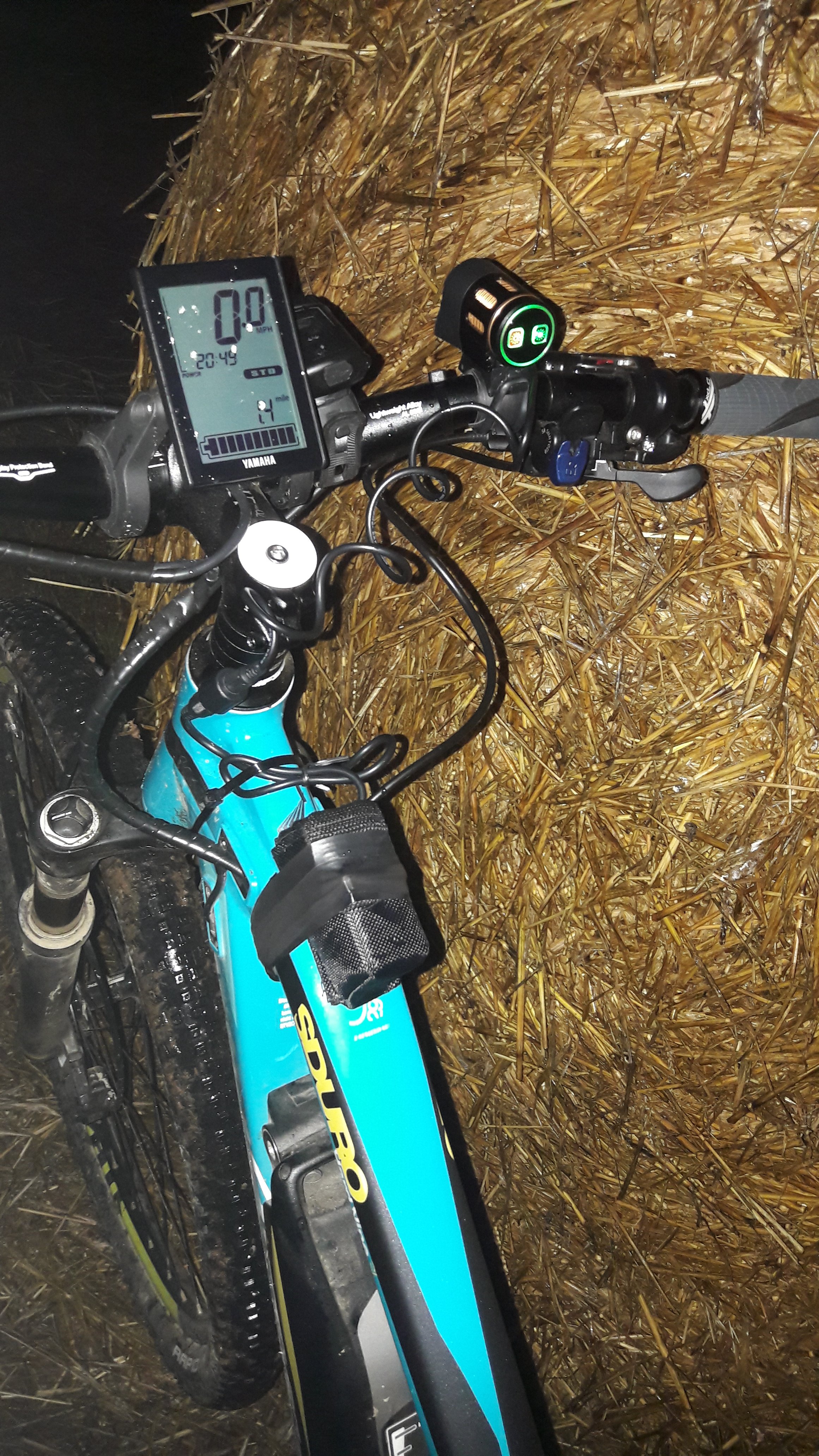

Battery pack fits well on the frame.
Only slight difficulty is Haibike handle bars are not designed for forward facing lights or anything come to that.
Charger and batteries all seems as you would hope for so fingers crossed, the kit for £16 is great value.
http://www.ebay.co.uk/itm/131597662531?_trksid=p2060353.m1438.l2649&var=430968950331&ssPageName=STRK:MEBIDX:IT
Will this fit sDuro as it would be a better option and will look straight forward?

Thanks for the photos to confirm the fitting. Yes it will fit mine as well and I can set it up like yours and it will make a good bracket.
