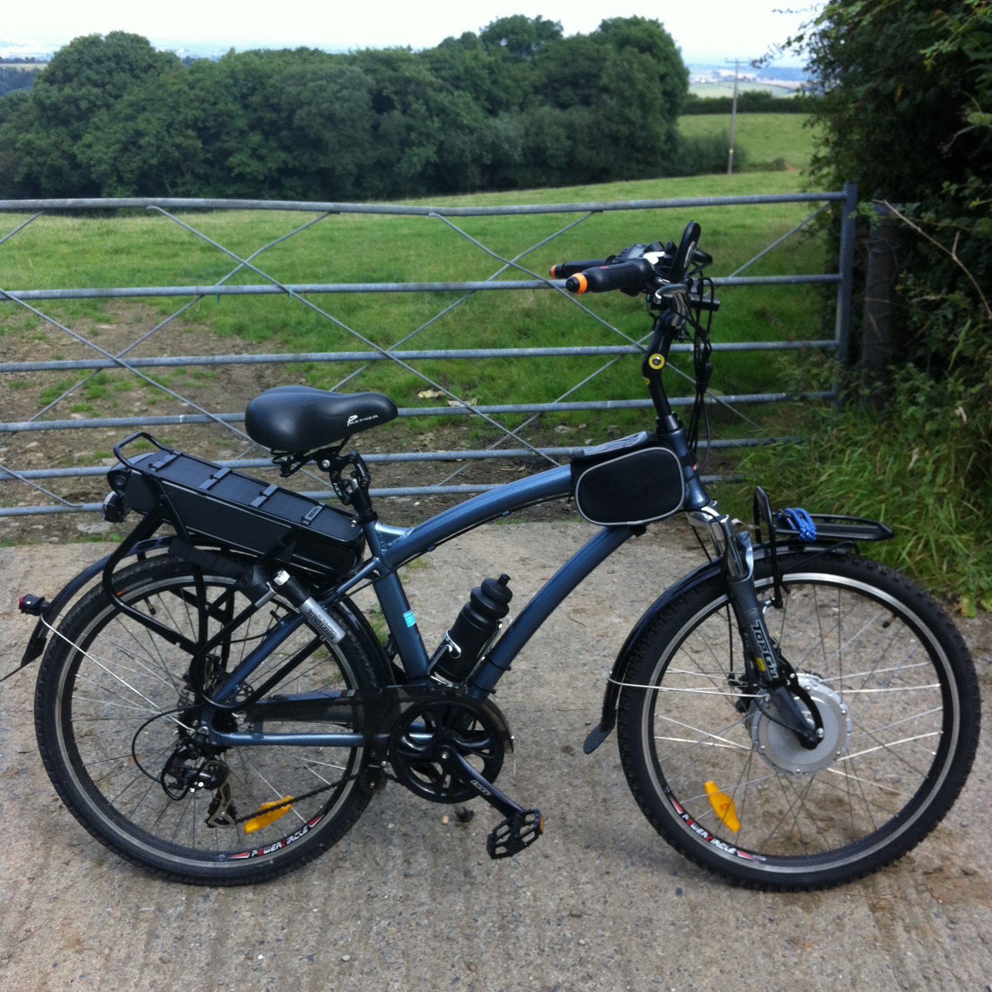

Before seeing your post d8veh i have this morning been moving the battery forward. The battery is right forward now, up to the seatpost and at an angle so all the weight is in front of the rear axle. Loooks a bit strange but if it works! Trials this afternoon.

The battery could be moved even further forward by cutting the rack about a bit and bolting it to the crossbar. Flat and vertical. What do you think?

The more weight you can get on to the driving wheel the better. Do you know the actual angle and length of the steep part? You could set the bike up at the same angle with the front wheel on bathroom scales and measure the difference various mods make, then stick the scale under the rear wheel and see how much more grip you could have.
I know this may only help the tiniest amount, but you could try moving the seat forward along the rails, so there's more weight forward of the seat tube.

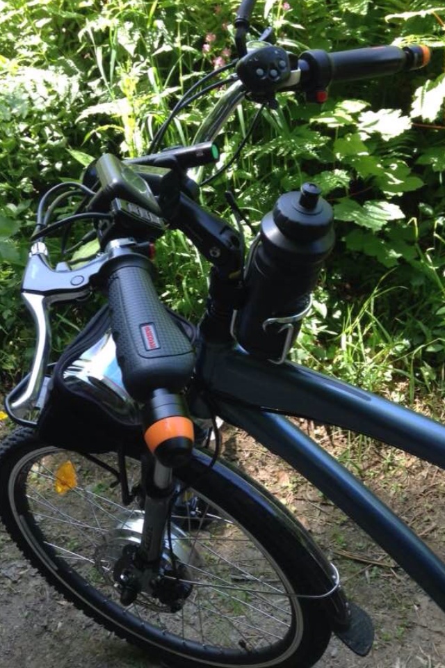

image.thumb.jpg.f275d85ebd1237c794d124425773d32b.jpg Moved battery forward as much as possible. Added a crossbar bag with some lead knitting machine weights in it. Added a heavy D-Lock. Been for a long hilly ride. What a difference it's made, no spin on the dry surface. I'm sure it's going to be better on a damp surface too. Thanks for all your responses on this thread. Very happy.

My Big Bear is as quiet as a mouse.... I hate waitng for that next clunk going over those bumps. Firstly, i obviously moved and tightened anything loose. Removed my back pannier bags, they make a right din. The only thing left making a noise was chain slap. Chain tensioners are expensive but i found a cheap one called Brand X. Although it is excellent quality it gets poor reviews. Mainly due to fit and noisy. I overcome the noisy chattering of Brand X by fitting a nylon washer on the swivel joint. Perfect and my BB is absolutely silent on the biggest of bumps. See my photo above.

[ATTACH=full]15152[/ATTACH] Moved battery forward as much as possible. Added a crossbar bag with some lead knitting machine weights in it. Added a heavy D-Lock. Been for a long hilly ride. What a difference it's made, no spin on the dry surface. I'm sure it's going to be better on a damp surface too. Thanks for all your responses on this thread. Very happy.
PS. I am going to position the handlebars more forward tomorrow.
Having the handlebars that high won't be helping.
In general, an upright riding position would have the bars level or a few inches higher than the saddle.
Safety is another consideration, I doubt the stem is designed to work at that angle - there may be some markings on it indicating its range.
Nothing may go wrong in steady road use, but on t'other hand the steering is the last thing you want to take a chance on.
I think your biggest problem is the handlebar position. If you correct that you can lose all the lead weights.
I shall put them back to my normal position tomorrow. Centre point directly above front axle.image.thumb.jpg.81fa065f7a577d8325ed2a95e0f39f7b.jpg

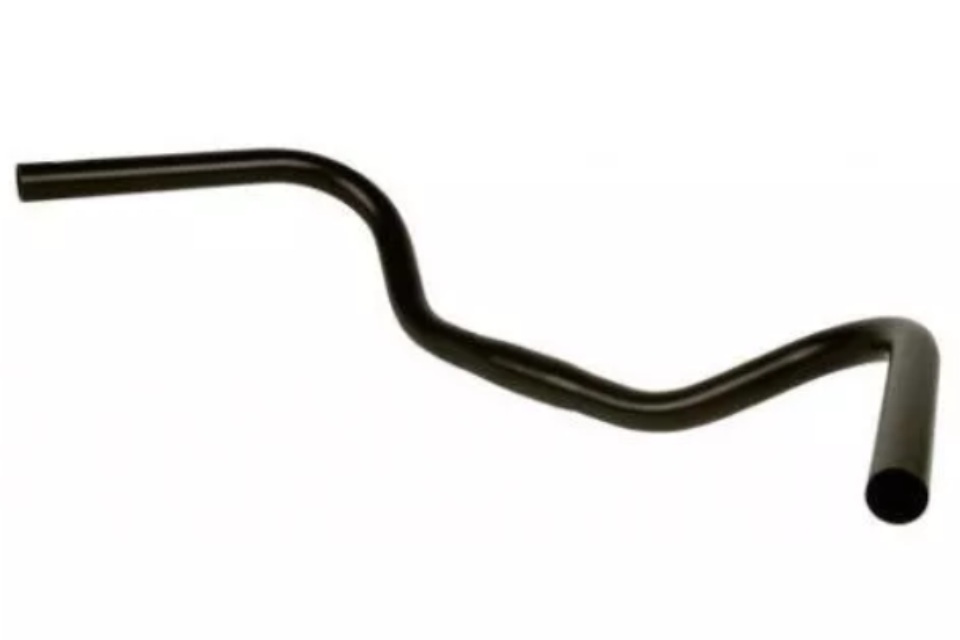

I am thinking about ordering these. Very similar to ones fitted to Big Bear LSimage.jpg.ab1971eb128e5e5241218021c698809f.jpg
